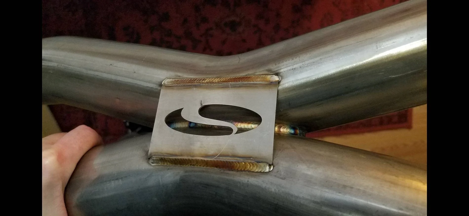

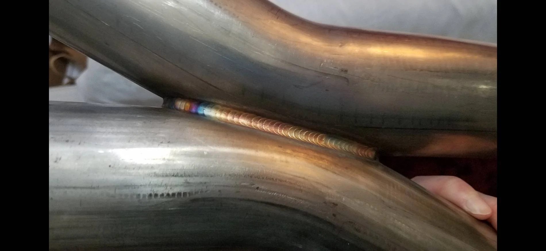

I'm running the steeda x. Sounds so good with the factory active exhaust. Some shots of the welds. Dimes...

Steeda X on a 22 Mach 1 w/ active. Quite mode is quieter than stock which I like for starts in the AM. Otherwise the X sounds incredible to me. I have only praise for the welds and ease of installation.
