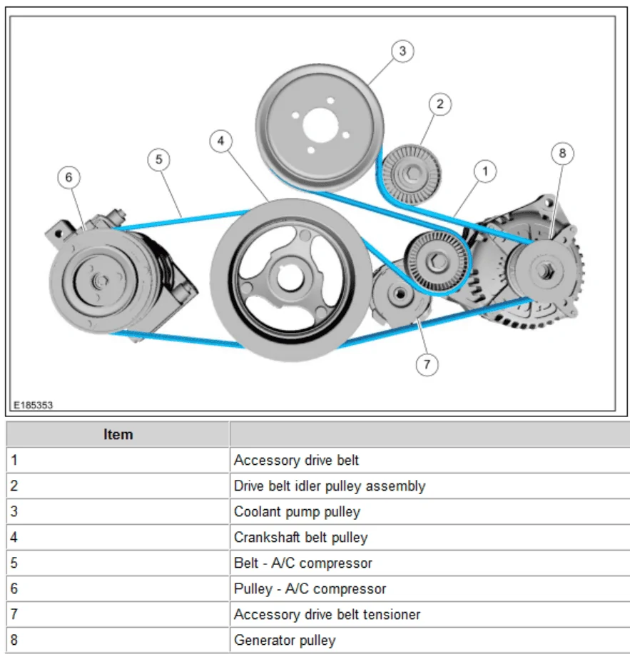

Sorry! For some reason I had the impression the noise was on the pax side, but if it's driver's side, then it's either the idler pulley, the belt tensioner or the alternator. That's what the sound reminds me of - my daughter's Focus just had the tensioner replaced for just that kind of sound.
Here's the belt path, with the candidates being 2, 7 or 8:

I have an easy way for you to check this out. Get yourself a 15 mm socket and take the belt off . All you have to do to get the belt off is release tension on the tensioner with a breaker bar and a 15 mm socket. once you take the belt off start the car up and see if the noise is still going on . The oil pump would be turning but the alternator wouldn't. On the 5.0, the air conditioning belt is a separate belt. So it's easy just to take your big serpentine off and then start the car up and see what happens.

My vote is for the idler. If you take the belt off you can just turn them to find out which one it is. A bad bearing should be notchy when turned.
Also before you take the belt off turn the A/C on and off to see if it has any effect on the noise.
