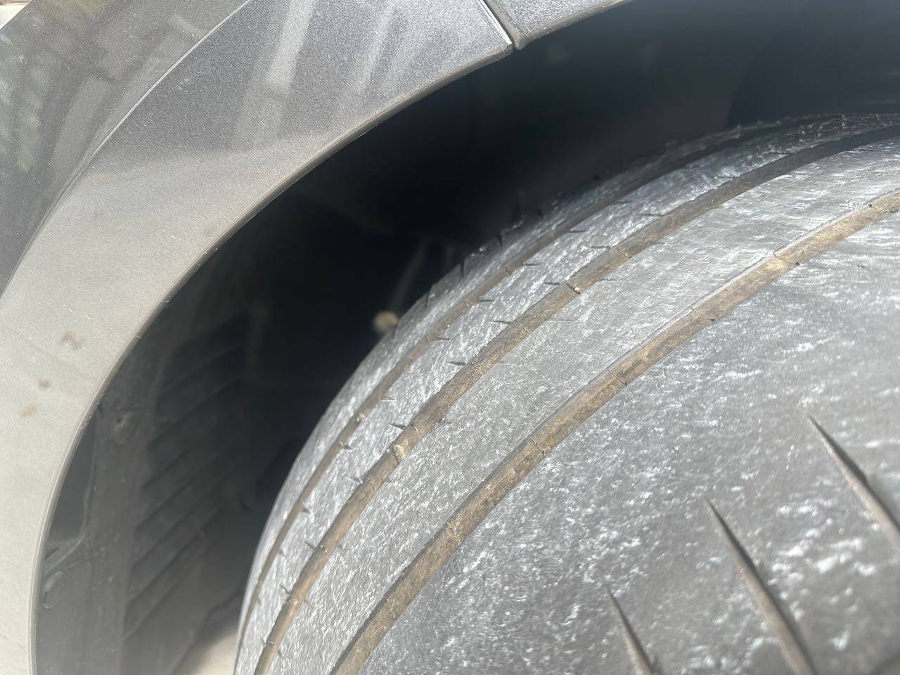

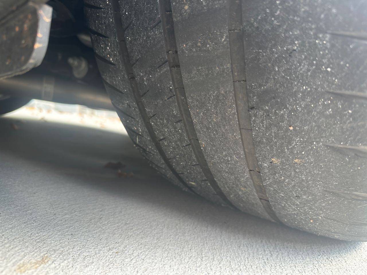

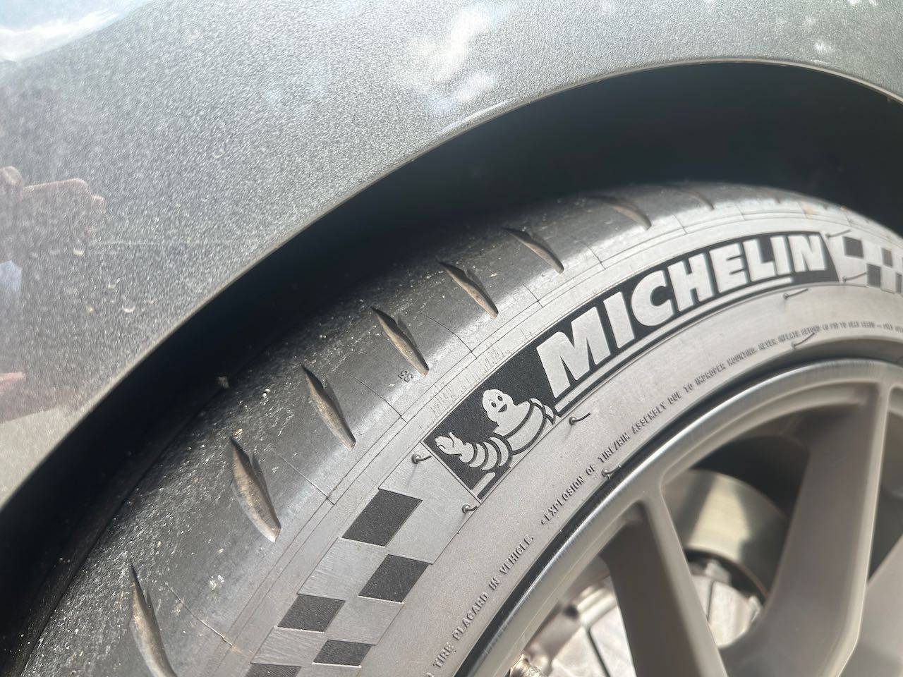

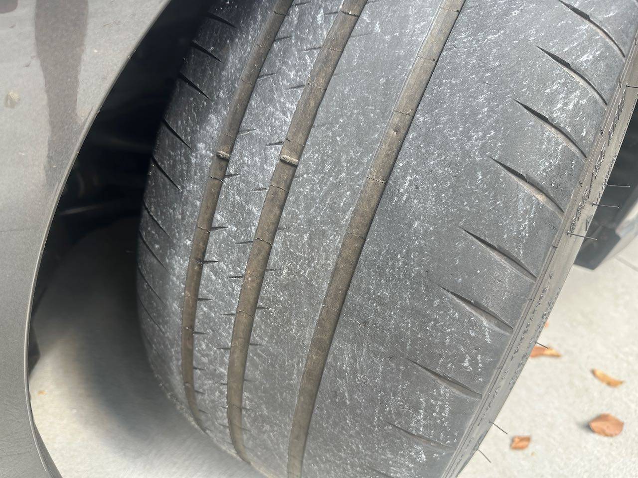

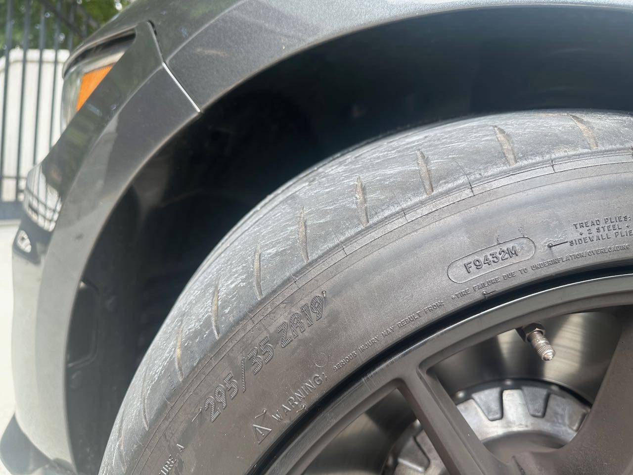

@matthewr87 Thanks for the reply. Here are some pics of tires. I just don't know whether to run these, and wear them out for 2 days, or put a brand new set on now? Makes more sense to me to run these and wear them out, but I'm not sure how worn these are. Again, 5,000 miles of light street and highway driving.

I'd run them on the track to wear them out but keep an eye on them during the day to make sure they are not wearing odd or faster than you think. even near the end of the life these should still be pretty good, obviously not as sticky as fresh boots but better than most tyres out there.
I'm not sure if the rubber compound changes on there when you get down to the wear indicators. I have had tyres that absolutely went to a harder compound when they were almost done so you didn't suddenly find yourself exposing cords and risking a blowout.

Those tires have plenty of meat on them, the only caveat, as mentioned, is the expected weather. As long as dry and over 40*, I'd think they're good. OEM pads are also quite good even for very aggressive track use on street tires. I agree that you should flush the brake fluid - I use Motul RBF600.

Tires have plenty of life left. You should be good to go. Have fun!

OK, Stock brake fluid is fine(I have beat the crap out of the car) . I would be more inclined to change it due to time. I use the stock fluid for a long while and the fluid and the pads work great. Tires look good but get some negative camber in the car
