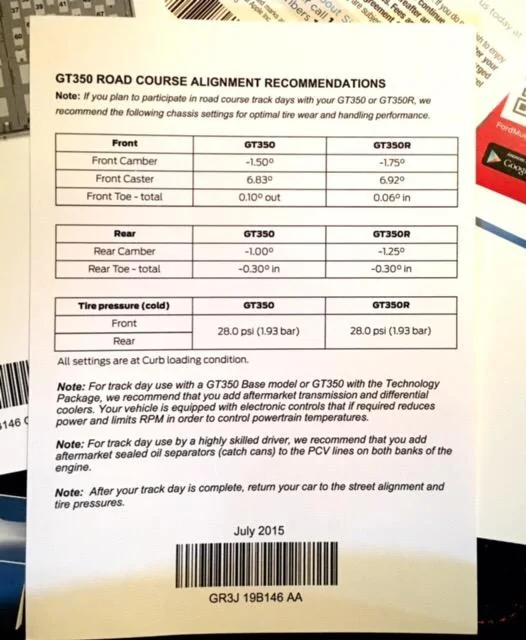

There is a lot of discussion that when using stock componentry the front cannot be adjusted to meet FP recommended alignments for the track.
Question is how about the rear? Do we need anything additional to get the rear to meet FP track alignment recommendations?

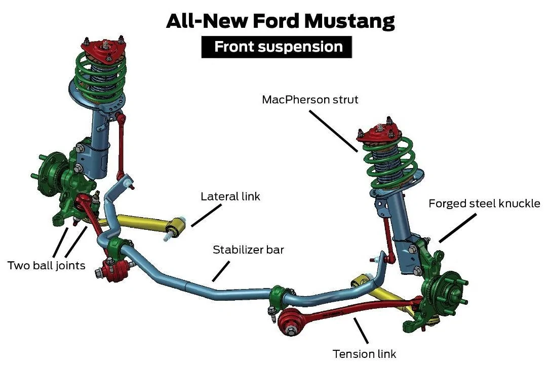

I've chocagoed the strut bolts for a friend and he was able to get 2.4* camber adjustment.
According to a user on another forum there is enough adjustability in the rear to achieve FP recommendations...Once my bolts get here I am swapping the installed ones for the BMR bolts and then I will have my machinist cut the OEM ordered bolts and off to the alignment shop I go!!!!
