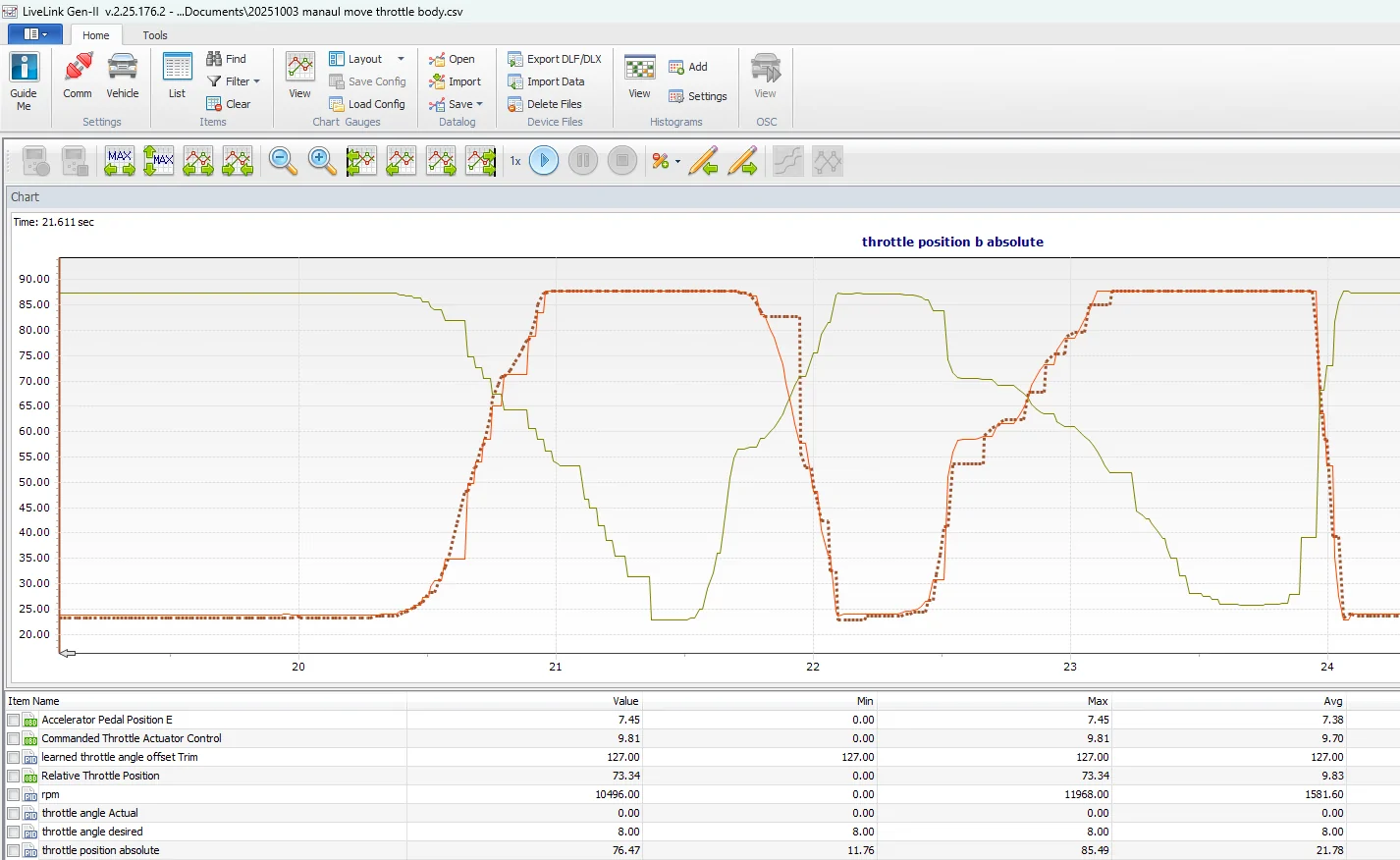

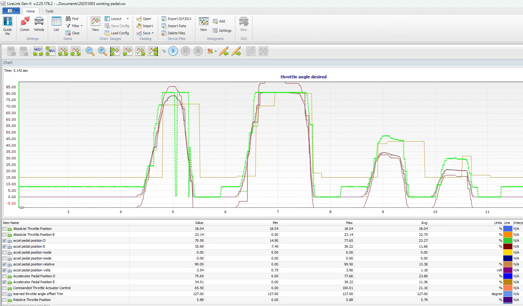

The codes you gave make it also seem like a wiring or sensor issue. Have you tested the pedal and checked all your wiring? There is a reason why I have a spare pedal in my garage...
First step is get a scan tool or do a datalog and check the pedal and TB for proper operation.
Then datalog the car when it stalls and look for things that stand out.
We have tried some data logging but wasn't sure what parameters to log. We assumed that the tuner would have done this as it is what we paid them to do but apparently not.
