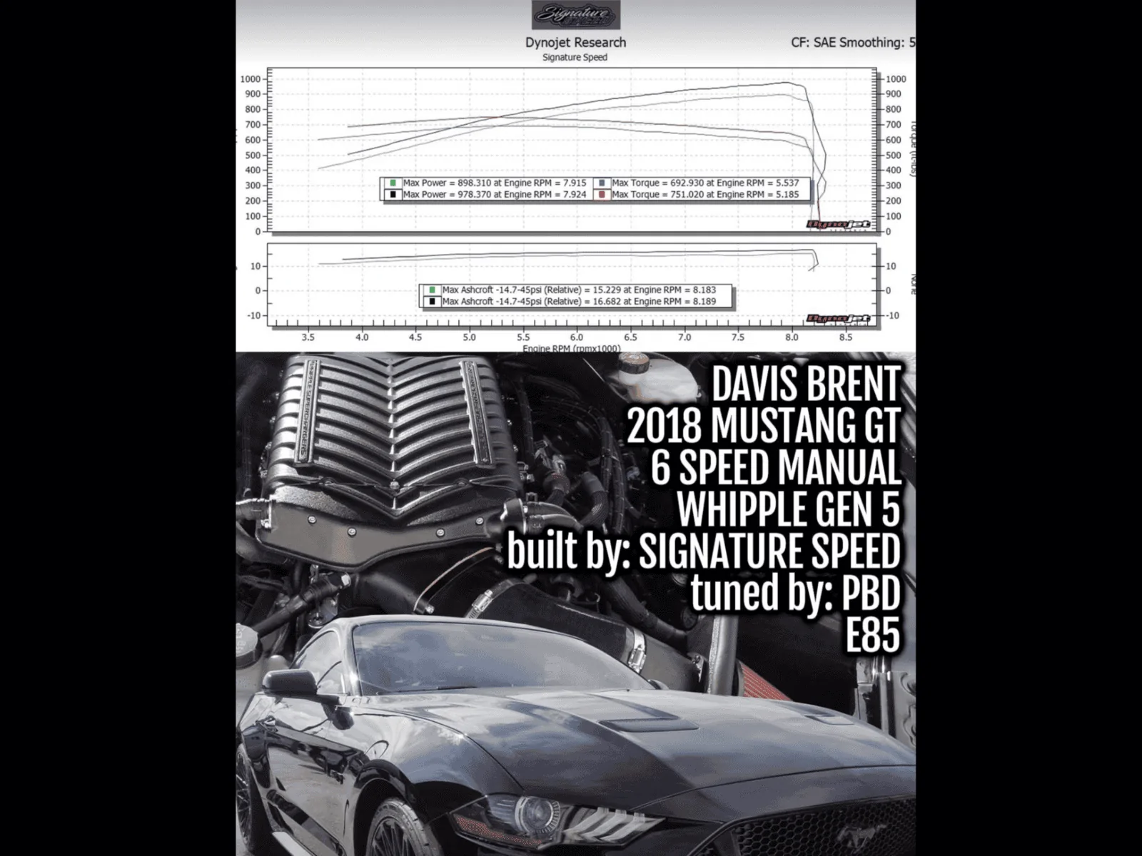

Brent Davis
Dec 24, 2015
27
449
192
Northern Virginia
2018 Shadow Black Premium Mustang GT
I chose the Whipple over anything else with a manual because of the instant hit off the throttle. I went Mac daddy on upgrades though with the 10 rib kit, $2500 Fore fuel system, ID1050X injectors, 3.625” pulley, 20% OD crank pulley, oversized HE, full MBRP exhaust system with their high flow cats, PBD tune and Signature Speed doing the entire install with OPG/CG. The trans is holding fine for now. I am hoping Bill Calimer will make the billet gears for the new ‘18 gear ratios otherwise I am still on the stock trans and clutch. It made the 978 rwhp with the 3.625” pulley and made the 898 on the 3.75” pulley. I suspect the 4” pulley would make 750 rwhp. Good luck with your decision.
Thanks for posting! You have a pretty sick build!
