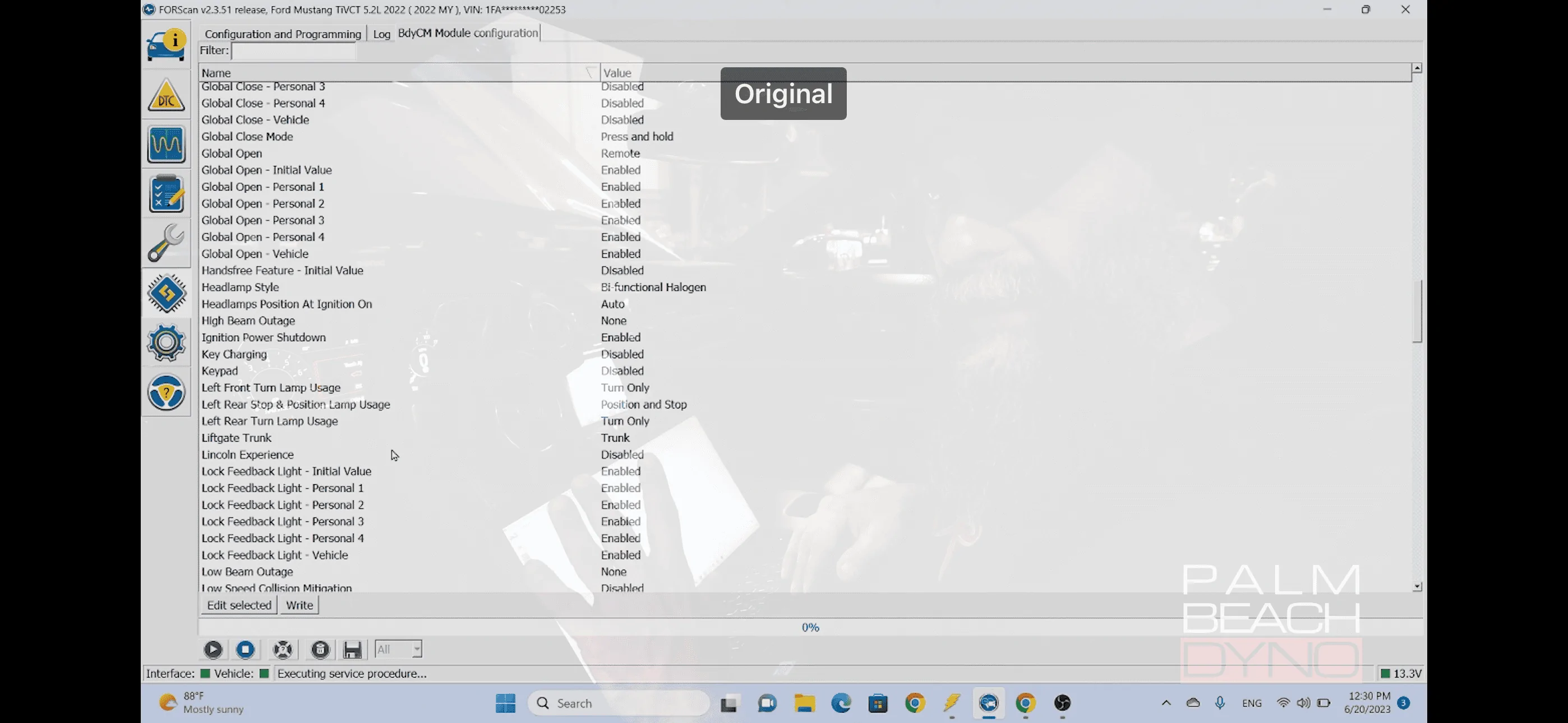

Instead of going in the AS BUILT click the other option. This is the new setup it is more of an enable and disable style and has a ton of stuff.. take a peek and see if you can enable it through here instead of doing spreadsheet style.
aidangf
New Member
Mar 3, 2024
Los Angeles
2022 mustang gt
Found it, thanks!
