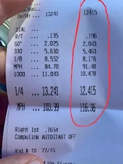

Drag mode and in Drive, Orlando Speed World. 2nd run traction control kicked in around the 330' mark, still ran 116 trap speed. Didn't realize traction control is only disabled in Track mode but not Drag mode.
Get the 60' times in the 1.8's and you will have good numbers.

Would unplugging the ABS connector by the airbox solve the issue on the 2nd pass?

Good first outing MPH wise. I think I saw your car yesterday driving past winter garden on 429? I live in WG...

Not I, never left Viera. Hoping to get back to the track before the heat comes back and try again.

Good run man. My best is a 12.48 at 116.55 with a 2.0x '60, so it's really cool to see how consistent these cars are.
NO... that takes away track apps AND Drag Mode on 18's and 19's.It will register as in mode but it disables it. So DON'T lol
It's not truly disabled in any mode unless you hold the tc toggle for 5 seconds or so and it says "advance track off".

That sucks the plug kills the drag mode for you 301a up cars. Base GT’s with a “tuned” drag mode can run no problem unplugged.

Mine has a tendency to turn trac ctrl back on during a run even after turning off advc trac for 6 seconds, during the run bam it turns back on and cuts power during shifts. If you can keep that sucker off you can expect a better ET, my best with a clean run is 12.0. This year I'm tuned for 93 with a Steeda Closed CAI, and the tune keeps advanced trac off until you turn the car off or turn advanced trac back on yourself.
