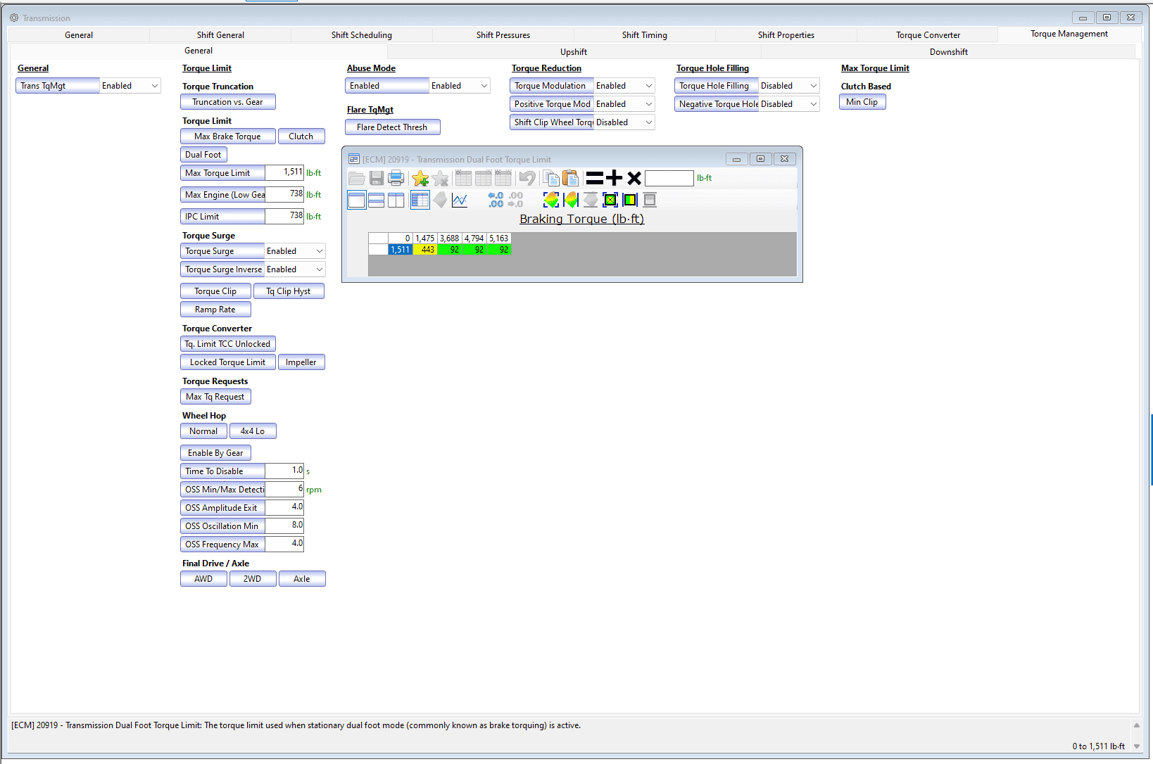

First off, you dont need to lower the pressure at all in a stock car. Just run them at 30 and do a short burnout to first smoke. Then DONT foot brake it past like 500rpm because the stock tune has a dual foot table where the car will severely limit tq as RPMs go up when you are on both the gas and brake.

What???? Can you tell me more about this table? I've been wondering how the hell people are getting 1.8, 1.9 60's leaving off idle
This explains alot

Here is the dual foot table from HPT from my 22GT. My values were changed, so I believe the OEM calibration values are much lower. This was my base tune from my tuner at the time. I know he had changed lots of tq management in the tune.

I had no effing clue this was a thing. Thanks for the info. So basically until I get a tune, I have to leave off idle. right?

I wouldnt. Idle is quite the snap to the driveline. I'd lean on it to say 1k maybe a tad more. Just to load up the driveline so its not such a shock through the converter. I always had my best short times at that 1400ish RPM. Since I got tuned, my car likes as much as I can give it before I push through the brakes. Which is usually 2k ish. Here's the last pass I made on E only before I went whipple. Also at BMP in bradenton.

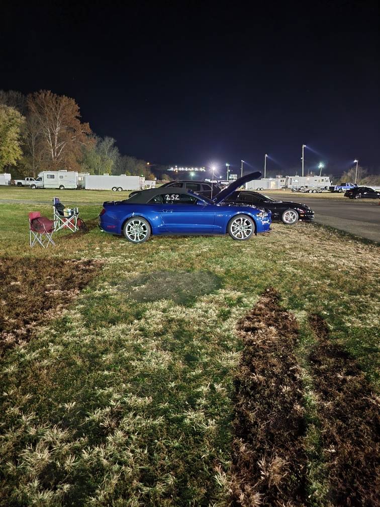

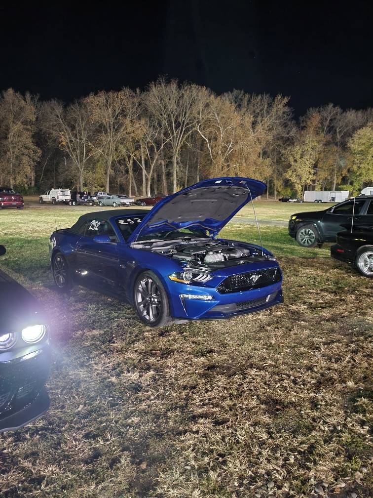

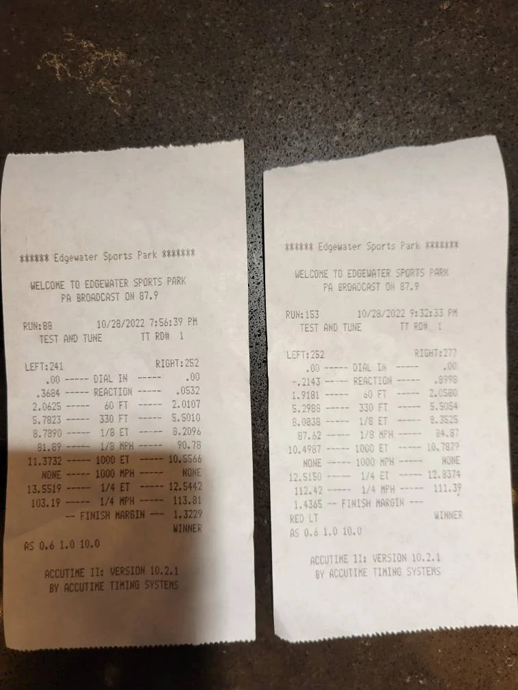

Man I don’t know about listening to all the experts here. I took my wife’s off the showroom floor 22 Premium Convertible GT with an air filter on 20” Goodyears got a 1.91 (if I could of got another pass I’m sure I could of have got a 1.8x).
I had 22psi and launched as hard as I could before pushing through.
Be careful throwing money at you car and getting poor results. Here is a housewife’s stock Sunday convertible out 60’ your stripper coupe with mods and making a couple quicker passes- something we both know should not happen.
