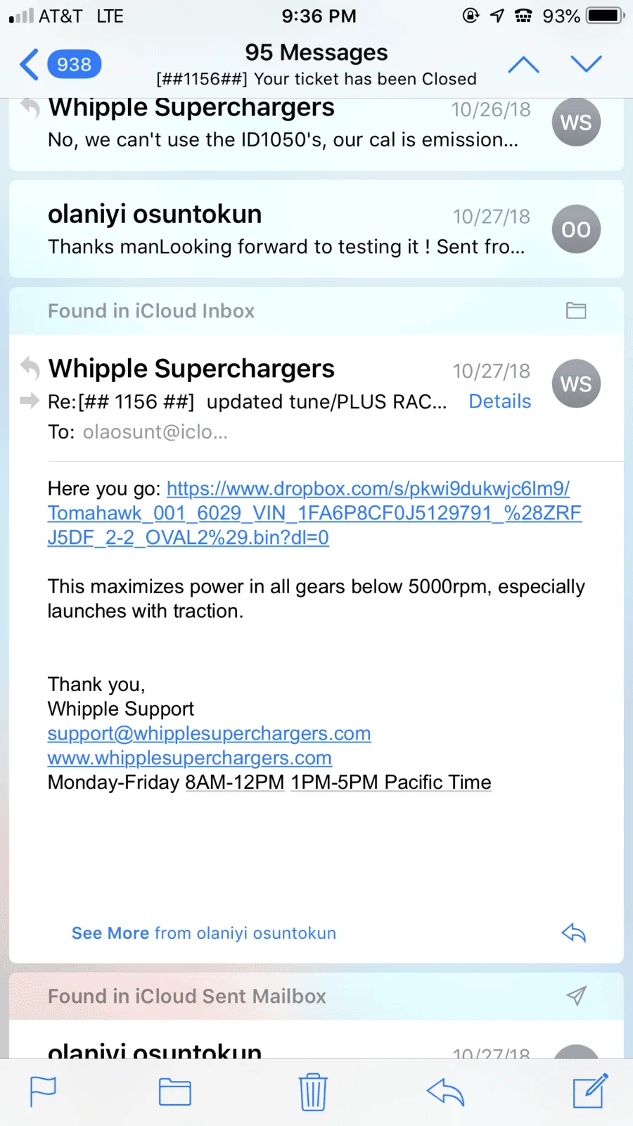

Mine is 2-2 and I received it 10/26. Sounds like you have the latest in hand. I hear this one is good for 9’s with no other mods except tires.
Really ? Shoot. I wish I had been a little patient .
I went 10.2@138 running a 3.625 pulley with the 2-0 version on 10/21.
The last update (2-2) I got was on 10/27 but I had already installed the ID1050’s and started logging the PBD tune so never tried it (all the tracks were closed at the end of October anyway ).

I started off with the full stage 2 kit . I swapped the 3.875 for a 3.625 pulley and went 10.2@ 138 with the whipple 2-0 revision tune (2-3 is the latest revision ) .
Tracks had closed by the time I got the 2-2 update.
