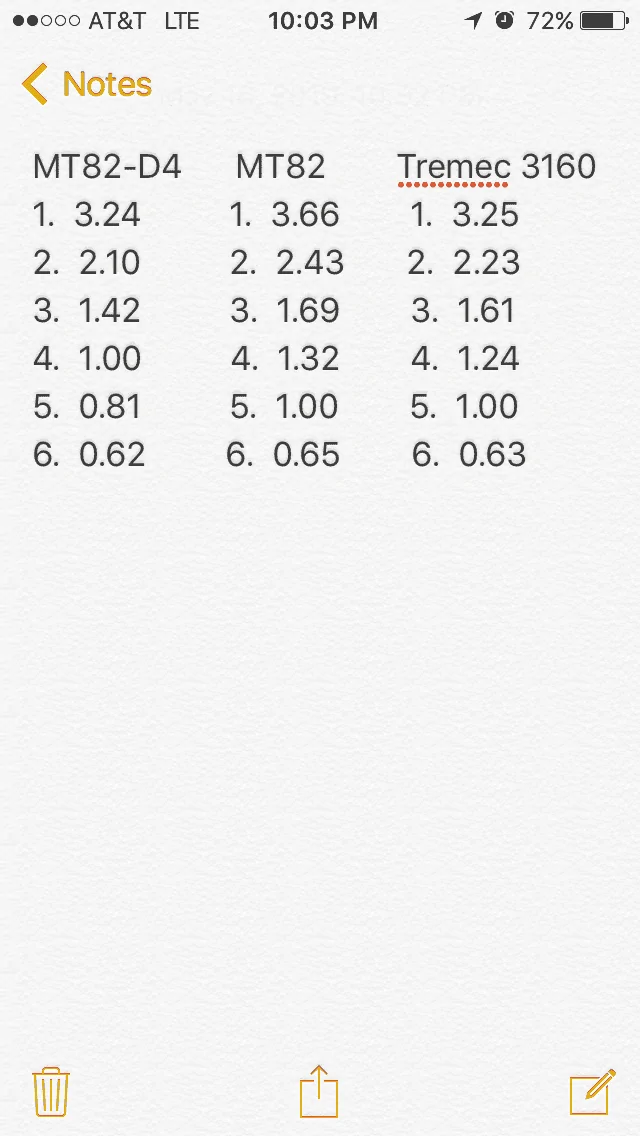

Its all about the MT82-D4 Gearbox.
The D4 is direct in 4th. The pre-2018 had direct in 5th.
This is why all the reviews complain about the over-tall, extra-long, gear ratios, and the reason it (the MY18+), is no faster than the old model.
The Auto box on the other hand, is substantially faster, due to the ten-speed always having the engine in its perfect rev's, power-band for max acceleration.
The diff ration for the Auto in the States is 1:3.55. The manual in the performance pack is a Torsen 1:3.77.
All export RHD drives come with the 3.55 diff, so the manual D4 gearbox is hobbled again.
I guess the only way to improve your manual car acceleration, would be to change the diff out to the spec of the Yankee cars.

Because Ford made a decision to favor the A10 hard and hamper the manual cars with a garbage transmission ratio set with the D4. Even with 3.73 rear axle gears it does not feel nearly as strong as it is, or even stronger than the previous gen. I've already seen a couple of 2018 GT swaps to the Gen 2 MT82 with rave reviews on road and track, and I've also seen at least one with the D4 go to a 4.09 rear axle gear set just to get the final drives where they should be.
Because of all this, it's my opinion that if one wants a manual S550, get a 2015-2017. If you would consider the auto, the 10R80 is worth the goofy price of admission (front fascia).
