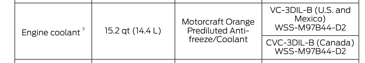

Hey y’all,
noticed my coolant is just a little low and cannot seem to find anything on what kind of coolant i should use. it’s fords red coolant but i can’t find a part number or anything of the sort for it. any help is greatly appreciated!

thanks! i’ll go pick some up now.

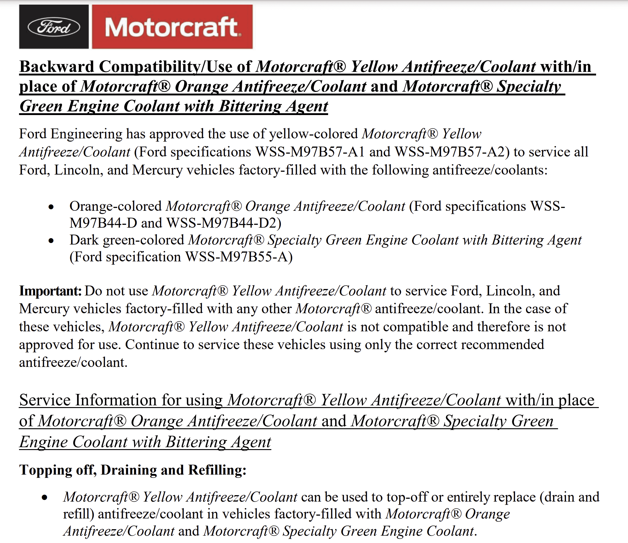

Or just get Amsoil that meets WSS 97B44-D and be done with all the color mumbojumbo.
