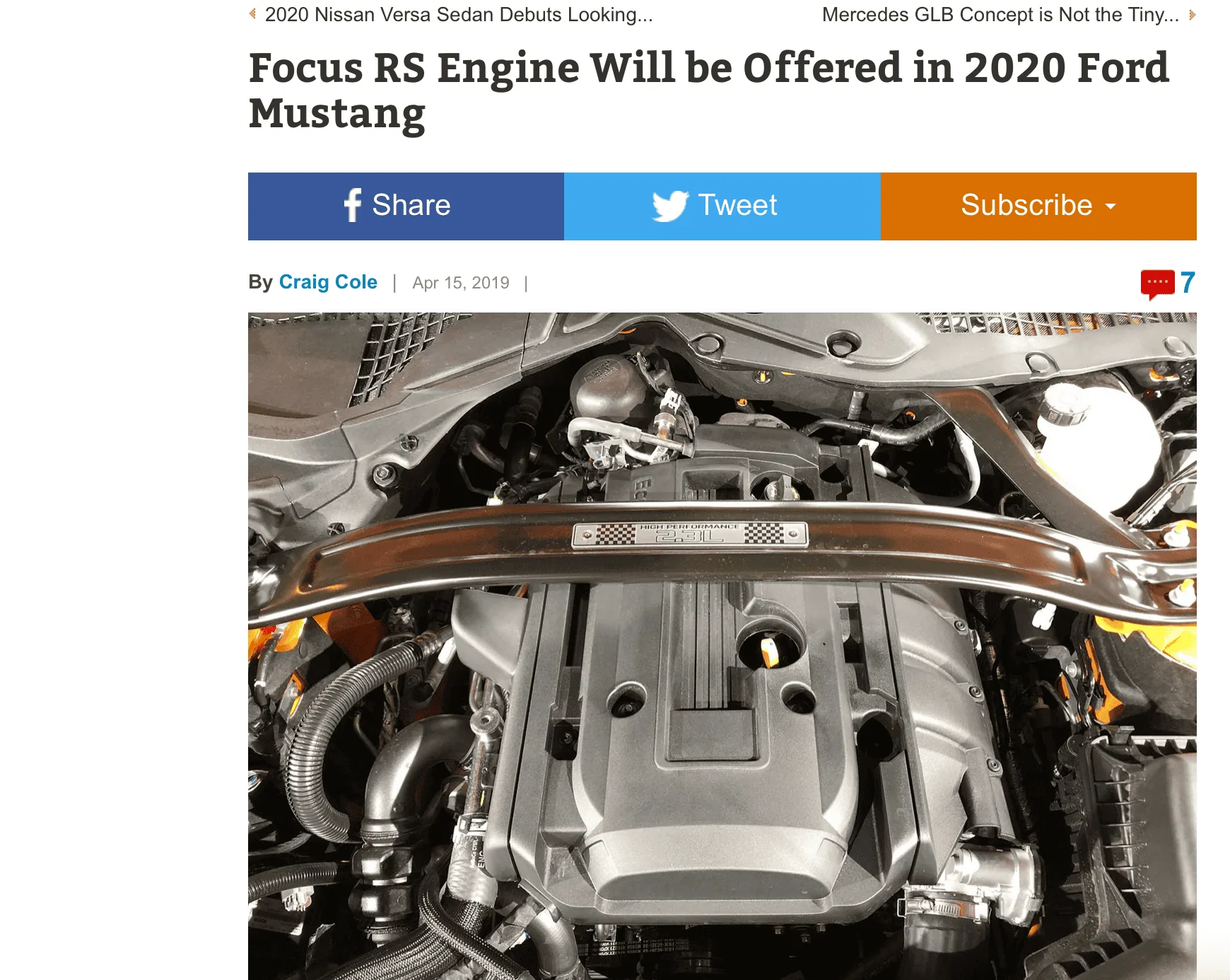

I was under impression its the same black as the focus RS, just turned and shoved into our engine bay.
This was a rumor that the RS block was somehow different, the 2.3 ecoboost uses the same block design/materials across Fords lineup. The motor in our cars still has the mounting points to be put in a FWD car.
The differences between the RS/HPP and a standard eco mustang are:
53mm compressor wheel vs 50mm
Slightly more aggressive cams
better intercooler
different tune
Other than that the motors are identical, the blocks are still the weak point and no 2.3 eco has a block that is superior to the others.
