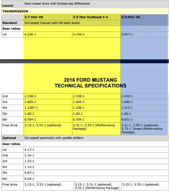

I'm a bit fuzzy on that, is the MT-82 in the EB the same gearing as in the GT?
They're not exactly the same but the gearing on the smaller motors does them no favors. There is no reason why I should be at 2000rpm in 6th gear cruising at highway speeds, the car literally can't make it up a hill without getting deep into boost which is not a good thing at such low RPM.
I also observe better gas mileage by a good chunk running in 5th at 70 vs 6th.
