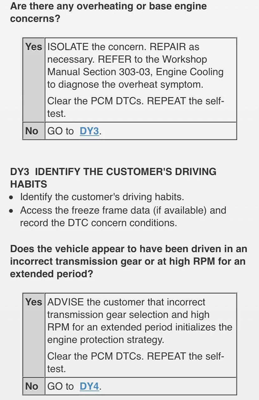

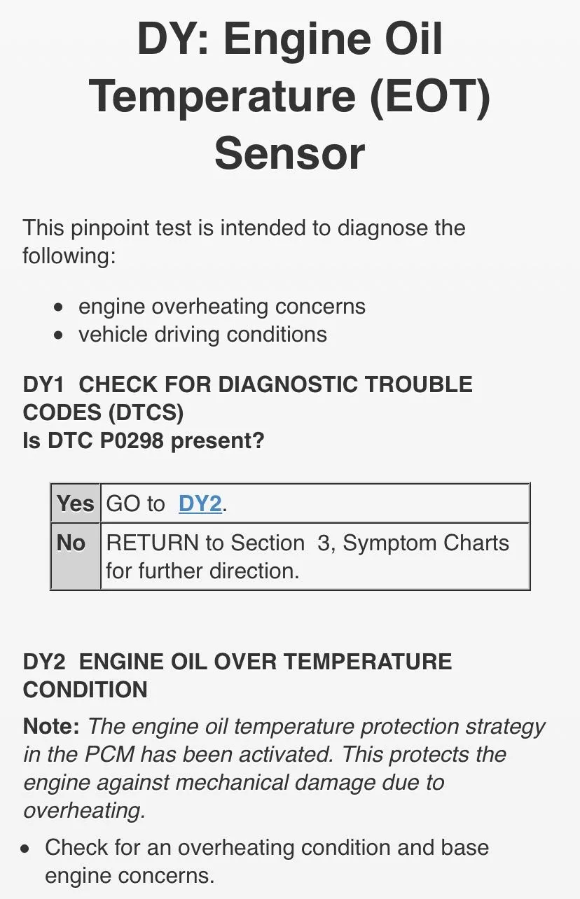

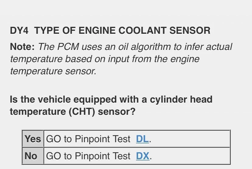

Here’s some info about the EOT sensor which may relate to your concern:
PINPONT TEST DL = Cylinder Head Temp Sensor (CHT)
PINPOINT TEST DX = Engine Coolant Temp Sensor (ECT)
Pay close attention to DY3 in the above docs - Customer’s Driving Habits. It states there:
incorrect transmission gear selection and high RPM for an extended period initializes the engine protection strategy.
Now there’s no definition of “extended period” relating to how long or short that would be defined as for the sensor to activate its strategy (illumination of light in cluster).
It’s very possible you have a faulty sensor OR that the programmed parameters kicked in as it should to protect the engine.
Can you give more info as to your actual runs? What was outside temps at the time? Do you know what your CHT was at the time before or after the runs?
This would explain why you did not experience any EOT illumination on your drive home - because the car was being operated within normal conditions.
I was tacked up in sport mode about to hit it on the 3rd honk. Was prob tacked up maybe 4k rpms for about 5 seconds as soon as I hit it car went into limp mode..

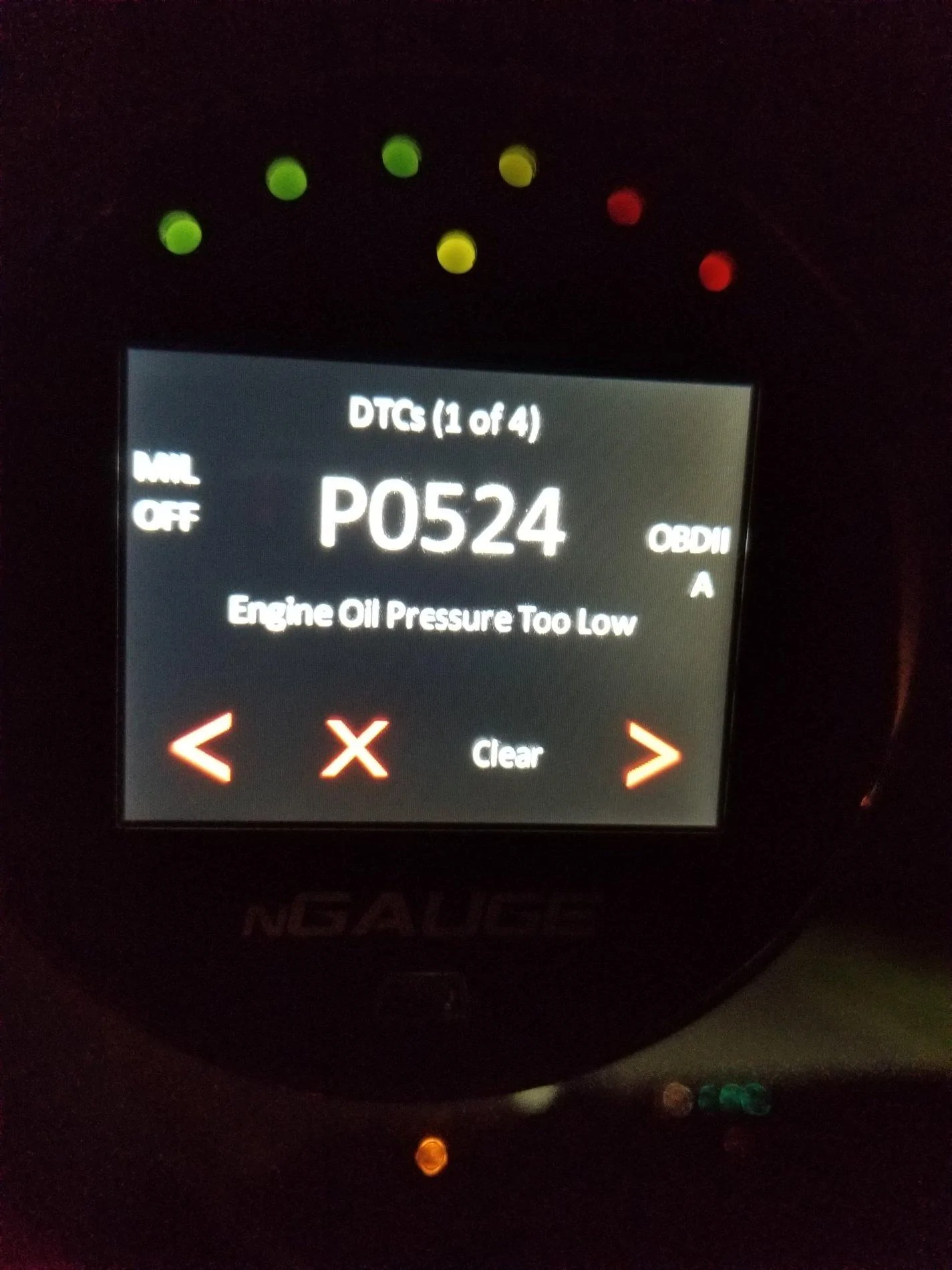

Here is the troubleshooting procedure from the service manual. Are you getting any DTC codes? It looks like you should be getting a code if the solenoid fails.
These are the codes that I got.
Zed09
Jul 4, 2018
Minneapolis, MN
Brian
2018 GT PP1 Magnaride MT82 Whipple 3.75
It looks like you have three other DTC codes, what are they?
