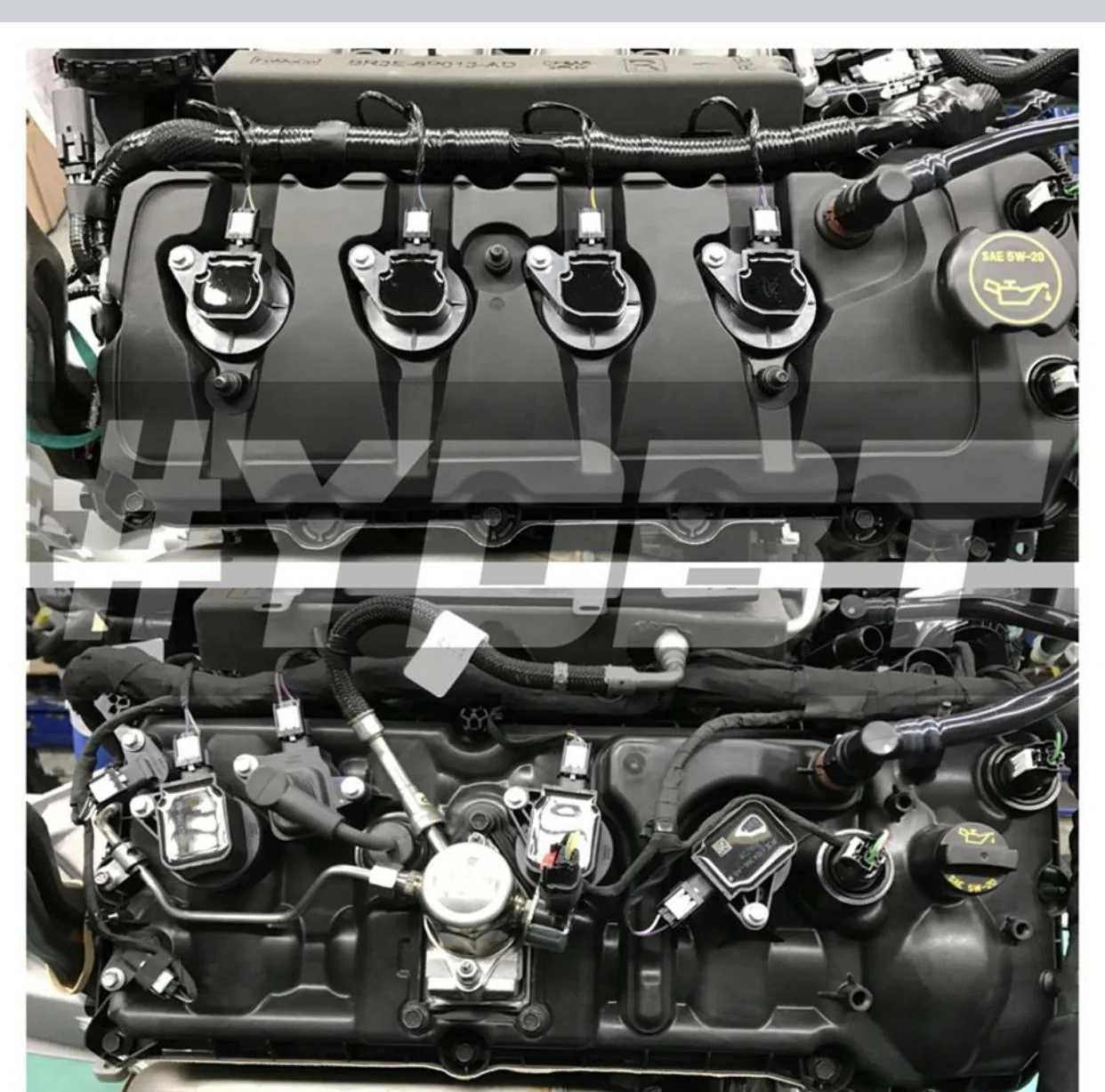

The only thing I don’t think will work is on the gen3 engines the cam shaft sensors were moved from the back of the head into the valve covers. And the exhaust phaser sensor was relocated onto a tone ring on the camshaft as well. Not in the original place, So that leaves a couple options.
