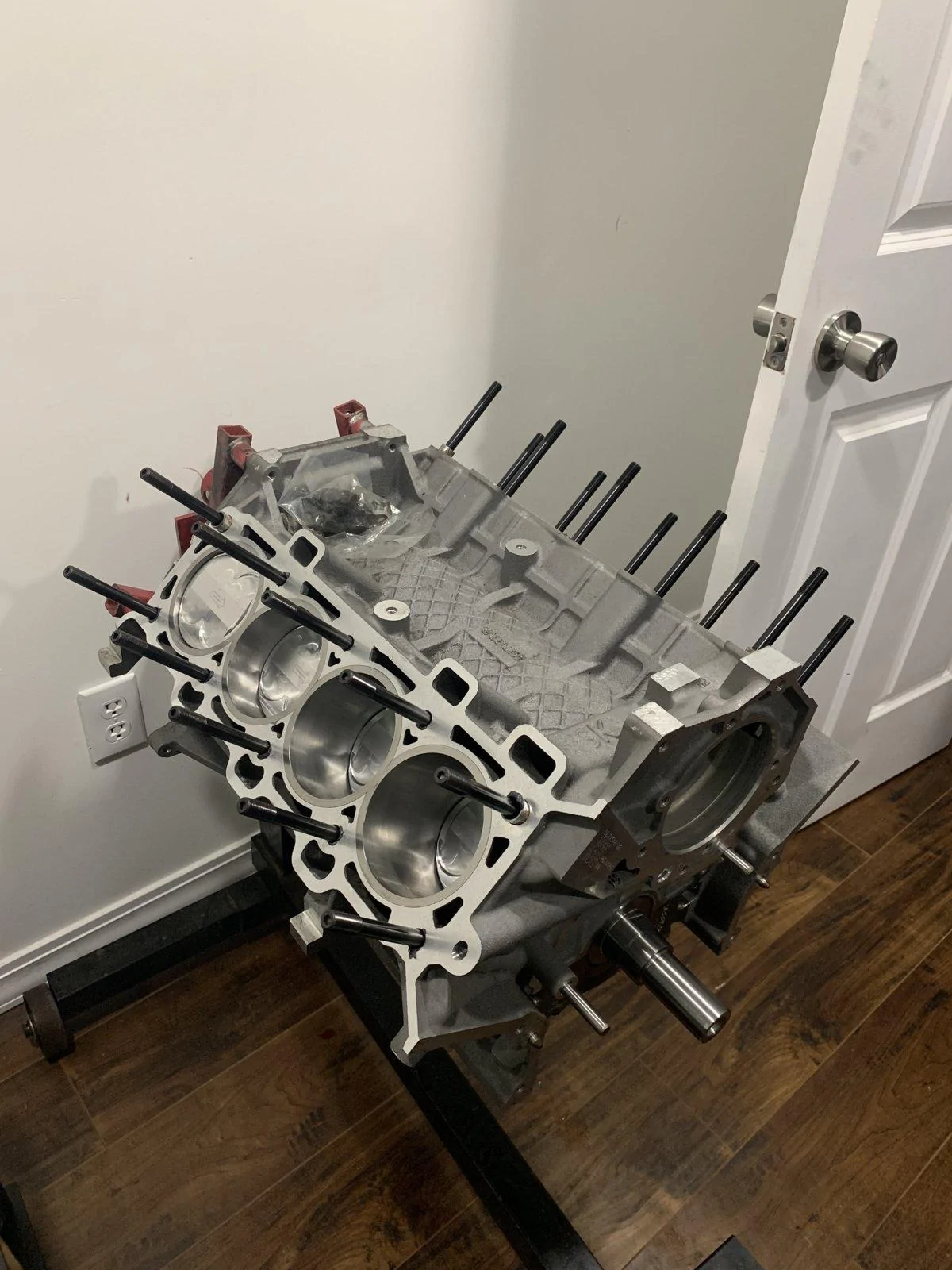

    That kind kills the idea of being anything close to cost effective, even with the Gen 2 drivers side back order at Ford. I would try and scrounge a used set, use the funds to get them ported/polished and refurbished. A lot less headache, similar if not better results and likely similar cost. Unless your going full drag car, you will likely regret losing VCT down the road. With a turbo it would make a noticeable difference in spool and driveability.

    Update ?
    I am curious what the OP ended up doing .
    I also have a sleeved Gen 2 block and wonder if it would work as a “spare” for my 2018 with a Gen 5 whipple .
    I like keeping spare engines , preferably long blocks, if I can when boosting this cars (saves downtime ) lol.
    I was told the main issue with using the Gen 2 block with Gen 3 heads /DI injection is the 18 pistons have a special dimple to help atomize the DI fuel .
    I do have brand new gen2 heads(with PAC springs /retainers ) I bought a year ago ,and could use them to assemble a long block(might sell for the right price is OP is interested )
    Not sure I want to use a Gen 2 long block as a spare for an 18 or even it it would work .
