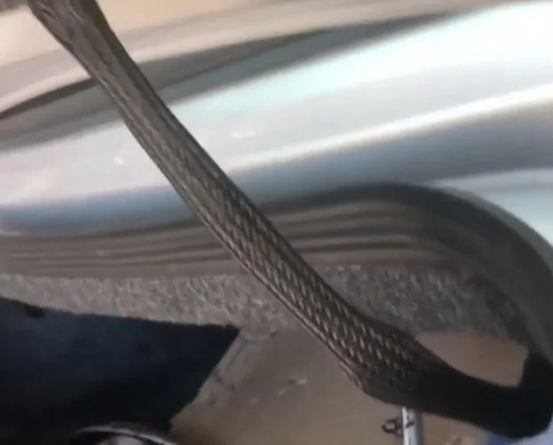

I will hijack this thread because I had a trunk leak on a 2019 (droplet spray appearance on ground) luckily I have a husky liner that cups any liquid in the trunk so it was easy to see. It has not rained at all here since I got the car, except for the two spray washes I had conducted which I had already put the liner in. I then took a few buckets of water and poured it all over the window. So far it has not happened again as long as I manually take my hand to the side of the trunk and make sure the rear view camera wiring and wiring mesh cover completely enter the trunk away from the seal, by holding it away from seal while closing. It will not do that if I just close the trunk normally, I noticed the entire rear view cam mesh before the felt cover of the trunk liner was all wet while felt area was dry, so I also could see how it was being folded and staying outside the liner area of the trunk when closing, so once I watch the trunk close from right side, I took my hand to hold it away and it went in, I then poured more buckets of water down the rear window and watched all the water puddling and settling and running down the bottom of each tail light. The trunk did not seem to leak, I was also observing with the rear seat down and a flash light as the buckets of water were being poured, I could see that the rear cam wiring having some portion being folded past the seal may have been the culprit so far as the OP has stated, so we have to carefully watch the wiring and hold it when closing the trunk. I will continue to monitor it, but I for sure did see that seal was not complete due to rear cam wiring and mesh hanging out on the seal. It now survived another power washing with no water in the trunk.

I was able to finally bend it and re-form it with my hand to not get caught between the liner, and so far the wiring is now completely entering the trunk and clearing the rubber liner and not getting pinched anymore, so no more leak

For those trunk leaks that relate to the rear camera wire, some came with the wiring kinda folding into the rubber seal when closing, instead of completely entering the trunk. here is an example of a good shape which will completely enter the trunk instead of pinching between the seal, Just close your trunk slowly and look on side and see if wire is fully clearing into the trunk or is about to get caught between the rubber seal and trunk when closing.
I discovered it when I felt the mesh getting very wet and dripping into trunk, then I could see how it was pinching... so I bent it a bit more straight and further away from the seal area and it now clears completely and no more leak
