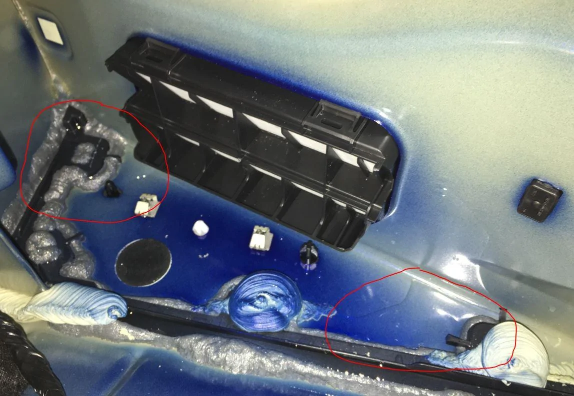

I got my GT last week. As I was starring at it in the garage my wife had opened up the trunk to get something out and commented that the carpet in the trunk was wet, sure enough it was. This car was fresh off the delivery truck and came straight home. I decided to investigate further by removing the inner trunk side panels so I could get do to the sheet metal. In both of the "cubby holes" behind the rear tires there was water.
As I washed it on Saturday and sprayed it off today I again noticed water on the carpet.
Is anyone else experiencing this? If I have missed this topic somehow please point it to me. The pic below is of the standing water in the cubby behind the passenger rear tire. Thanks!

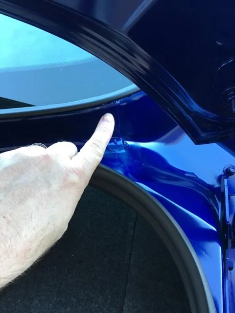

Took it to dealer yesterday and they replaced the entire rear window. I had found the leak before taking it to them because the service dept doesn't handle glass, guess they call someone like Safelite. So if this happens to you and you don't want to make multiple trips to the dealership then make sure you locate the leak before you go. The service manager will then have to take pictures of the leak area, pictures of your car and get it approved by Ford before he can move forward with it. After he gets their approval he will contact a third-party and they will come out to do the repair. With mine he had to be sure that they had a replacement glass before they could come out.
