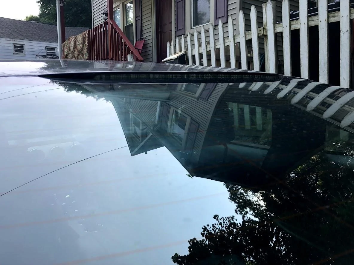

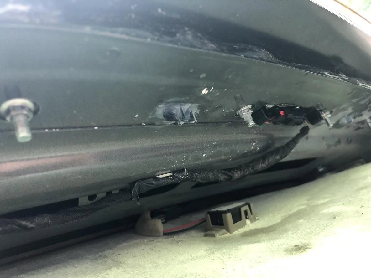

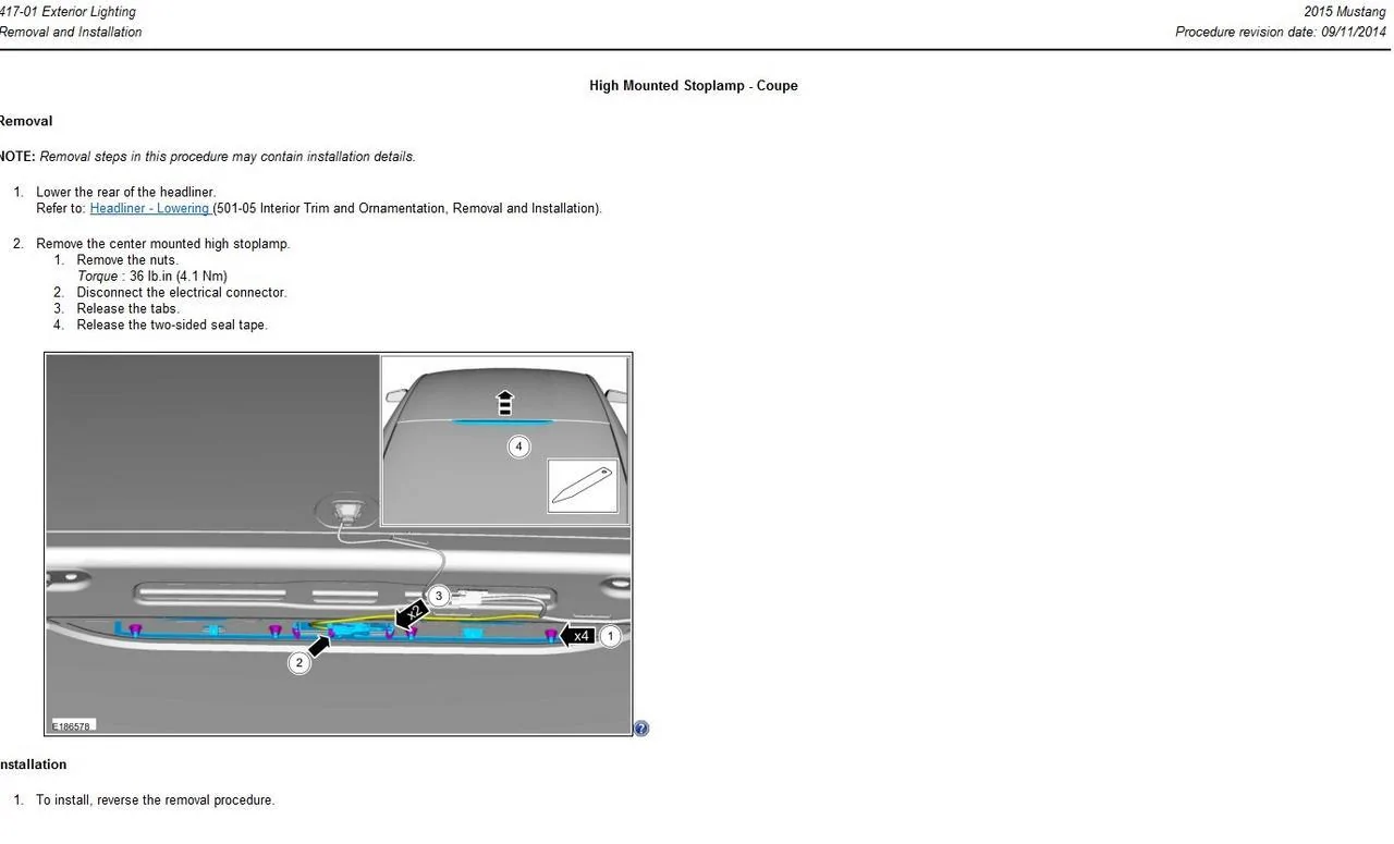

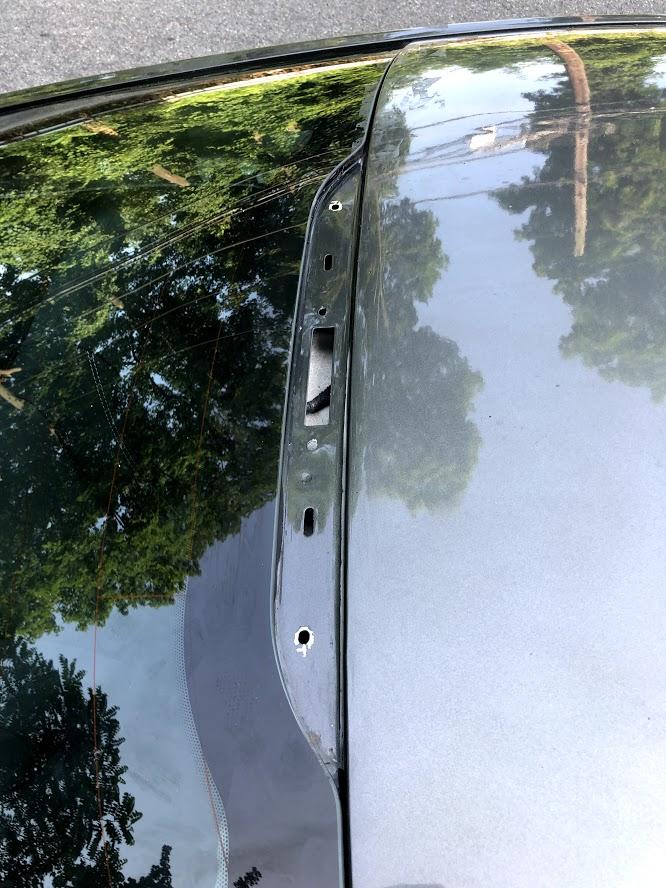

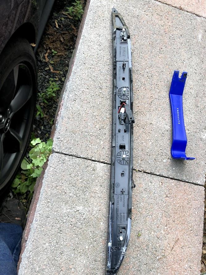

I'm having a large water leak come through the bottom of the third brake light. Does anybody know what it take to remove it. I removed the 4 bolts under it but it wont budge. Who in here has removed the third brake light? I'm wondering if the guys that wrapped my roof glued it on :frusty:
