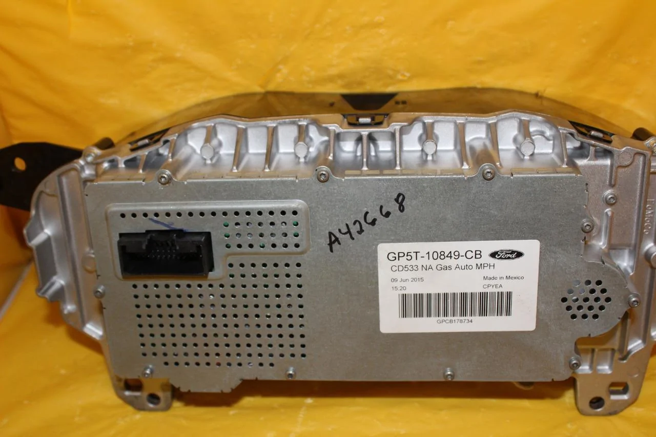

Curious... what are the dimensions of the rear cluster housing of that new cluster?... where the port is and such... It is usually a rectangular metal part.

The plug is in the same position, but the whole back is a metal heatsink different than the MKZ ones I want to put in my 14 Explorer Sport. I had to cut the plastic piece behind cluster in the dash for it to fit. Waiting on forscan i guess to update i sent them my log files.

Yes that is correct, I was aware the back is metal. I was curious on the dimensions (mainly width), if it was the same size that the 10" lincoln style clusters use or if it is actually longer. I know the older 10" digital clusters had a lot of wasted space, which is why I was curious lol.
Similar to this:

When I pull it out of the car I will take measurements

I know it is the same width as the old cluster but it has two connection points on the sides that are wider than the cluster itself. You do good work by the way I read alot of your posts over in the fusion forum. I want to hopefully add the heated steering wheel to my mustang some time after we get this cluster worked out. Hopefully tomorrow someone is going to help me try to get it working right.
