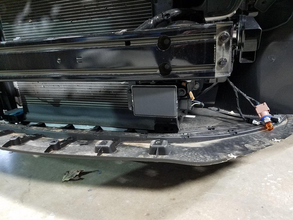

breeves, the adaptive cruise sensor itself is just a square sensor.
It's mounted under the bumper support. Not sure what other components go with it. There is no windshield camera like my Challenger had, which also had adaptive cruise.
My car is a 401 auto, ACC, BLIS, NAV, rain sensing wipers.
I'd need an asbuilt from a similar '18, but an '18 with all this also has the auto high beams. To keep everything working, I'd probably lose my high beams unless i can retro fit that!
