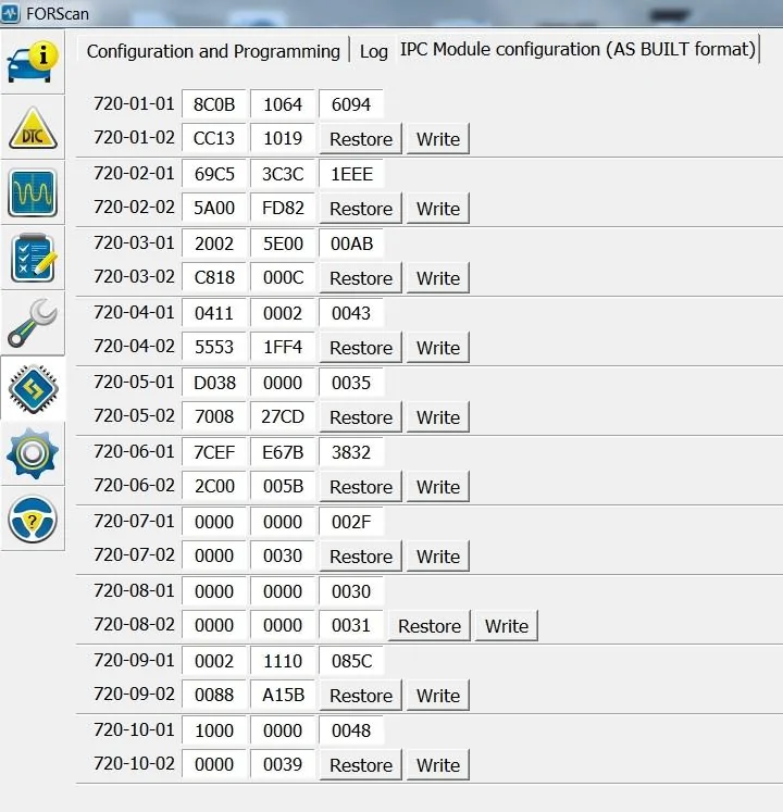

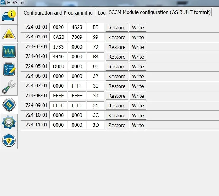

Yes these two have provided much help to this venture. In regards to the as built data I believe most of that is good for the auto (720 IPC blocks) but my manual blocks are quite different which is to be expected. I don’t have a copy to post up yet. The SCCM blocks are spot on the same as none of us have adaptive cruise and all have nav I believe.

Our IPC blocks will be more similar but I don’t have blis or even rear sensors so there will be some differences compared to mine and you’ll have to figure those out. My car literally only has PP and Nav and is a manual of course. You’ll really want to find a 18 vin that matches your build the closest to prevent any issues.

The reverse sensors do matter in the IPC because I had to code them out. Every time I went in reverse it asked if I wanted sensors on or off in the display and shutting the car off gave an option of all sensors or perimeter sensor activation which worked in conjunction with those reverse sensors. They are no longer in my IPC blocks as I was able to find the as built line and return it to my stock parameters.
There will be many as built options based on the amount of differences in all of our cars but it will be really nice to expose those.

The SCCM is killing me. Lack of that little thing prevents full function of the cluster and the interlink with the heated steering wheel and HSWM.

I made my harness and it is waiting for the damn SCCM and I was able to contact forscan to get another build to add the HSWM in the as built data. I don’t want to post that until I know it works but I did pass it on to p6cl to try as he is complete in hardware and I’m waiting for his attempt with it.
