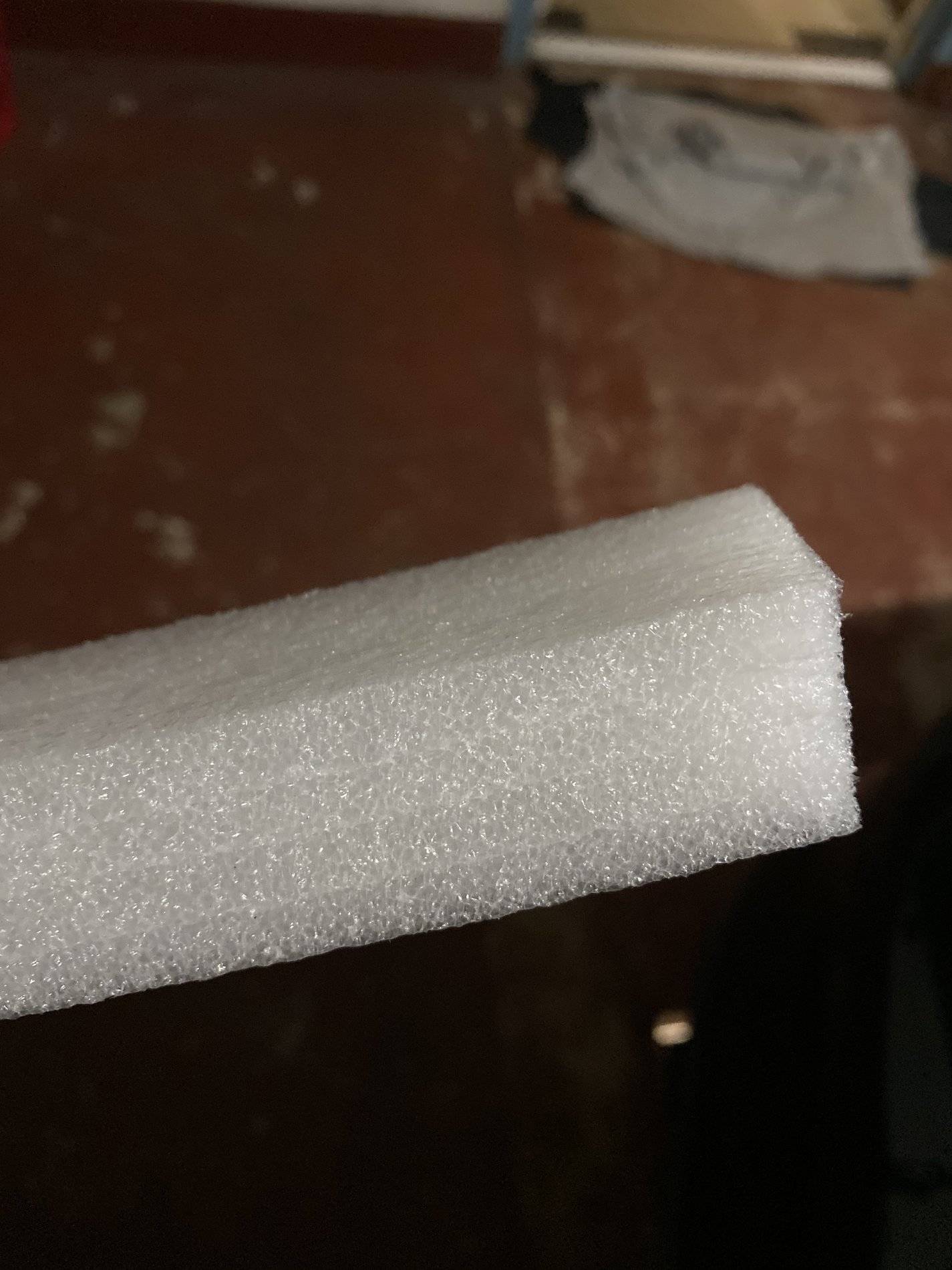

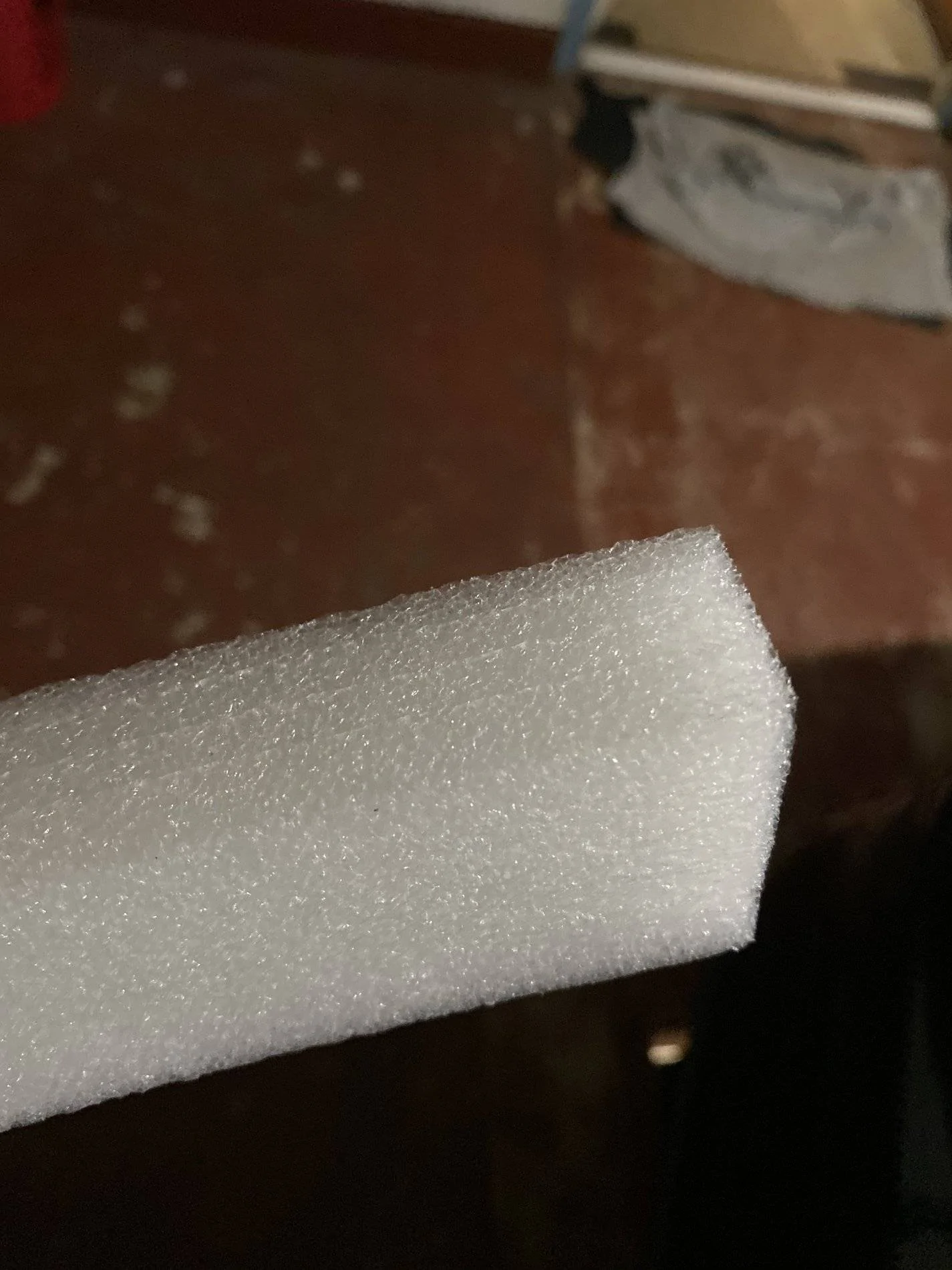

Hi Everyone , I just did my cluster upgrade and was wondering if anyone put a littlefoam or something behind the cluster on that steel beam that runs across after cutting out that section of dash that needs to be removed so the cluster fits. I test fitted my cluster and it had a little play and was kind of tapping the beam with the back of the cluster. So I put about 3/4 of an inch of that white packing foam. It’s not styrofoam. It’s kind of harder than that black foam but not rock hard. Wondering if there will be a problem with the heat the cluster produces. Like melting or fire my main concern. Any thoughts?

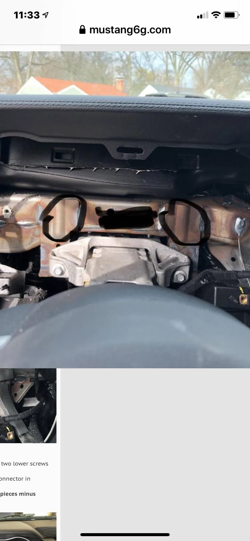

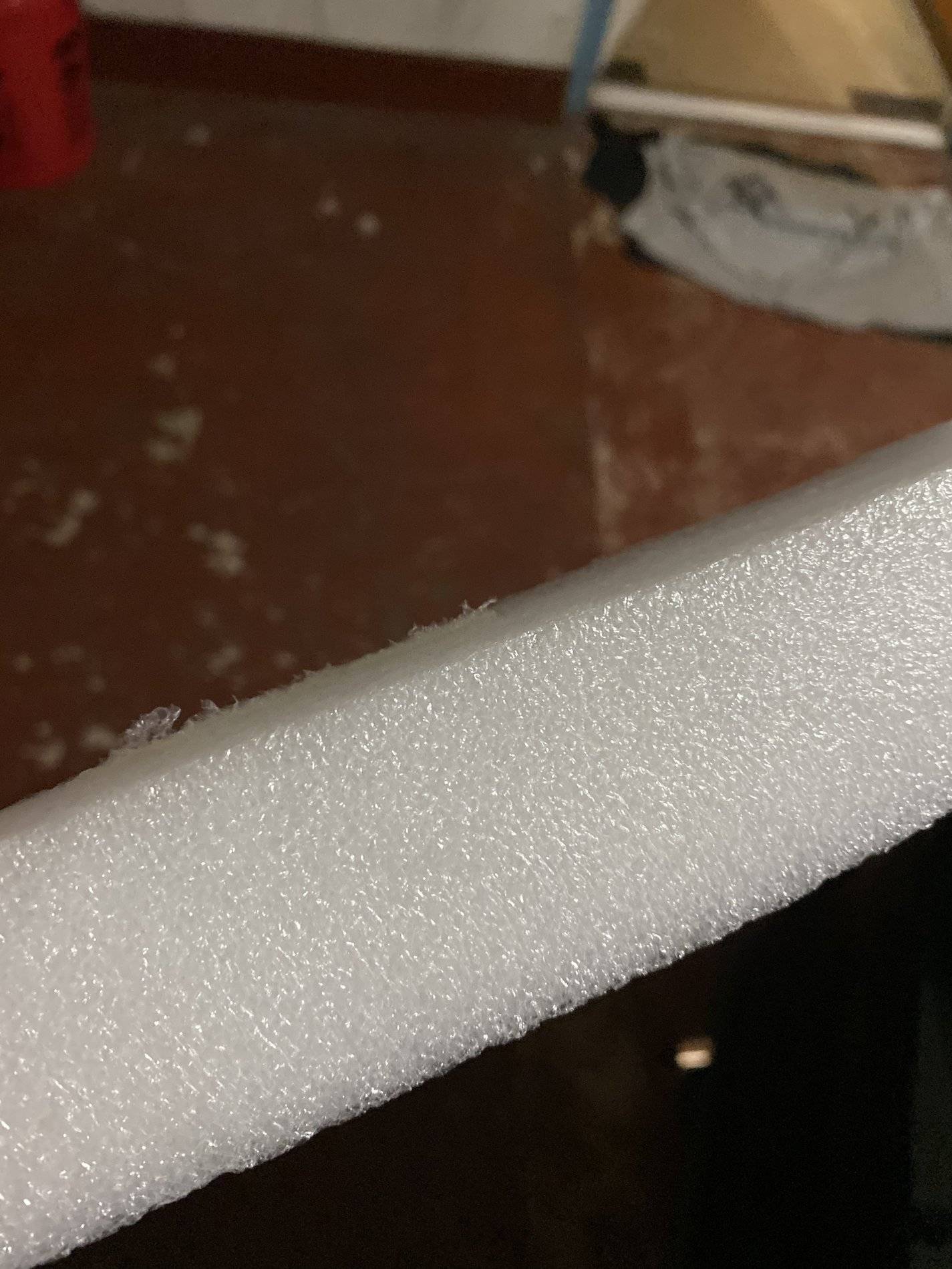

Ok that’s sounds good thank you. I a foam that is kind of hard. They use it for lining the crates at my job to pack furniture. I’ll enclose a picture. I think it’s also good. I cut it to about 3/4 of an inch thick and contact cemented it to the beam. Where I circled in the picture is where I placed it. The circled area has a square piece and the center is a long piece.

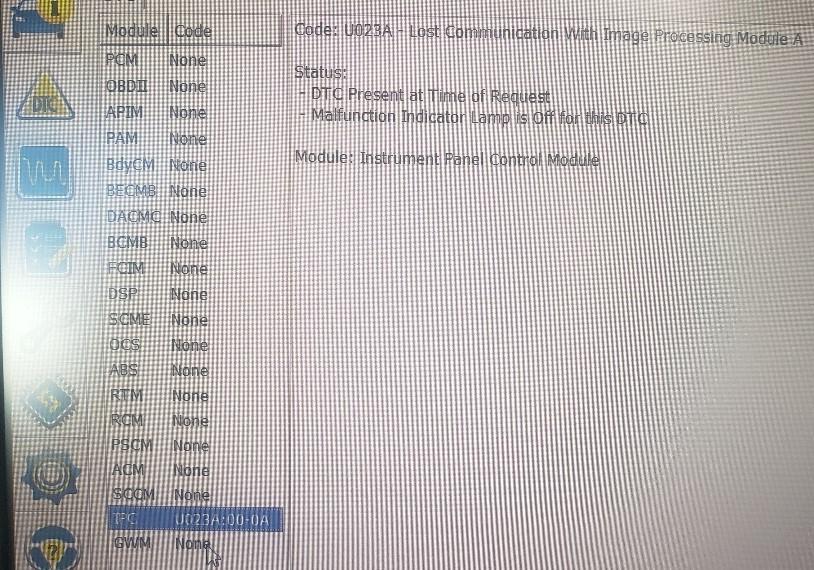

Did just the install in my 2018 Ecoboost Premium, overall it was pretty easy. After configuring ABD (I used the baseline then changed for my options) I am getting a IPC DTC code U023A after programming. Anyone know what could be causing this DTC or how to figure it out? Everything seems to be working/functioning correctly. Thanks in advance!
The DTC error cleared after I changed my 720-01-01 address values to 8C0B 1464 6034. After researching as-builts for 2018's with digital clusters, I found there is a typo in the following base as-built values that need to be changed: Auto High Beams 720-01-01 XX*X XXXX X*XX B & 0 = Disabled F & 2 = Enabled.​
The values of the fourth digit (not the third digit) in the first octet and the second digit in the last octet need to be changed.
The base as-built should be revised from 720-01-01 XX*X XXXX X*XX to 720-01-01 XXX* XXXX X*XX.

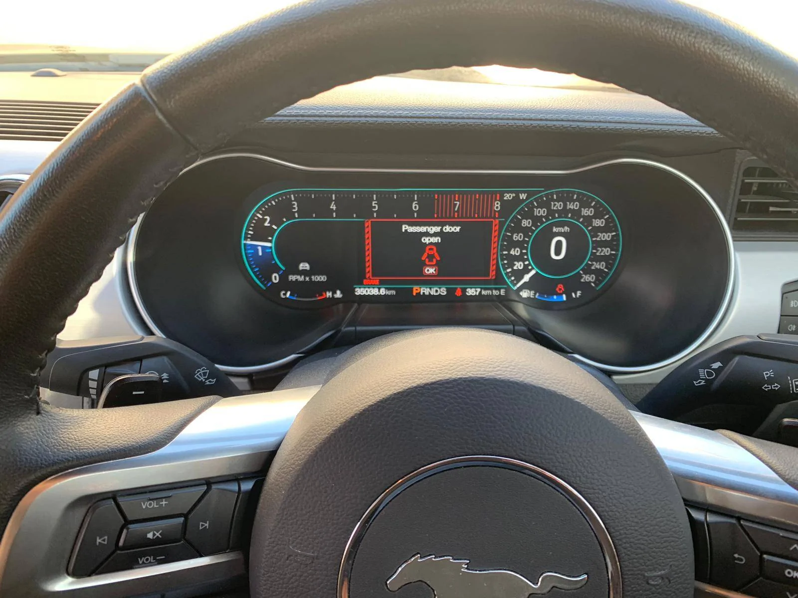

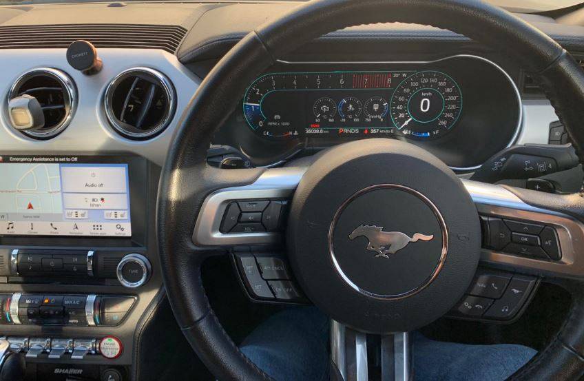

Just did the Cluster Install this week and works like a charm. Thanks Divpreet for the assistance in understanding the programming and its not that hard.
Got the parts of a wrecked Mustang and changed the mileage using Forscan.

Thanks 300mag. It's disabled in my IPC code, but I'm still getting the U023A DTC error code. My IPC 720-01-01 line is 8C0C 1464 6034.
Did you ever get this DTC error code to go away? If so, what'd you change?
