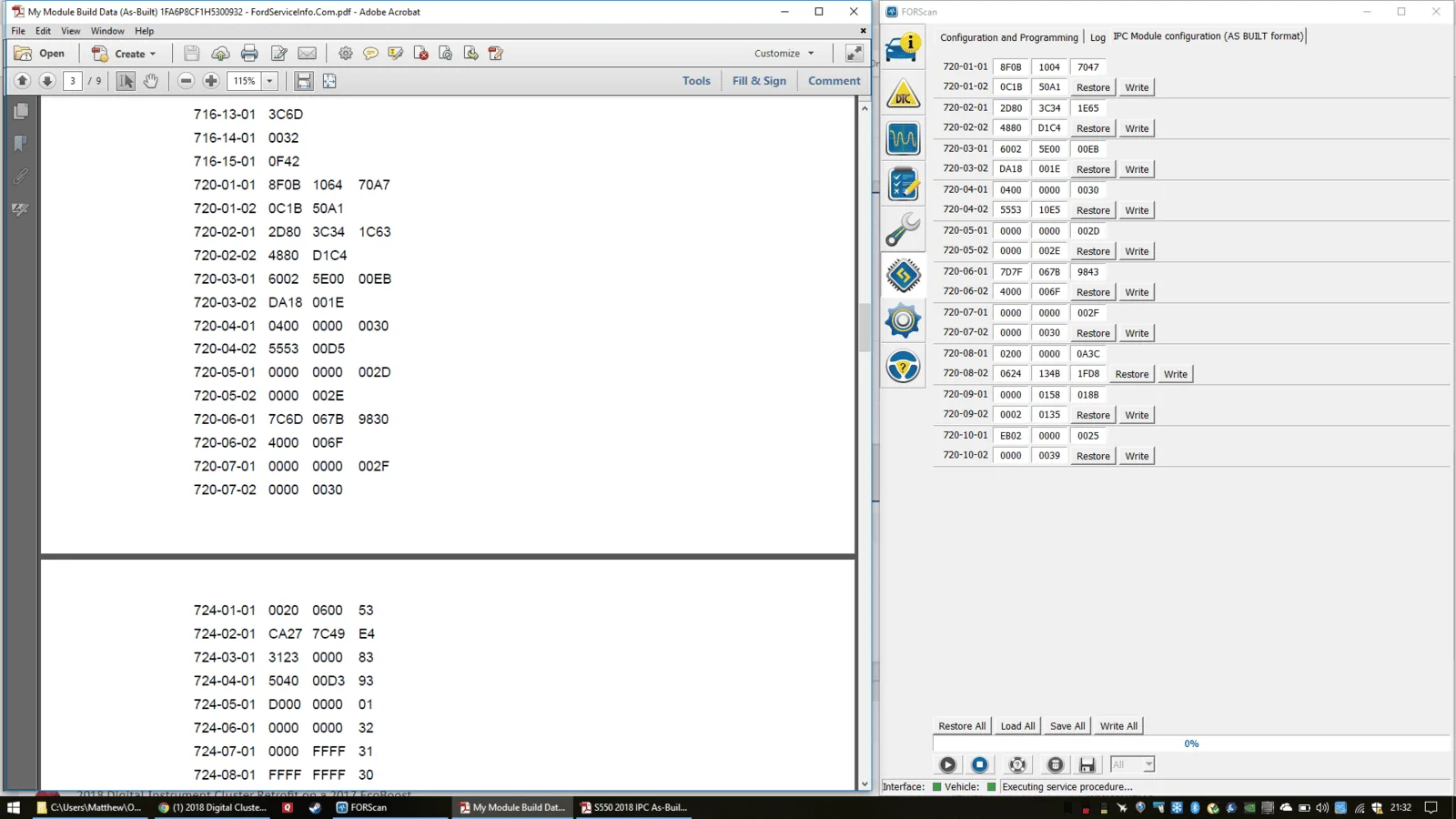

Finally got the right part for the lower cruise control switch, now the last thing that doesn't work is the MyColor. I checked the BCMB codes and they are correct (the car has mycolor hardware), but I have extra lines that aren't covered anywhere else. Every code I find ends with 7B7-06-01. My BCMB has lines past that, 7B7-07(08, 09 and 10)-01. Any ideas? Everything else with the swap works, just can't figure out what I need to do to get MyColor to work.

I can insert a screen shot of the forscan BCMB if that helps.

Here's a shot of what i'm looking at. My base data is on the left, forscan current IPC (with a few changes) on the right. Is it something past 720-07-02? I don't have any data for that section of the IPC. Everything currently works except MyColor still. If it's something that can't be fixed, I'll live. There are worse things to not have working.
