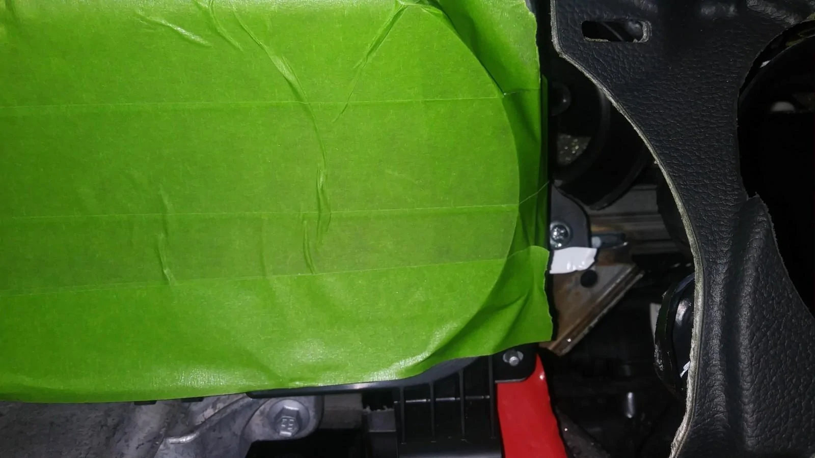

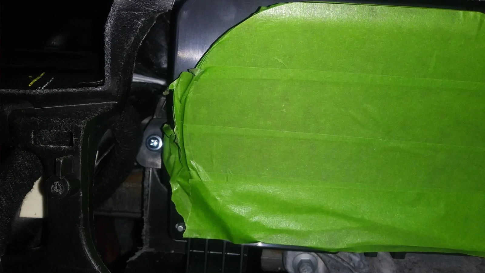

Consol installed
Consol done
[ame]
So I varied the back plastic cutting a bit. On the left side, I left a strip between the Left back plastic holder bolt and the left bottom screw block. this gives the install some strength. If you shave off the left plastic lip, you can put a #8 self tapper into the plastic through the Displays left upper hole. There not much tere, so go really easy. On the right side, there is some flat metal support just behind the screw hole, about an inch away. carefully eyeball it, Mark it, then Use a very sharp punch, and then pre drill a small hole, just smaller then a #8 self tapper, then get a #8 2" long screw and a 7/8" plastic bushing. Screw the screw in with the bushing in place behind and your all stable.
