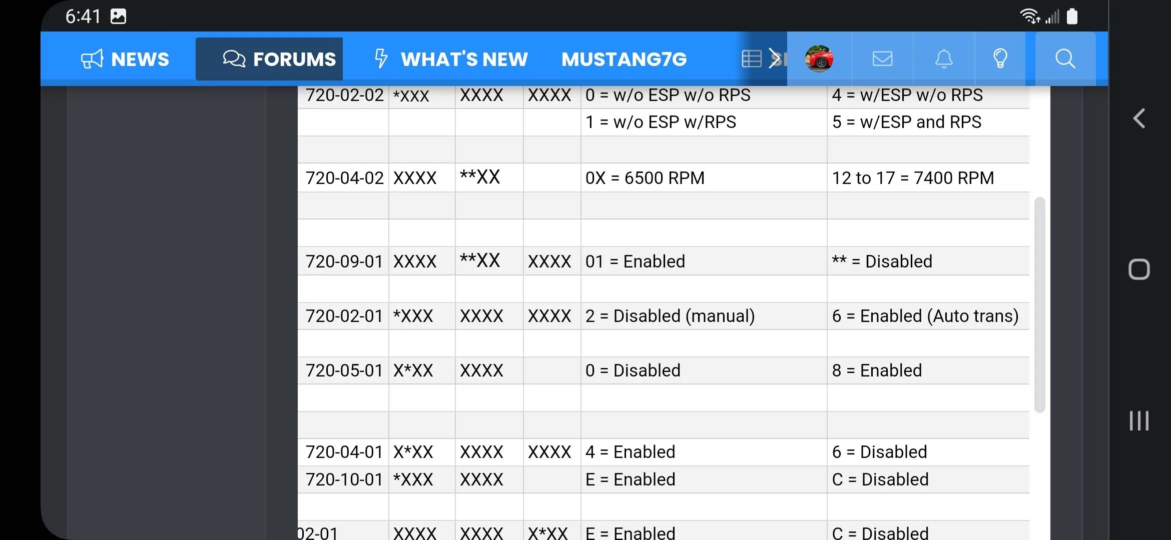

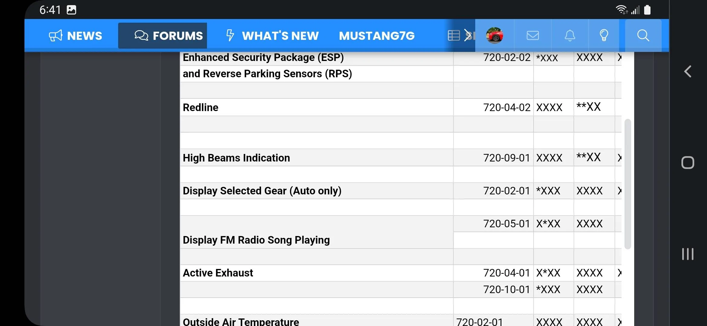

Not sure if this was asked before but does 2015 - 2017 got an option to enable gear indicator? Or its just the RPM function!? Does anyone who installed the digital cluster got the gear indicator on their 15-17?
It's in the list for the codes. 720-02-01
Put a 6 where it shows the asterisk in the code line
