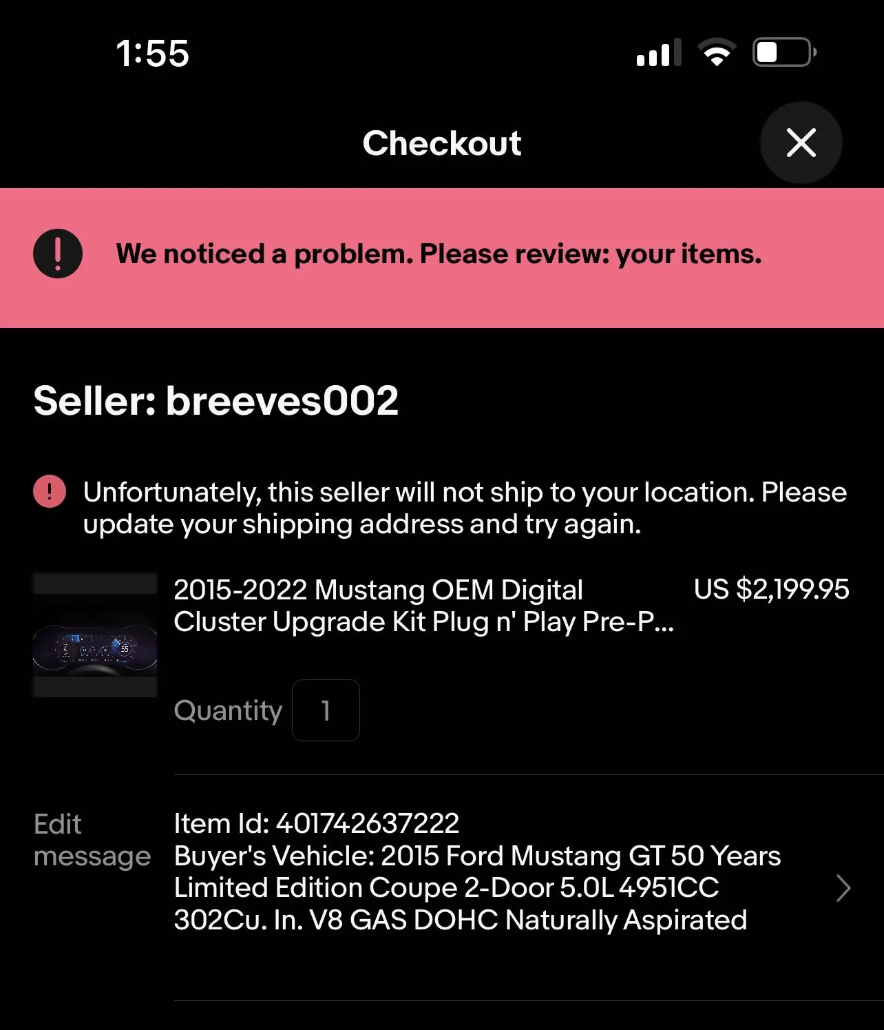

I'm from Mexico, I'm interested in buying a cluster kit for a 2015, through eBay, but I don't get the option, could you configure your sales post with ebay's global priority shipping?
