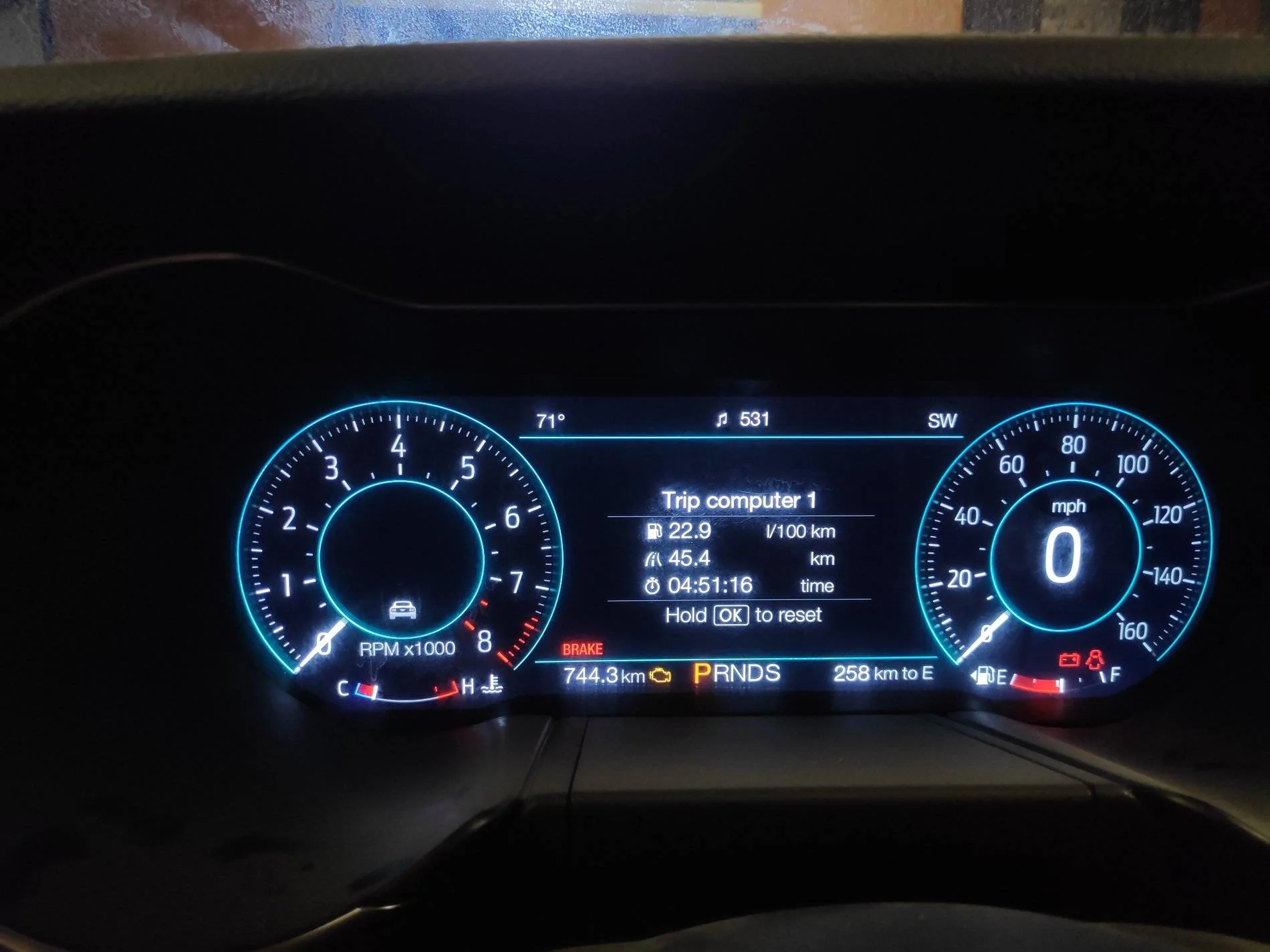

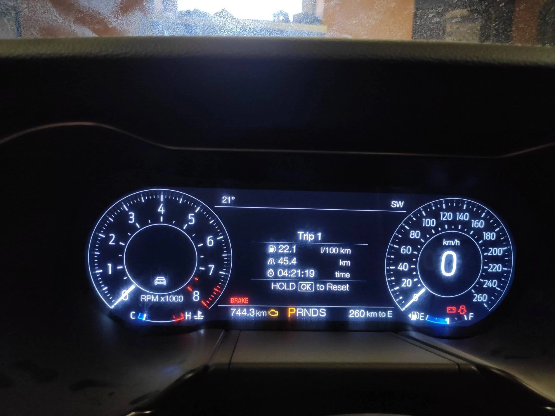

Hi guys, i have spend almost two days reading forums and changing various data like dash AB calibration, different .vbf software etc. Its could be changed by editing eeprom values of dashboard. I have succesfully changed 2018 usa dash to canada KPH speedo version.
I would be gratefull if someone can share eeprom data of bullit dash or new 2020 gt500
As I told before eeprom could be read and write by UCDS

Great! What did you change?
