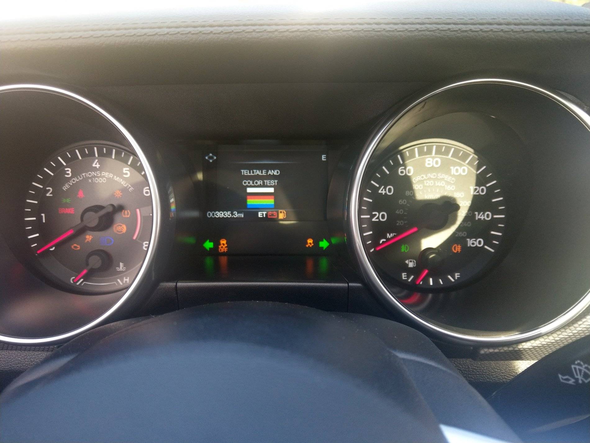

What I found interesting is the 2018+ base gauges have a fog light indicator, and it even lights up when you go into the test mode to check the indicator lights. Only reason I could see the indicator not turning on is due to the programming in the cluster being unable to be changed. Here's a picture in the test mode, on the speedometer side, they clearly light up.

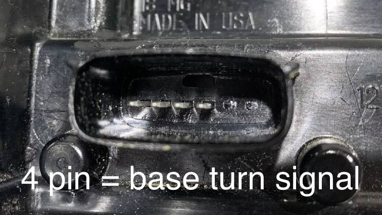

It was for me. I knew I was not going to have an issue when I saw the turn signal connector had 6 wires IIRC.

That’s literally it. To enable to the dash light it’s fairly easy as well, just requiring a setting flipped in Forscan. Took me all of 2 minutes to enable.

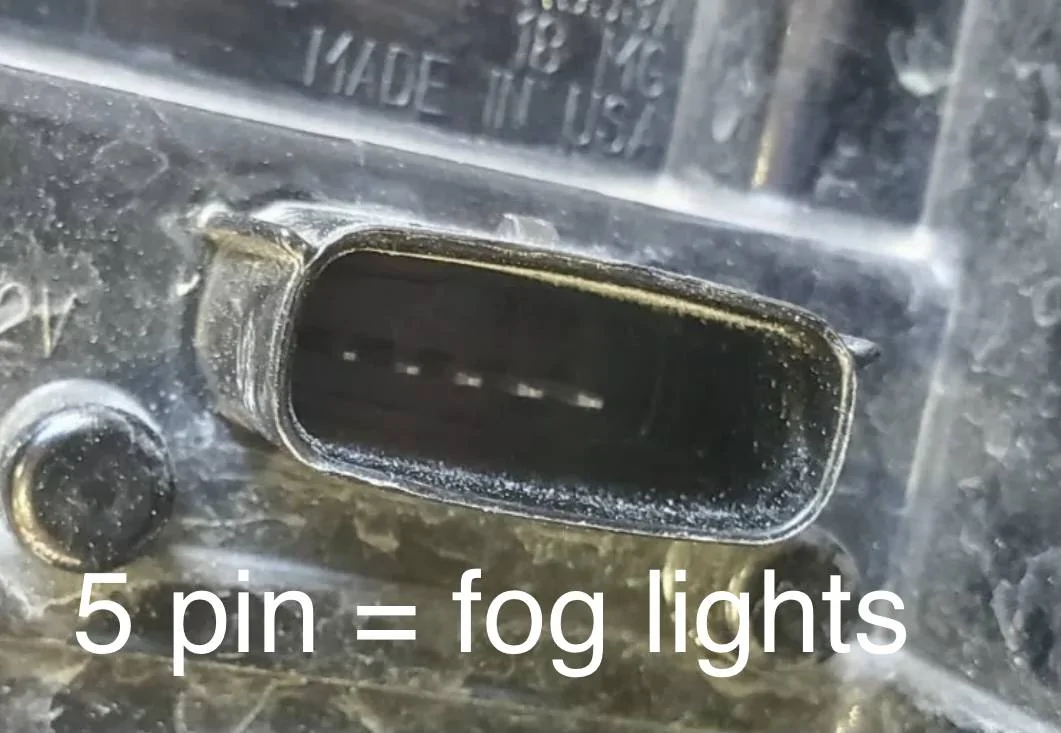

You have the part numbers right there. JR3 means model year 2018 Mustang. https://www.blueovaltrucks.com/tech-articles/how-to-decode-ford-part-numbers/ The 2018 model was not some flash in the pan, its changes still carry over to 2021.
If you can get your hands on a 2021 base model, and open the hood, you can reach down and unplug the turn signal and count the wires in the harness. I didn't know that was a possibility until I put in the Starykey turn signal kit. Watch this around the 5:30 mark and you can see how easy it is to pull it out. You do that and you'll have your answer.

You only need to add the lights and the switch. The only thing you won't have is the fog lights icon in the dash. It's plug and play.

If you want to enable the light in the gauge cluster that indicates when the fog lights are on/off, you will need a PC with a program called Forscan and an OBDII/USB cable. I recommend checking out Forscan guides before trying that but it’s pretty easy if you’re savvy with computers and stuff. From there, in forscan, you just tell it that your car has fog lights and he dash light is enabled.
