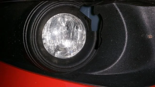

I put this in the UK section but I'm guessing as you guys in the US have had your S550s for a lot longer, you may have the answers I'm looking for.
Looks like my driver's side fog light surround has been hit by a stone and being pretty flimsy plastic, it has just shattered.
Done a search but can't find anywhere that sells the replacement and anything that tells me how to replace it.
Thanks for any help, cheers.

Comes off from backside of bumper. Bumper has to be removed.
You don't have to remove the bumper to get the surround out. My turn signal LEDs fell out of the connector and were just loose in the lens so I had to get the lens out so I could shake the LED bulb out.
It was a little bit of a PITA but you can just take the front wheels off and pull back the wheel well covers. After that its just removing all the bolts. Like I said it is a PITA and would be much easier if the bumper was removed but its not required.
