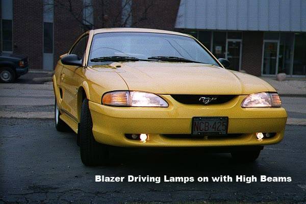

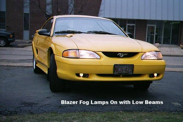

Back in simpler times, I bought Blazer Projector Beam Fog & Driving lights and put them in the stock fog light location in my 1998, which was WAY more functional than the factory plastic housing lamps. Wish it could be that simple with a 2018-21 !!

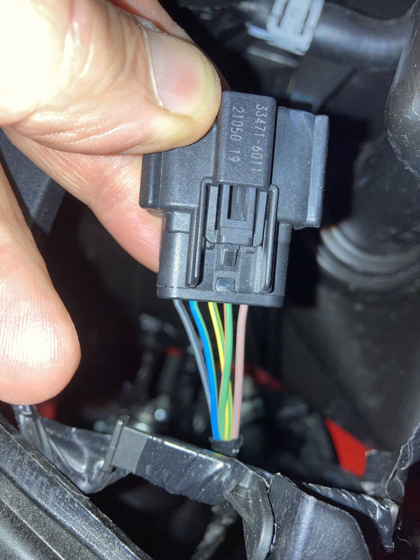

Picked up my 2021 101A yesterday, and this morning I reached down behind the bumper and unplugged each lamp assembly and both plugs DO have 5 wires going into them (vs. 4 req'd for w/o fog lamps) as mentioned in POST #8. So it at least appears that the wiring harness has not changed since 2018.

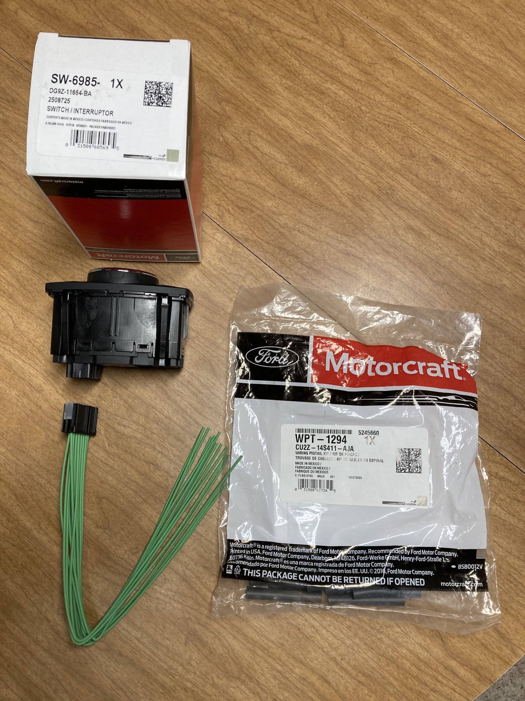

Got a Motorcraft SW6985 Switch from RockAuto for $36.94 delivered and bought 2 used lamp assemblies off of ebay (cheaper than new but more than new in March).

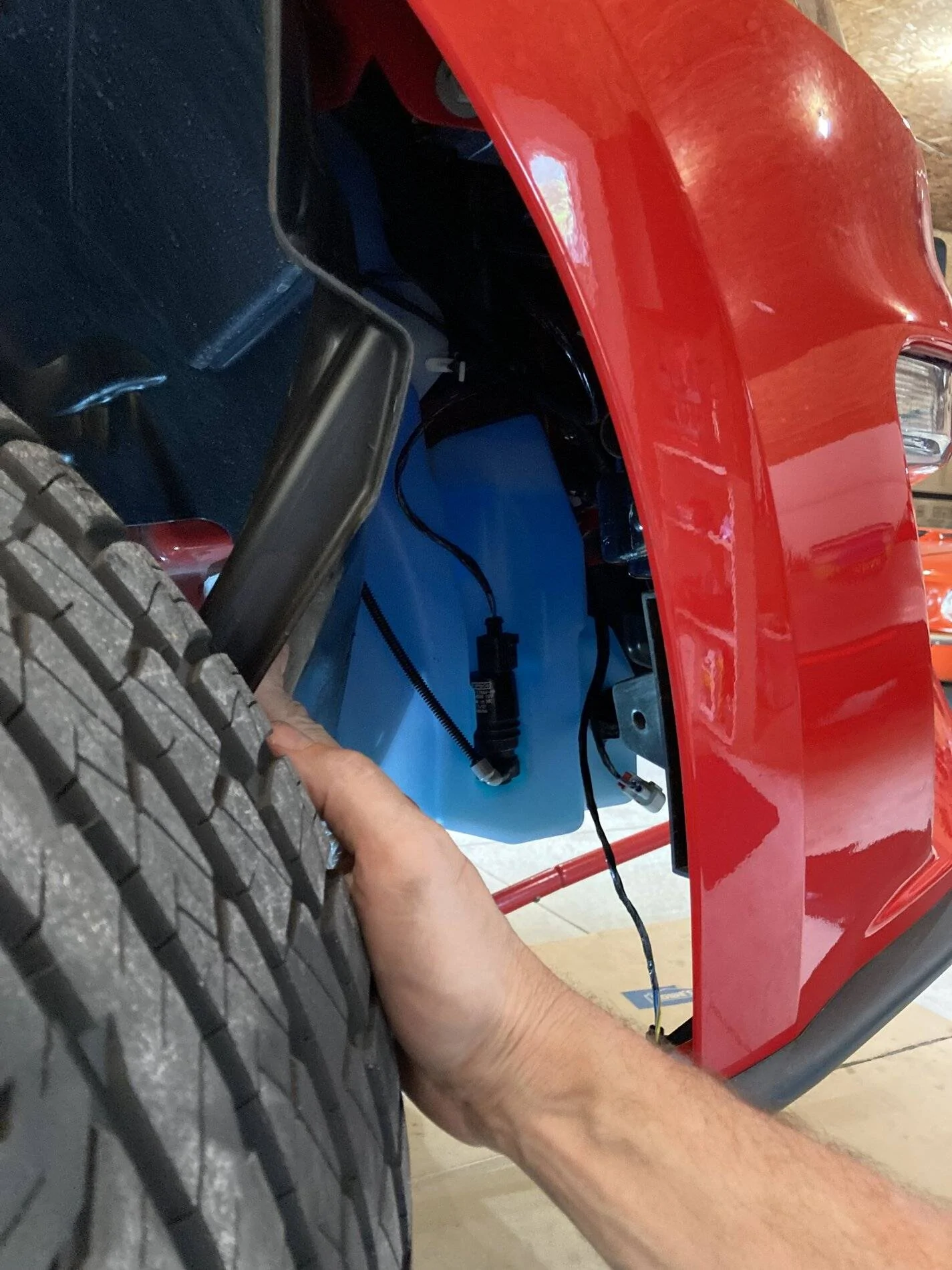

In Starky's installation instructions they claim you only need to drop the belly cover, well you also need to drop the horns (unplug & 1 bolt) on the drivers side.
On the passenger side, need to turn the wheel and undo two pins in the wheel well liner so you can push it out of the way in order to get the light assembly out & back in with the W/S washer tank right there. I also unplugged the W/S pump as this wire was also in the way.

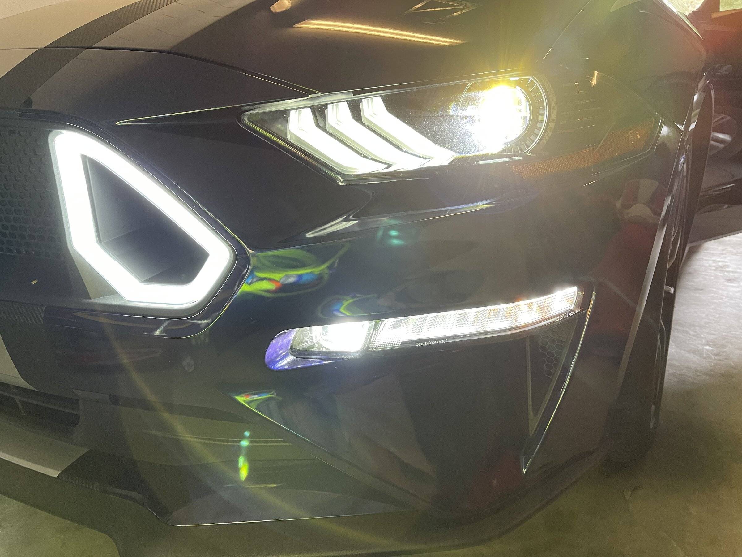

I installed Diode Dynamic Elite Fog lights and SW-6985 fog light switch on a 2018 non premium package mustang. I can confirm that it’s plug and play, the fog light works. I guess next up is forscan to activate the fog light indicator in the dash. Thank you op for this information.

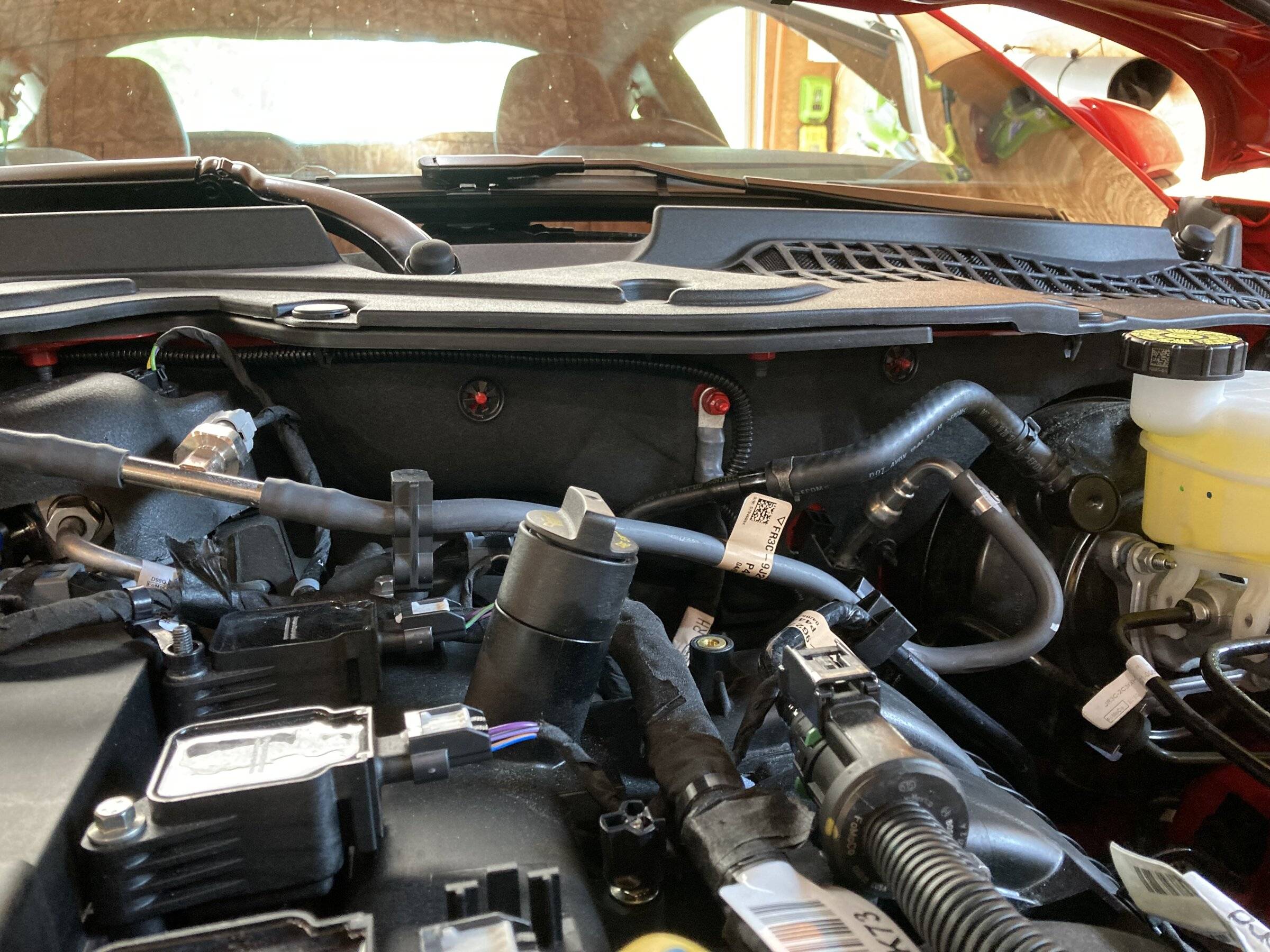

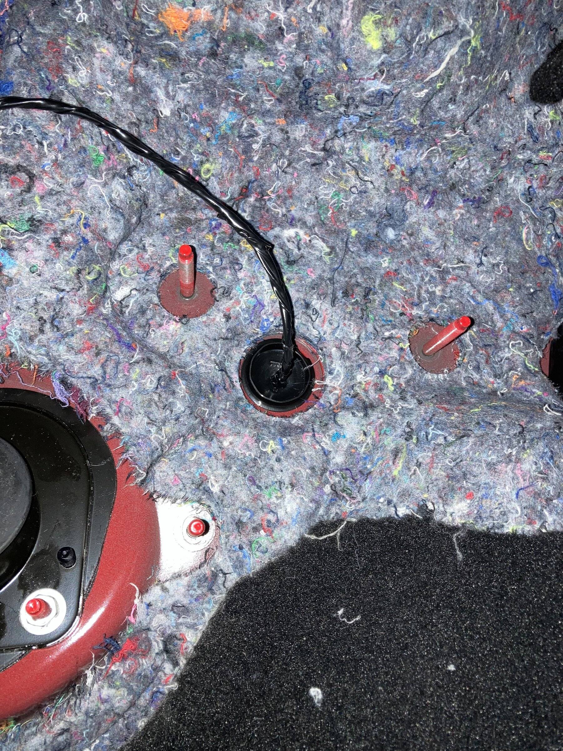

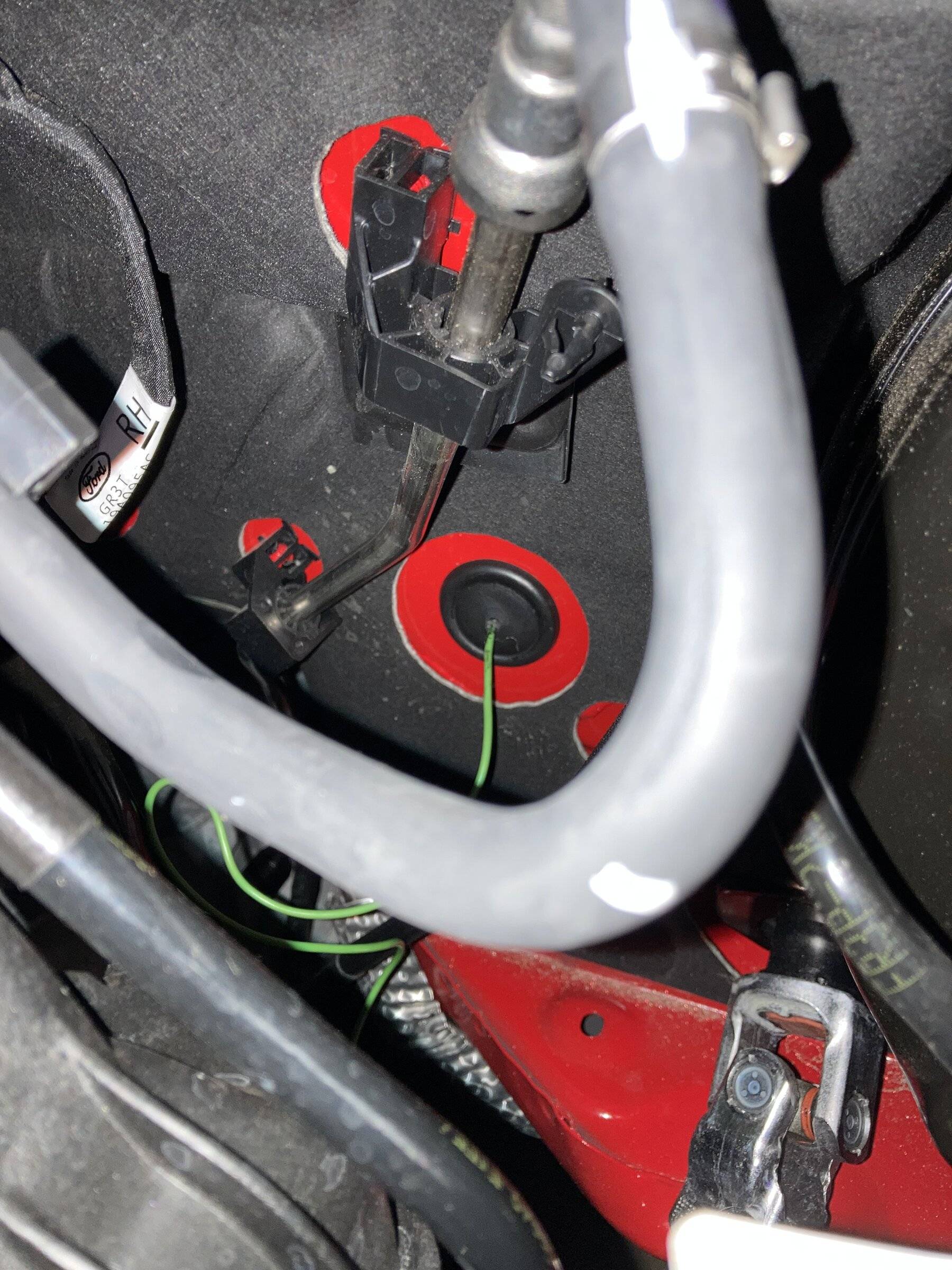

Main deviation from Starkey's kit that I did was the routing of the sense wire to the fog lamp switch. I ran mine on the passenger side under the cowl and went through a black plastic plug in the firewall that is behind the accelerator pedal. Starkey run's their sense wire on the driver's side then through where other wires pass through directly above the dead pedal. This is accessible on the inside but near impossible area to access under the hood.
I also spent $30 on a Motorcraft WPT-1294 Headlamp Switch Wiring Pigtail so I could steal one of the terminal/wire assy's out of it and NOT cut the delicate factory harness. Pulled the factory wire end out of the headlamp switch plug, taped it off to the harness, then swapped in my sense wire end in. 100% reversible solution.

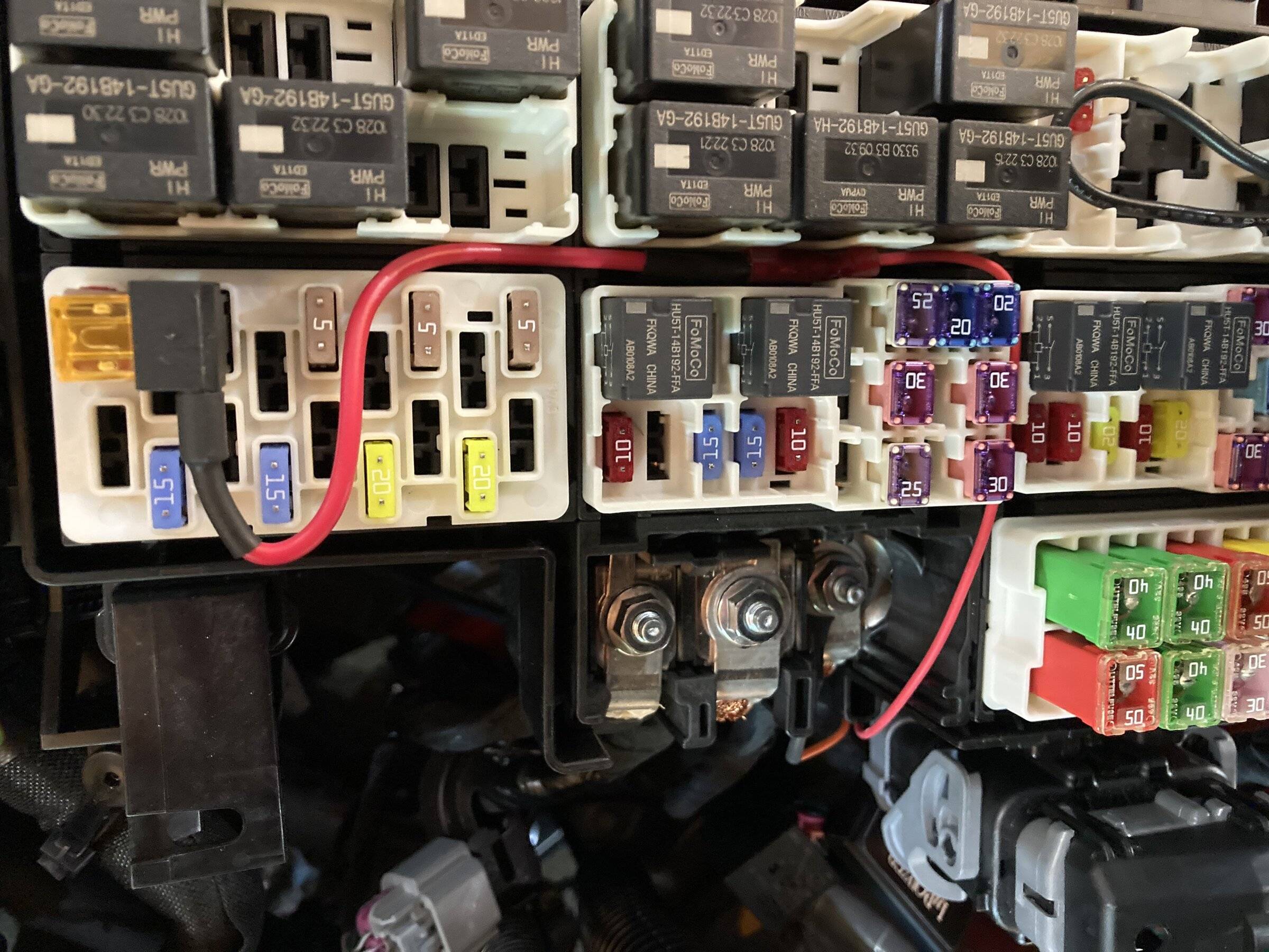

Final deviation was I used a proper "Add-a-Circuit" fuse tap adapter instead of using their supplied "fuse tab".

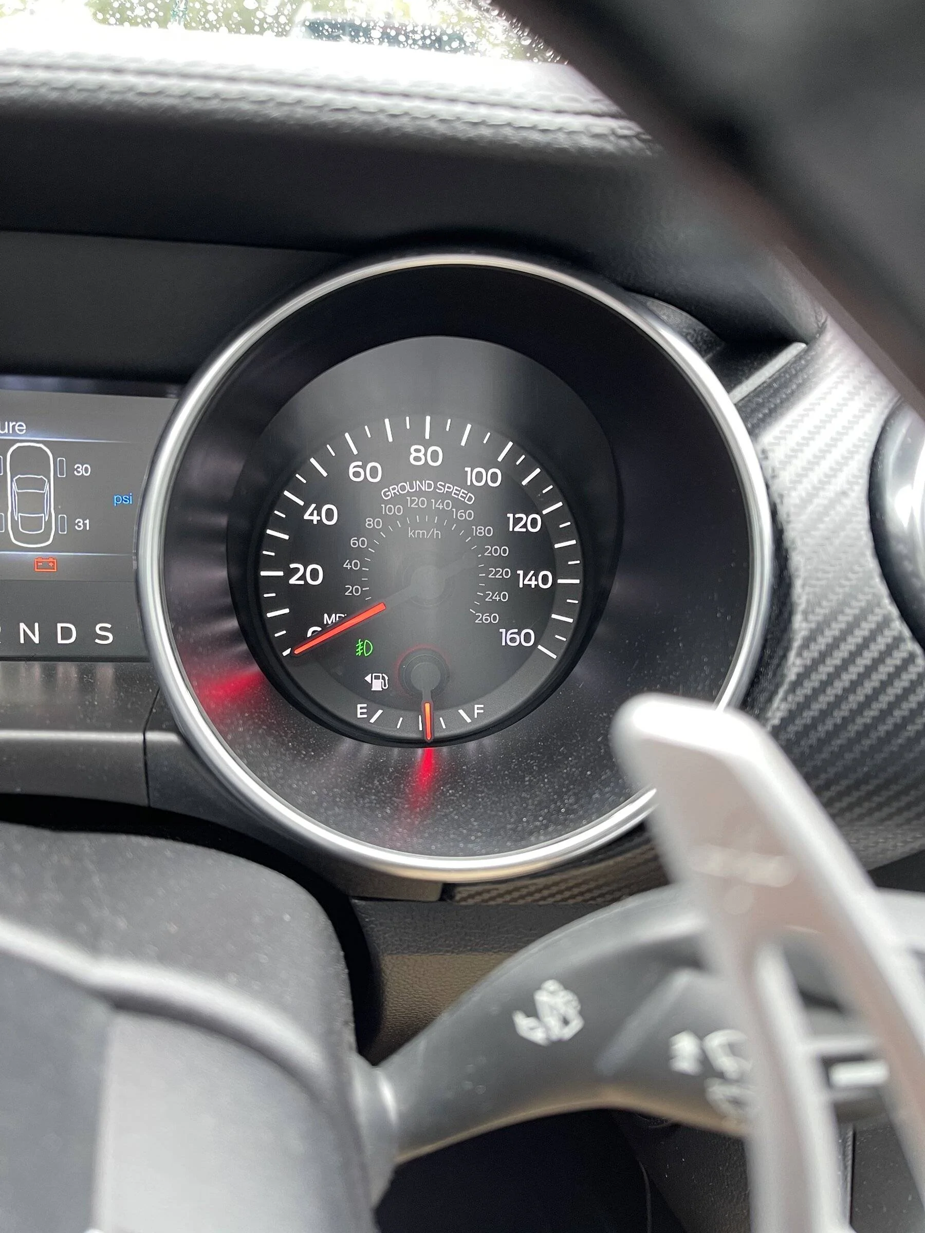

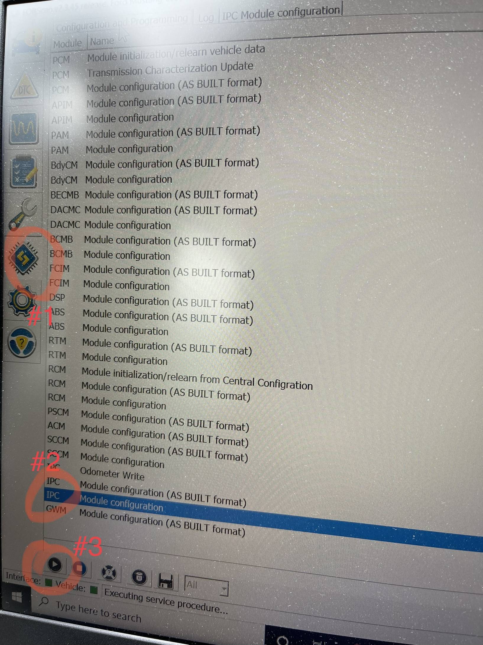

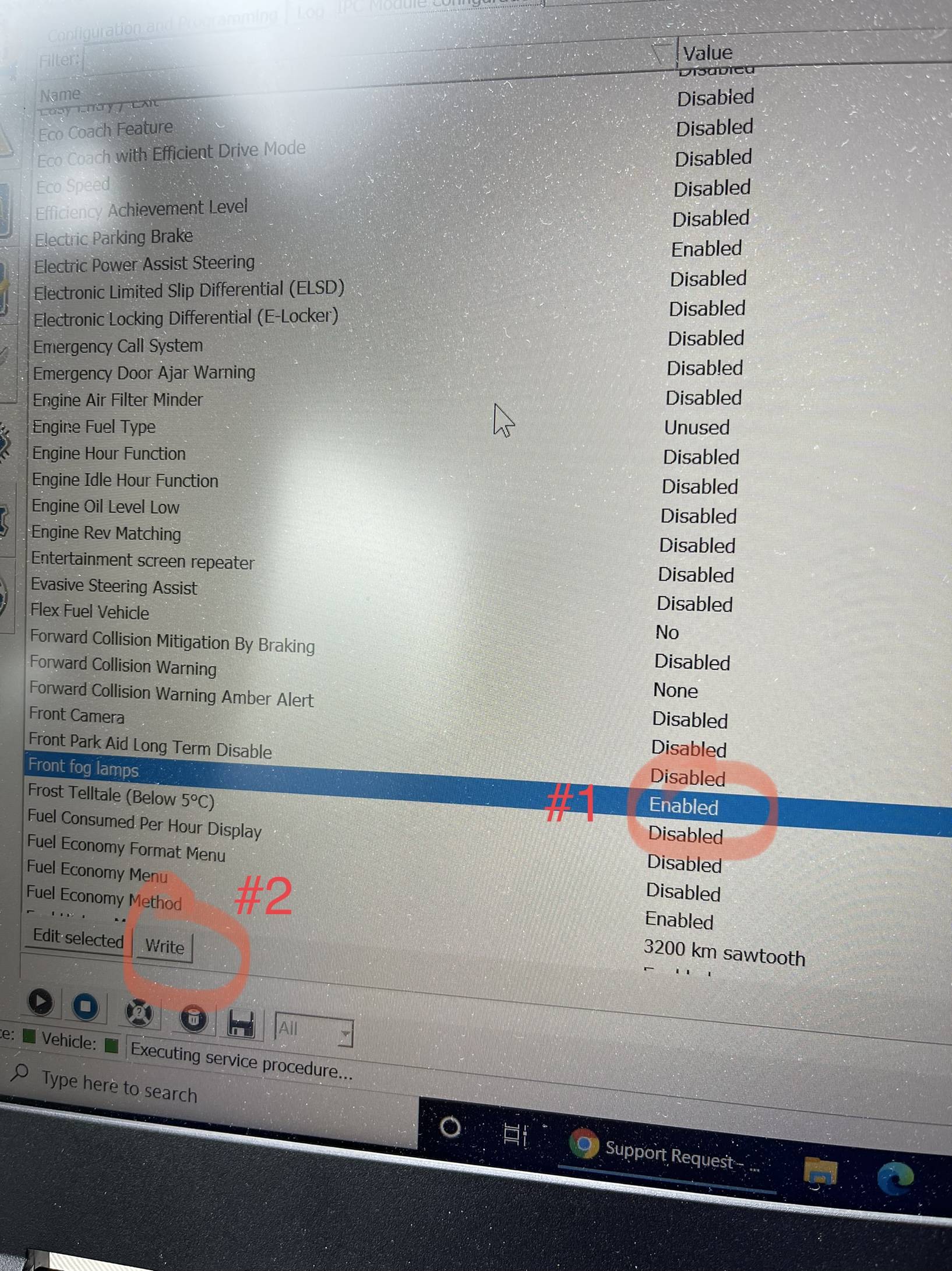

Direction for FORSCAN activation fog light indicator in the dashboard. Forgive me if I miss any steps.
1)Go to https://forscan.org/download.html
2) Buy one of the recommended usb to OBDII cables
3)Install the program on a laptop and get the extended license (free 2months trial available)
4) Connect the laptop to your car and have FORSCAN enstablish connection
5) Click on configuration and programming button, IPC, Play button
6) Scroll down and find front fog lamp, enable it, Write button
7) Cycle ignition
8) Check to see if the indicator is activated
