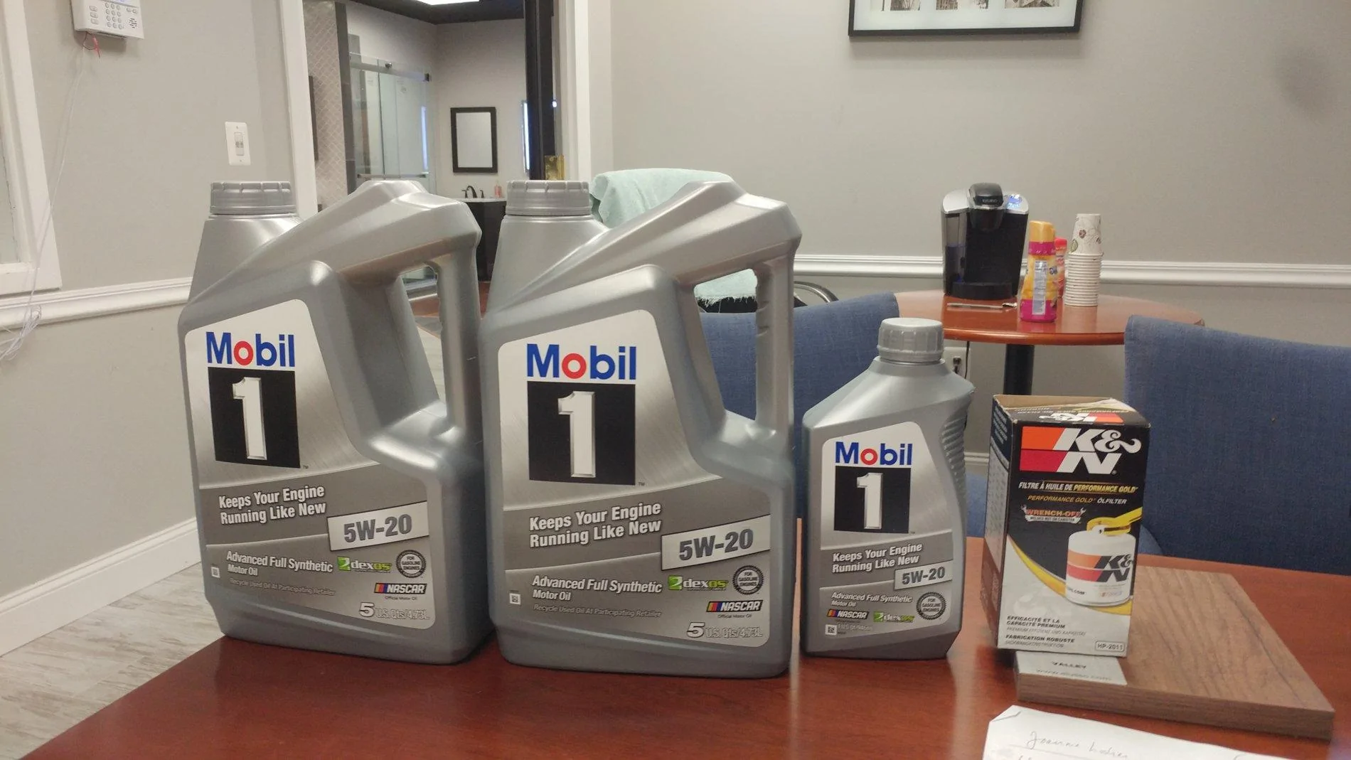

Yeah.....sooooo.......I went shopping yesterday;
I was kind of panicking. Thought something was wrong, and figured I'd get the oil changed today to see if the same pressures were seen with the good stuff. Guess I can leave the factory fill in there for a few more thousand miles, which I like to do for breaking in the motor.....

If it's any peace of mind, my longblock replacement ran on PP 5w30 from 25 miles. It ain't quiet, but it hauls ass and doesn't slurp oil. About 5k miles on it, now.
