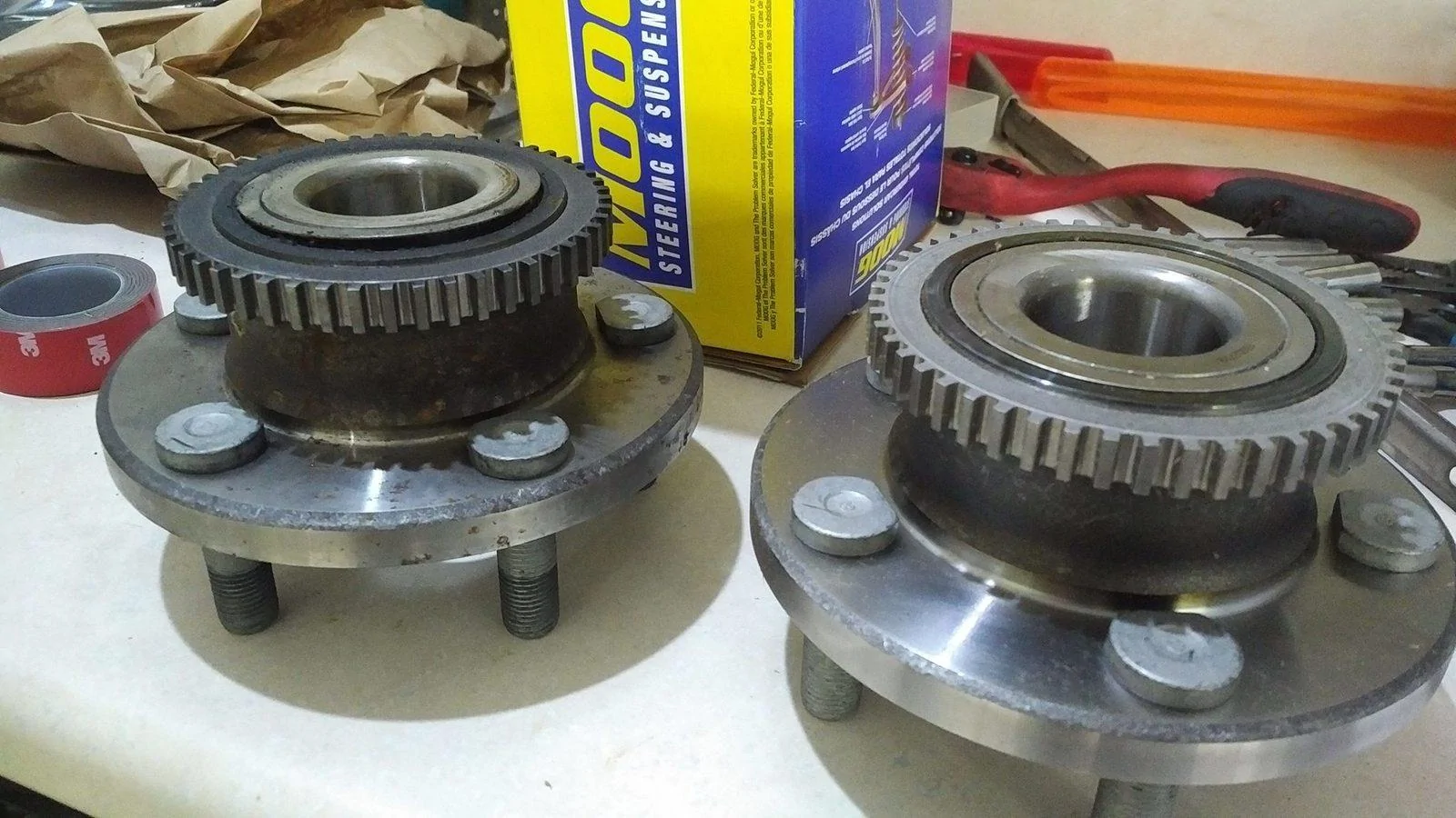

Have not seen many front wheel bearing posts so I thought I would share mine. My car has about 2200 miles on it. A good part of it is track days and drag racing. I started to get a screeching sound rounding corners. I thought for sure it was one of tge rear bearings as I have lost a halfshaft previously. I changed them out but the stockers looked fine. So I checked the front bearing and the drivers side was making alot of noise and motion. Needless to say it was bad and here is what I found. New moog piece made it right as rain.
