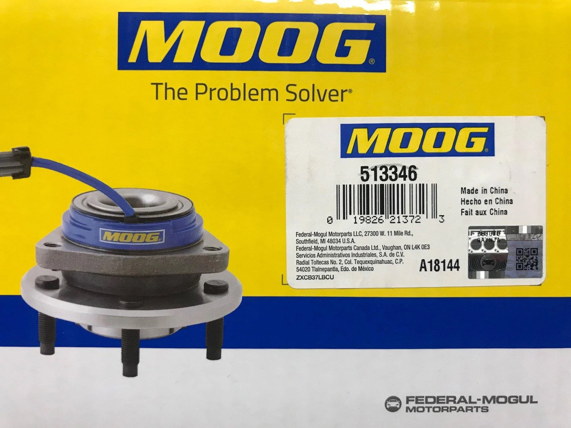

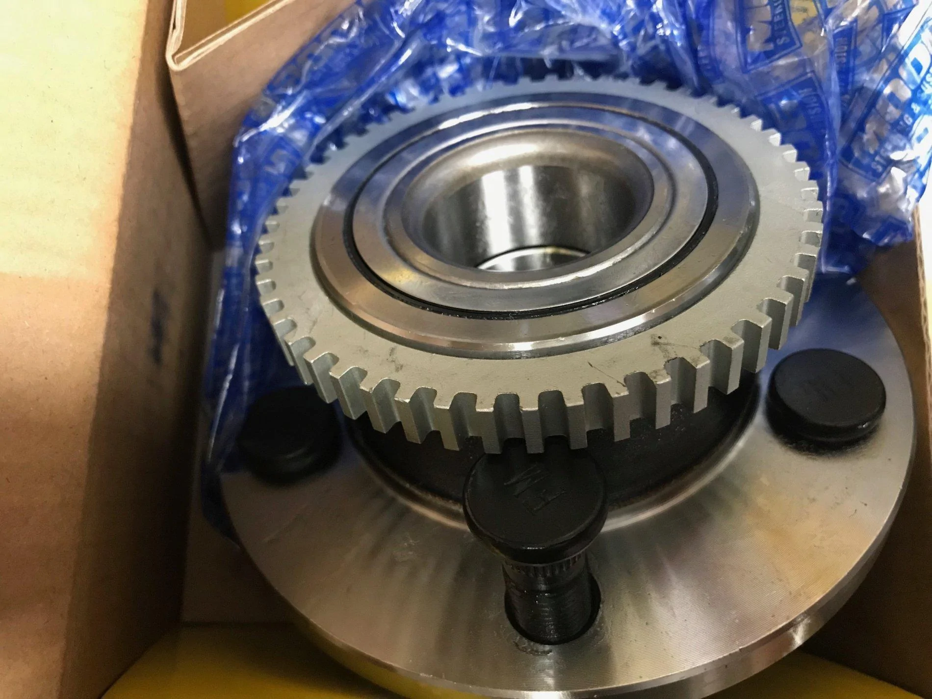

I will be trying to return these to RockAuto. I pressed out one of the studs and measure the spline and it is .052" smaller on diameter than the stock or ARP extended studs. I was going to install extended studs but since the studs lack flats on the heads and spline diameter is undersized this this way more of a hassle than its worth.

Wow that is a sad sight, thank you for the heads up. Not sure what to use if mine go out again.

Moog must have changed their requirements for this part. I ordered two and the boxes say made in China and the hubs don’t have any marking. The studs do not have the flats so they have to be cut in order to be removed.

I still have my old Ford hubs, they are not identical to the Moog hubs I put on. Sounds like Moog has moved away from what I also put on. The bearing seals on my Ford hub and Moog hubs are different colors
