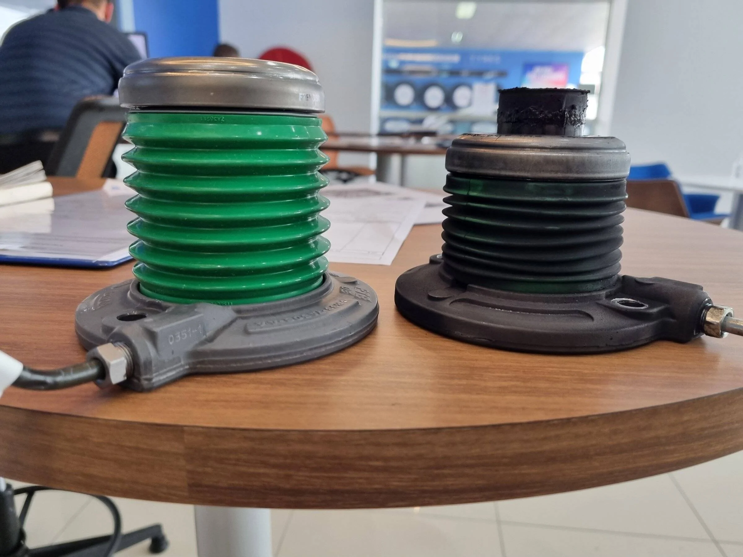

Slave cylinder out of my car on the right vs brand new one from Ford. It's being replaced under warranty. Let's hope this is the issue!

Yes I’m sure that is the issue. I was going to say it sounds like a disengagement issue or throw out bearing going bad or not spaced correctly to disengage the clutch fully.
I bet that’s what mine looks like. I threw it from second to third against a hellcat and my clutch got stuck to the floor smh
