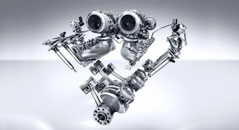

Twin & Bi are synonymous & a description of having 2 turbos -mercedes uses both nomenclatures for the same engine.
"Bi-Turbo" is NOT by definition a compound or sequential setup. Here's the AMG 4.0 "Bi-Turbo" with 1 turbo feeding each bank:
Hell, the Mercedes 5.5L "Bi-Turbo" has the turbos outside the V:
Are you seriously going to keep fighting this? Look up the exhaust flow of any "biturbo", id be surprised if you found even one that was called "bi" for a sequential turbo setup from the factory. Most are fed by individual banks in V motors.
BI and TWIN are used INTERCHANGEABLY and no, it does not define a sequential or compound turbo.

Stuntman... This is a Bi-Turbo set up.
This IS NOT the same as the Cobra Jet Twin Turbo system.
Cobra Jet= Twin Turbo (Identical Twins)
Audi's is a Bi-Turbo (Little one feeds a bigger one)
Twin Scroll principle is similar to the SC'a Twin Screw. It can be applied to a Single Turbo, Both turbos in a Bi-Turbo setup or, maybe even both turbos in a Twin turbo system.
Twin Turbo IS NOT interchangeable... It is a generic term like Supercharging. Yet you have a two types and one has a more efficient Twin Screw.
There are NO packaging or heat concerns with the Bi-Turbo. You insisted there would be because YOU were unaware of TWO DIFFERENT DESIGNS.
Twin (Parallel)
BiT (Staged)
This picture he posted of this PS'd engine is a Bi-Turbo system that uses TWO twin scrolling turbos.
Get it? Got it? Good...
