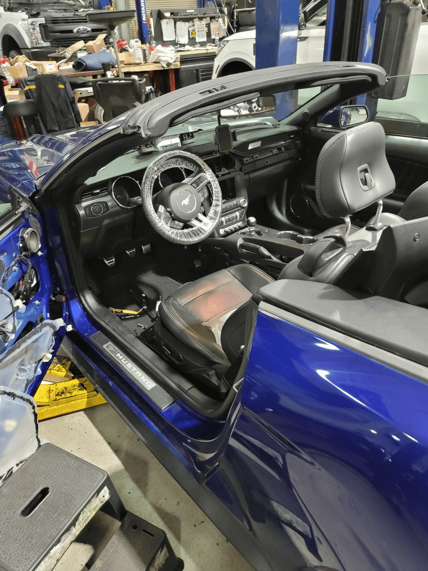

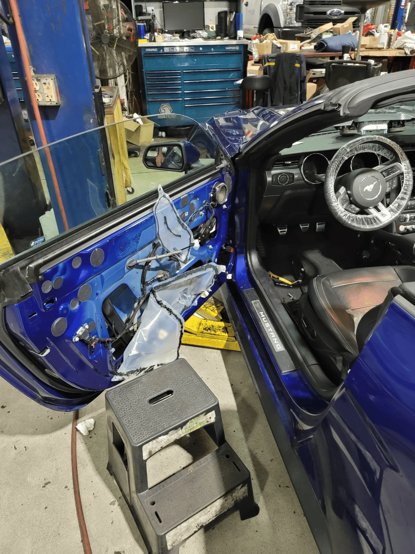

Car is still at the shop. I had to get some things out of the trunk, as I won't have it for my road trip to Orlando and Sarasota this week and will be putting the miles on a rental Malibu....
Below are pics taken of the door panel apart and the touch screen and APIM removed. I have been having a SiriusXM issue since day one and dealer scratched the screen. When replacing the screen, they accidentally put in a 2019/20 APIM that was supposed to go into someone else's Lincoln. Got the car back with all Sirius/XM saying Not Available, thinking it was an F-150, no climate control, Ford logo on startup/shutdown instead of Mustang and it now had Navigiation.
