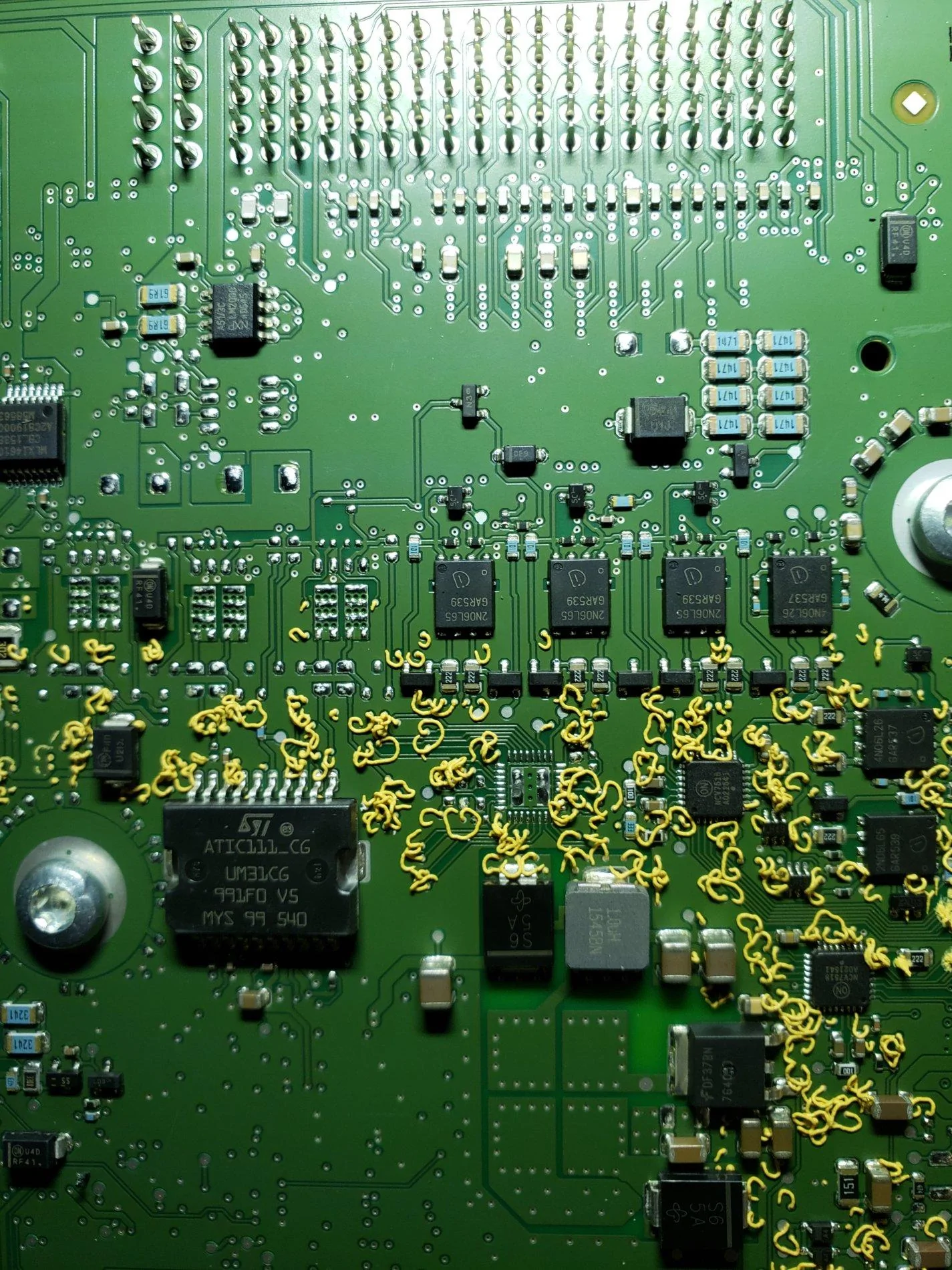

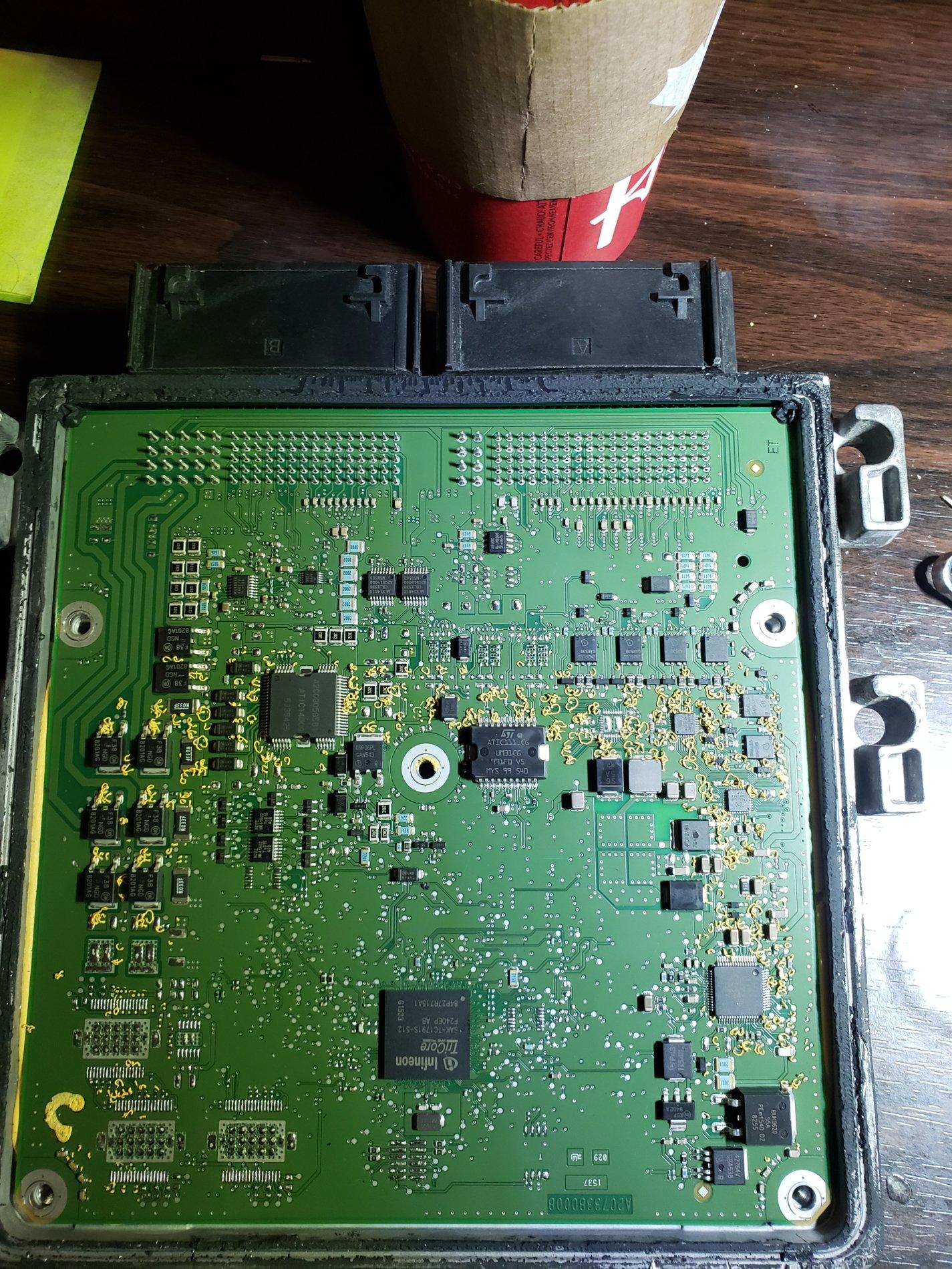

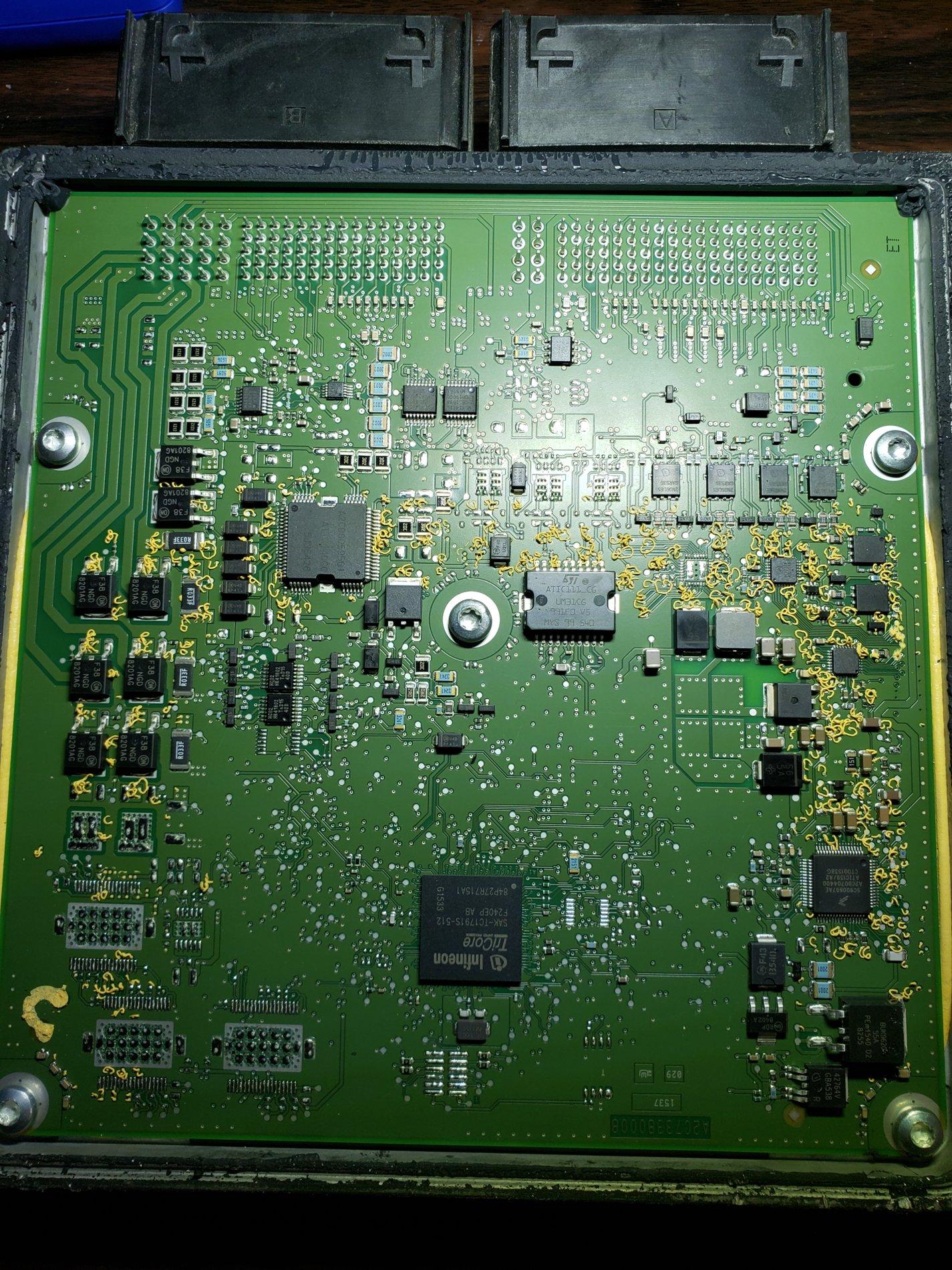

Hii guys , this is my ecu for my mustang GT . It was damaged in the accident . Does anybody see any damages?

What or who has deemed it damaged?
Did air bags deploy?
From your pics, I don’t see any visible signs of damages (cracks in board, burned components, etc).

The car is a salvage car , almost all the airbags were deployed. The car was hit from the passenger side (where the ecu is) but the ecu has no visible damage outside or inside.

The first pic, bottom right, the IC second from the bottom has a hole in the middle of it, 7640*0
There are similar indentation on some other resistors tooo so i think that's normal

It may not be physically damaged, but instead a fried chip, or bits wiped. But most likely since you opened it, a trace or solder cracked.
Hold it up to a backlight to see traces better.

There is literally no damage on the motherboard

Who squirted all that yellow silly string in there?
(couldn't resist...)
How can you see a short? There doesn't have to be anything physically wrong with the card, for it not to work, or be broken. Was the point I was making. Also, did you shine a light behind it and look for microcracks, etc..
