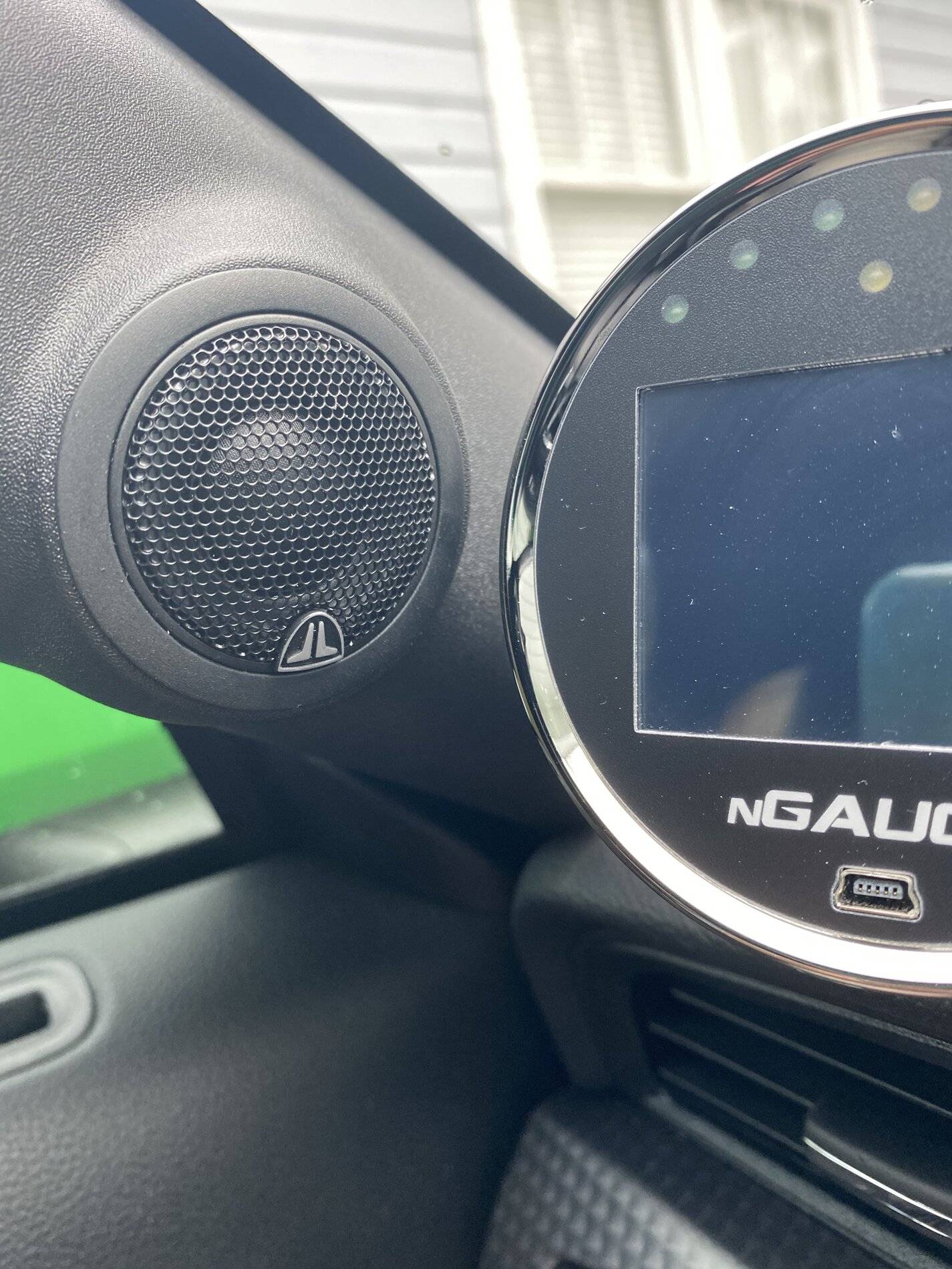

I just did JL's and they needed modifying. Look good, but modified...

Just so you have a data point, here is what the JL looks like

Those JL’s look good gadgtfreek! I’m sure they sound pretty good as well. Are they press fit in the A-pillars or glued In place?

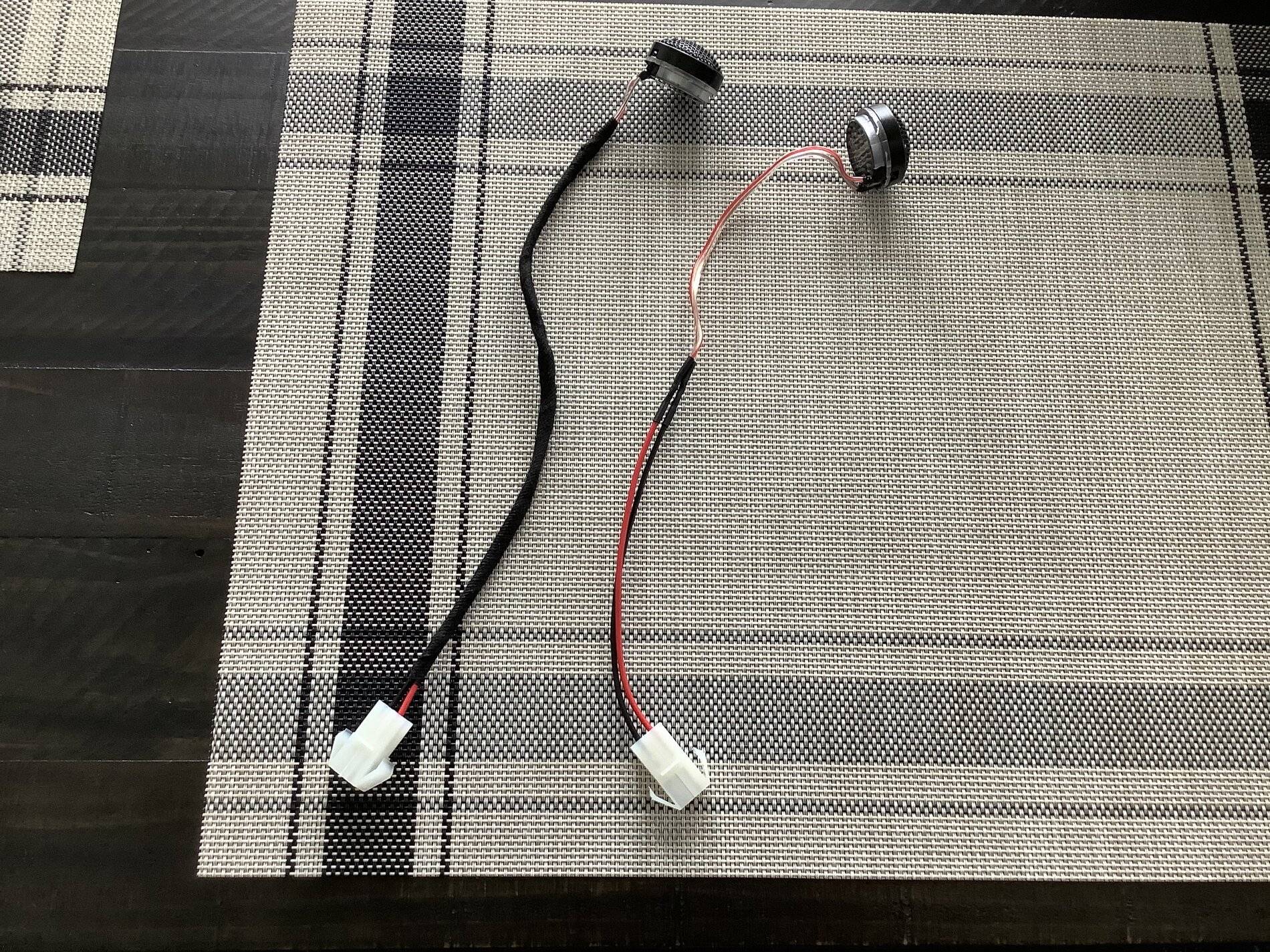

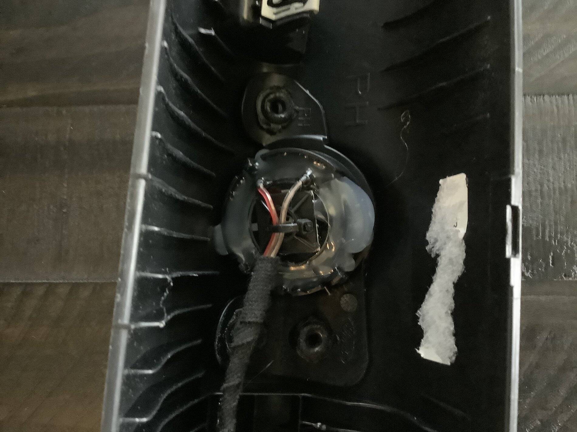

Here is what the Hertz MP25.3 tweeters look like installed. You have to pop the grille, remove the crap behind the tweeter and Dremel the opening just a little until it fits nice and tight. No glue unless you Dremel too much off. The lip on the Hertz is small so take your time and check fit constantly as you go. I removed the connectors from the factory tweeters and epoxied and wired them to the back of the Hertz. Made it plug and play and I can pull my tweeters out without removing the A plillars which are a complete PITA to re-install.
The shadows make it look a tiny bit offset, but they are perfectly centered and I absolutely love how it turned out and how they sound.
