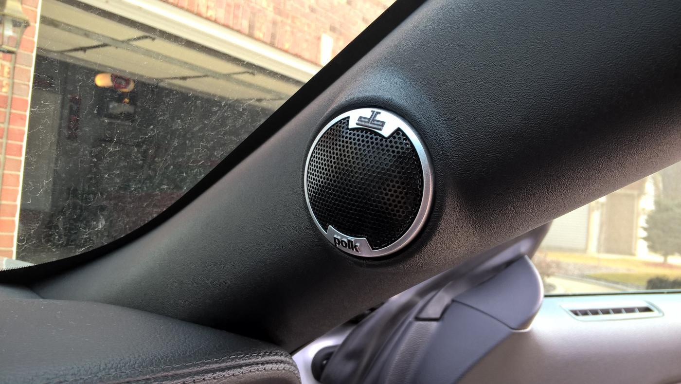

How did you fit the aftermarket tweeter into the Pilar? I looked through the forum but didn't find a how to guide. Help please! Im using the Polk Db6501
I personally just used some black silicone as an adhesive. They've been holding up strong, can't really see the bead. I just held the tweeters in place while the silicone cured with some tape, took about 12 hrs to get a strong hold. If you need to remove them for some reason, just use a knife and cut the bead.
Some tweeters I have seen have a screw hole in the magnet, get a matching screw and use steel "strap" (thicker one) to use as bracket. Not sure if the magnet on the tweeter could hold it in place rather than a screw, probably not strong enough. Could use an adhesive between the steel strapping bracket and the tweeter magnet...
You wouldn't happen to be sirBoom from diymobileaudio would you? ;)I have installed tweeters using automotive and even regular old craft hot glue from the back for years and of course drillout out the hole to the appropriate size... not a single one has ever threatened to come off.
Do they sound much better than stock ? I can barely hear the stock ones. Also did you just reuse the factory wiring to the new tweeter ?I dremel'd out the hole and used the surface mount cup that came with the tweeters. I used a hot glue gun to fasten the surface mount cup to the back of the A-pillar. The tweeter then pops in from the front. You have to also dremel out the factory tweeter mounting plastic in the rear of the A-pillar.
I'd like to know about the wiring aswell. I was thinking about getting the hertz HSK 165 and wanted to know if we can reuse the factory wiring and attach the supplied cross over.I dremel'd out the hole and used the surface mount cup that came with the tweeters. I used a hot glue gun to fasten the surface mount cup to the back of the A-pillar. The tweeter then pops in from the front. You have to also dremel out the factory tweeter mounting plastic in the rear of the A-pillar.
