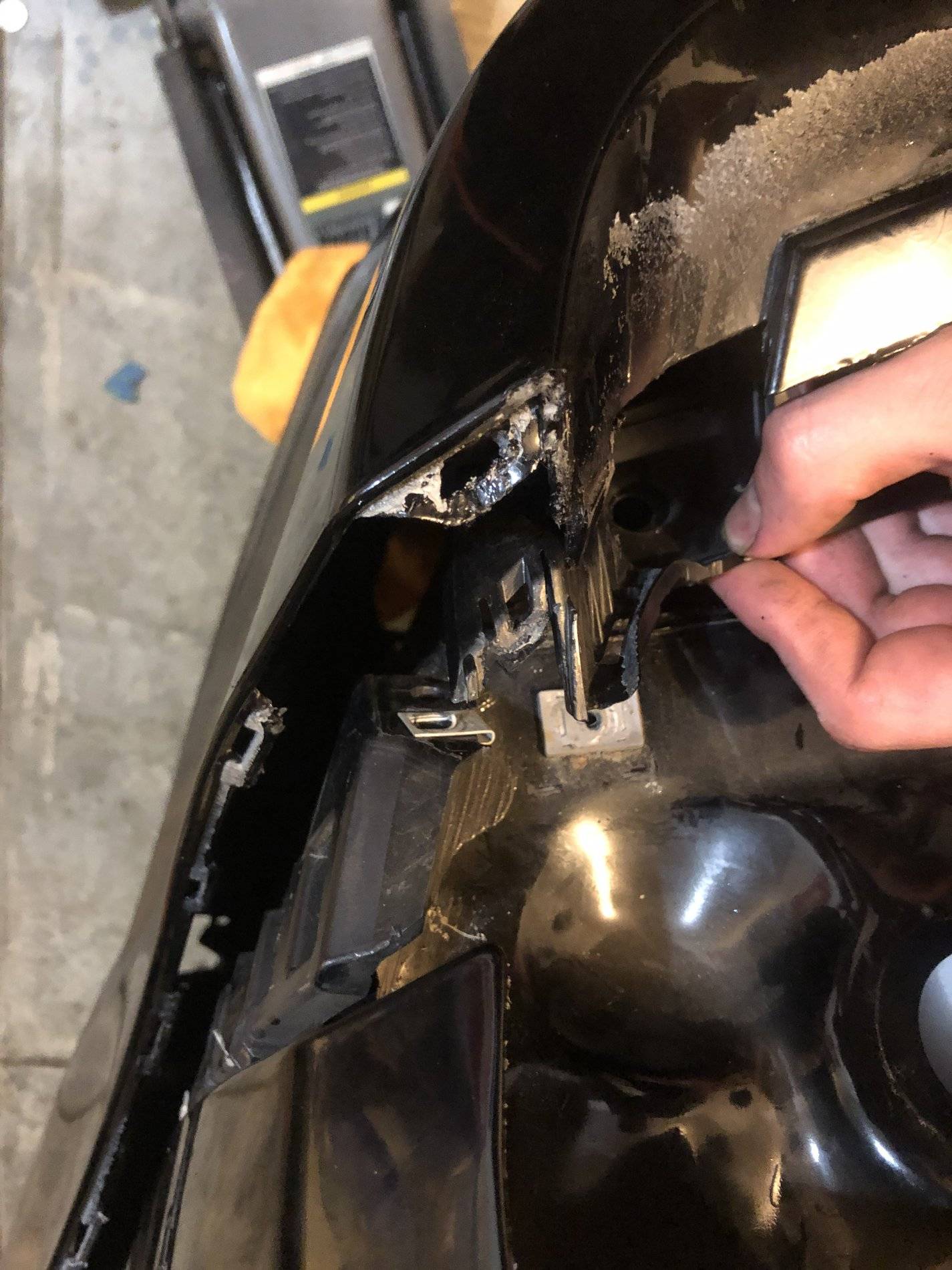

Has anyone been successful in getting the top corner on both sides back into the clip? Spent a little time on it and still no luck

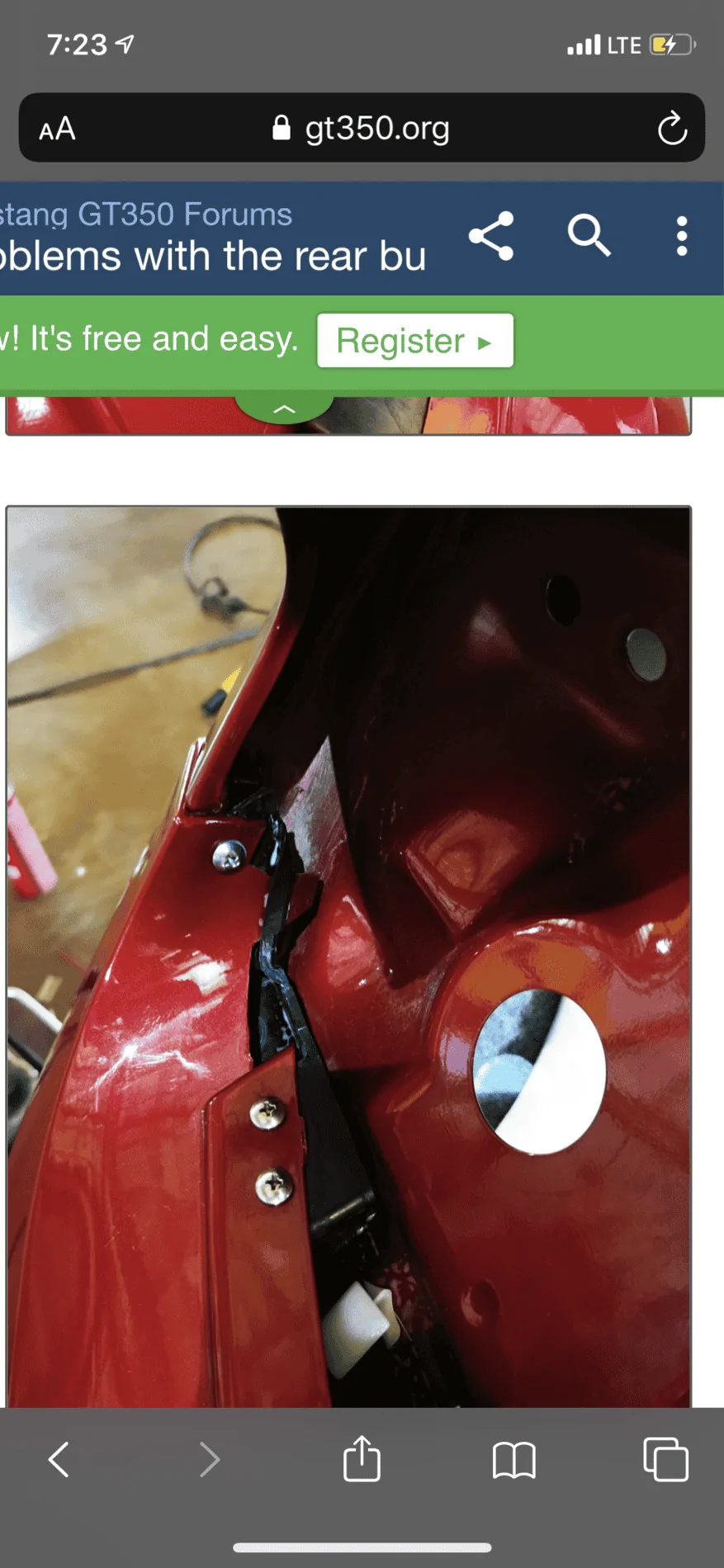

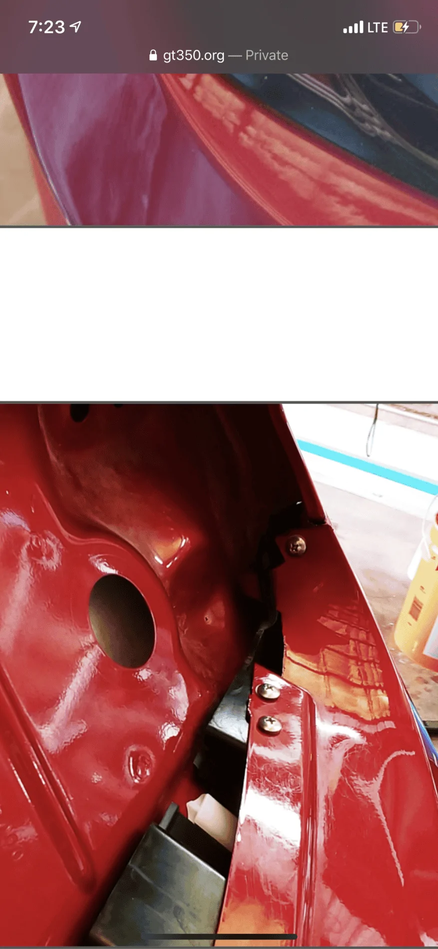

Ya it’s kind of a crappy situation. You can either do the TSB and cut the tabs and put a rivet in or ive browsed a couple more forums and found these pictures. At that point when screwing it you now have to worry about the weight of the bumper pulling away from the screw and failing
Oh, I like that... along with maybe a dab or 2 of RTV on the problematic tabs. Thanks for that.
