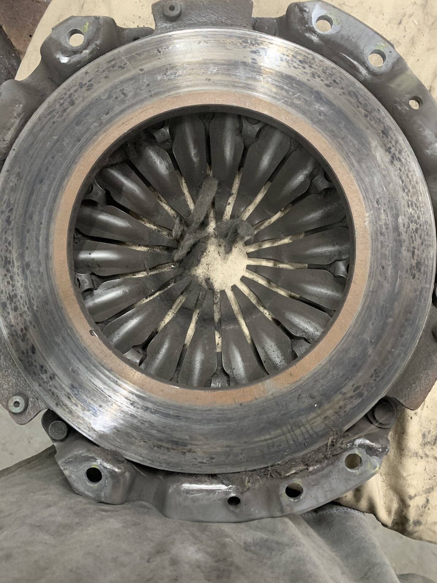

2015 add me to the clutch problems
NoVaGT
Sep 29, 2016
115
5,621
4,377
Northern Virginia
2019 PP1 GT Kona
Smoked. You need a heavier duty clutch.
rileythemustangguy
Oct 13, 2020
54
41
Seattle, WA
Riley
2017 GT Premium PP
Holy hell that's SUPER SMOKED. You doing burnouts with your clutch rather than your tires?
IamCDNJosh
Apr 19, 2020
237
260
Lake Oswego, OR
Josh
2015 Mustang GT PP, 2015 F150 3.5EB FX4

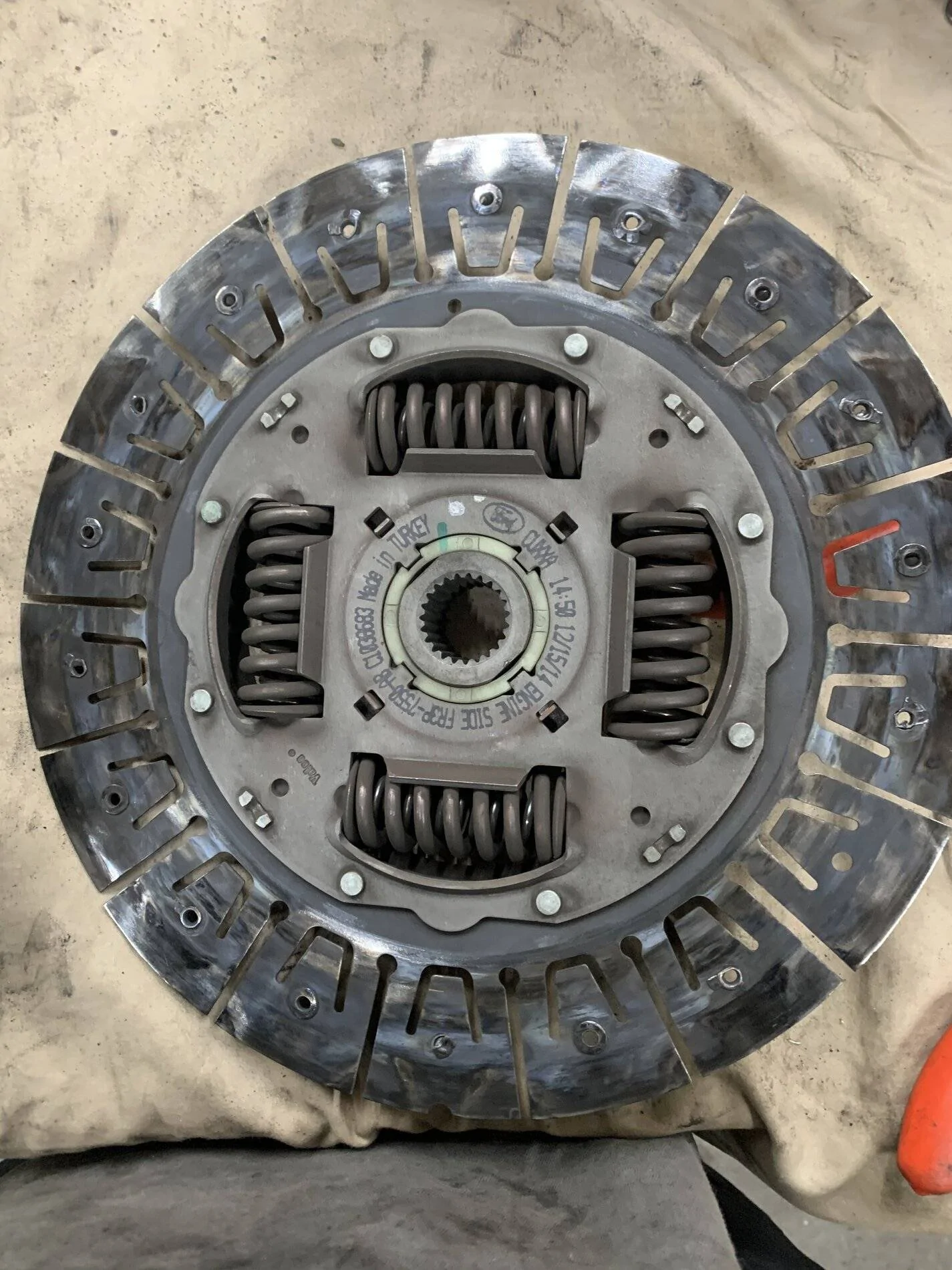

So there's literally no material left on that clutch disk. How many miles? What kind of power are you outputting and how is the car used?

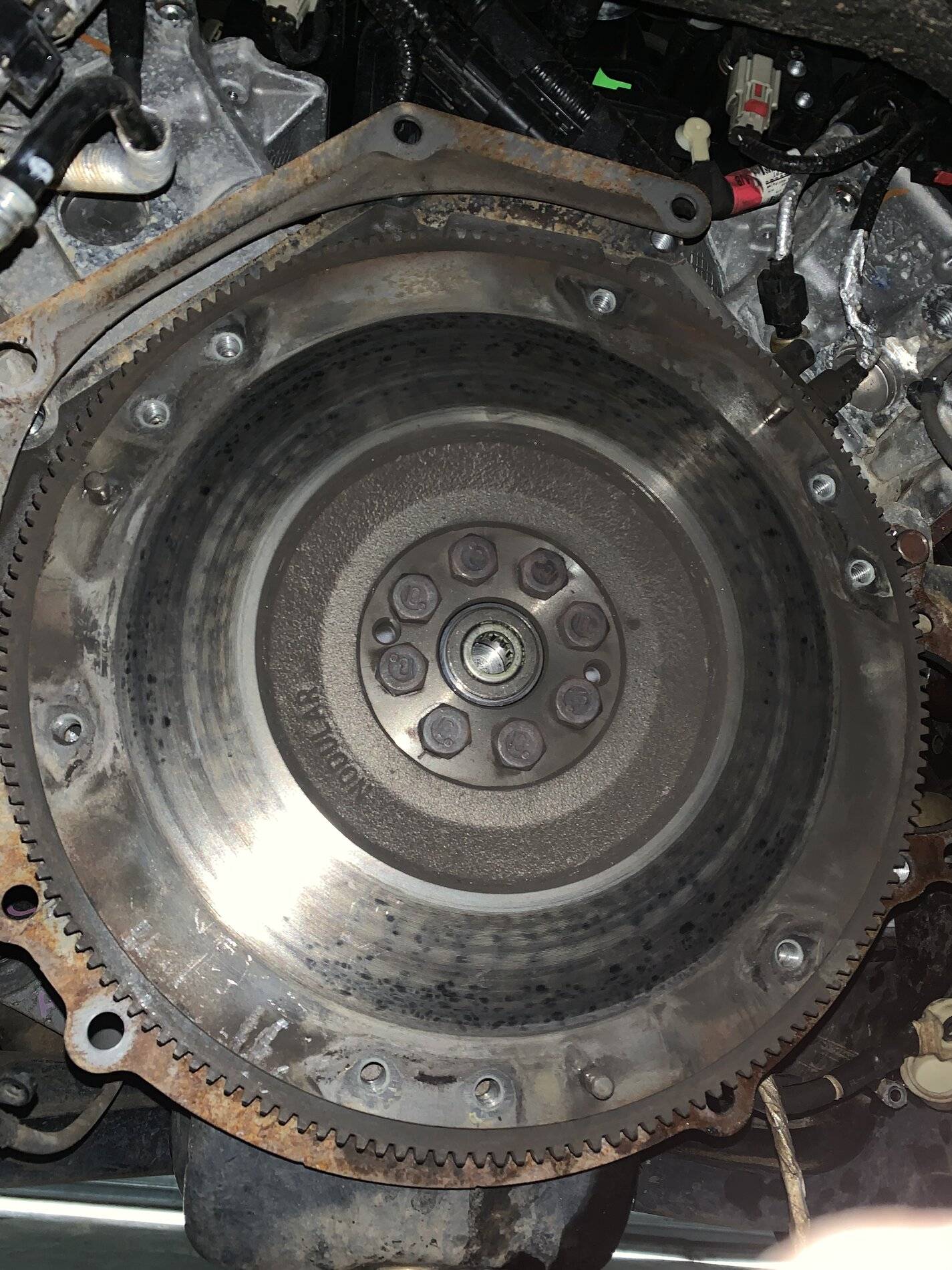

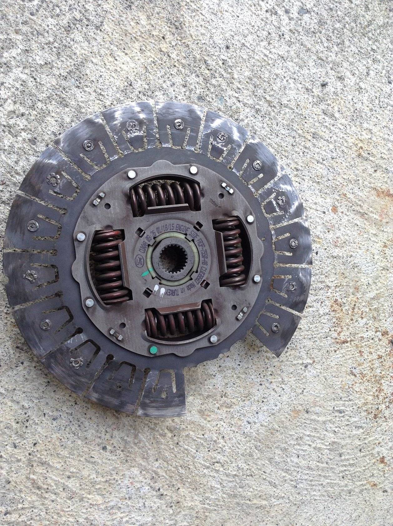

It is not a wear issue. This happens on a high RPM shift, 7000+ with the shitty Ford OEM clutch. As soon as you push in the clutch and the friction disc is floating, the centrifugal force pulls all the material off. Quite common. Mine was bone stock 2015 with around 14000 miles on it.
Absolutely no clutch abuse, just a bad quality part (made in Turkey).

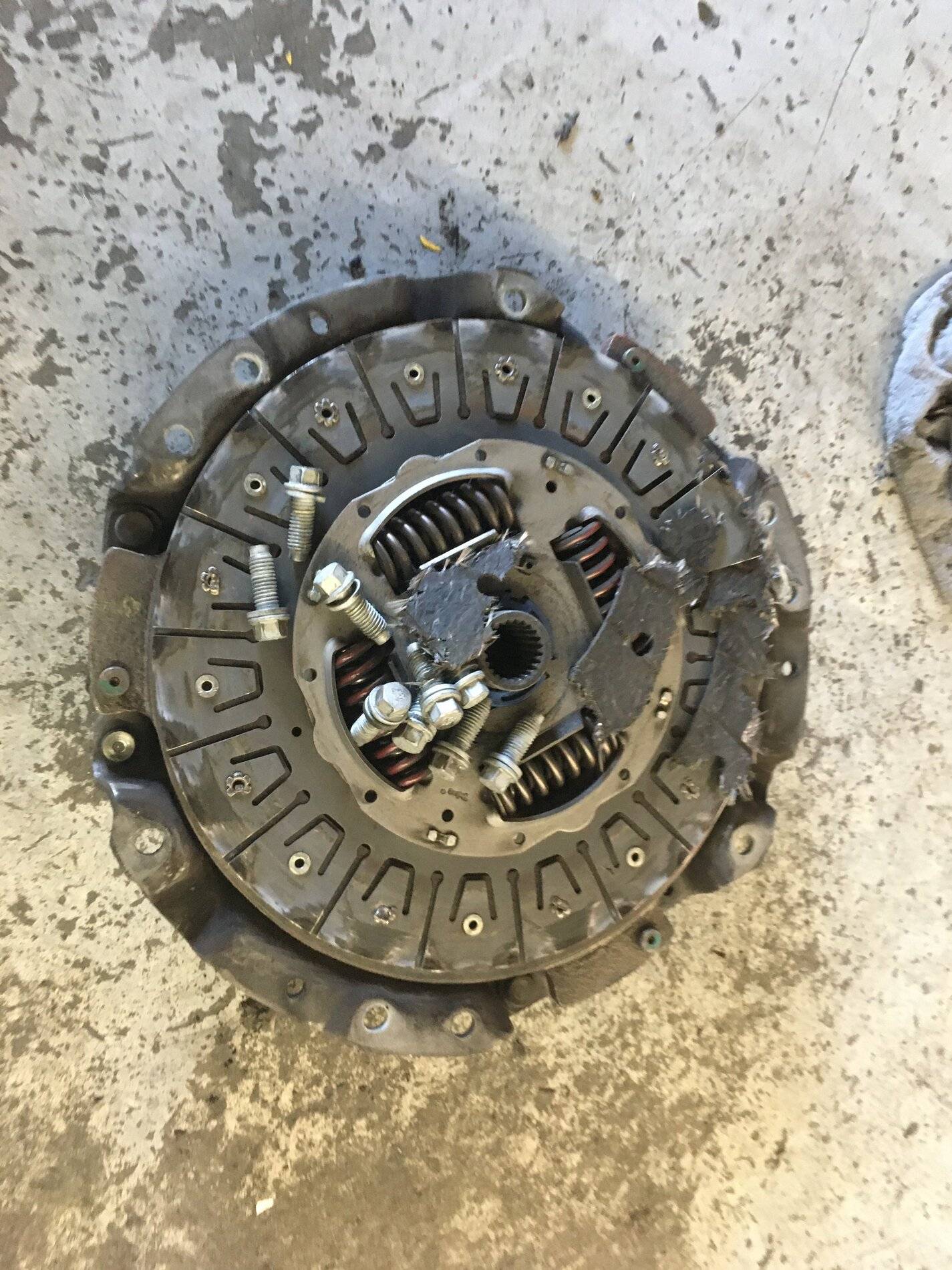

Yep, lost my clutch yesterday at Laguna. Second time. First time was exactly 1 year ago, also at Laguna
high rpm’s shifting
Ford paid for last one but this time I’m going to have to foot the bill if I want a better clutch

So common, mine looks so similar.
Man, what the hell happened? There's absolutely ZERO friction material there, since you can see the rivets, and it's just metal... and thin one at that, and only attached at 2 points per 'piece'. Looks so shitty. Is this the new D4 clutch, or the previous one? At any rate, the friction material is flying off due to centrifugal forces at 7K+ rpm??? That's hard to believe. Geez. Hopefully my D4 clutch is better than that. Is that the case gang? Thx.

D4 clutch is twin organic disc and much beefier.
