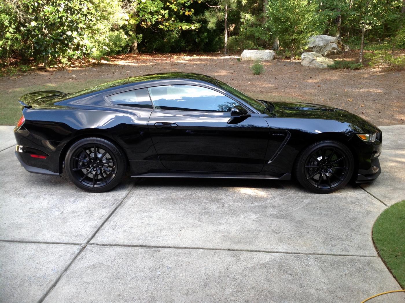

Congrats on the deal
Thx .....I'm glad to be back in the saddle again. I really missed the feel of the 350 over the past 3 months .
Congratz Mike, she's looking cooled...see what i did there. :)
So looks like she's stripeless. Glad you got out of that mess.
I'm so tempted to do the same, i just hate thinking how much $$$$ i'll be losing
in the trade.
