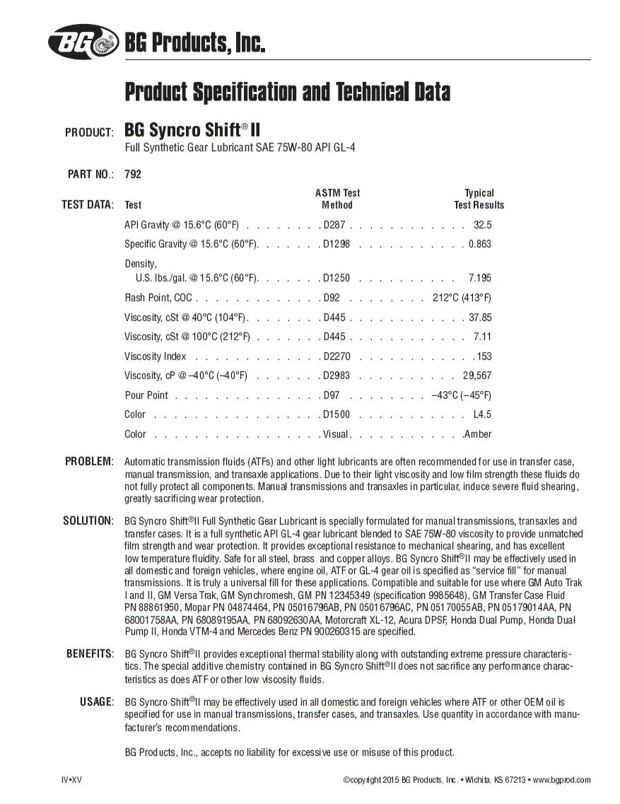

This is an from the BG Fluid Guide:
"The BG Fluid Service Guide covers manual transmissions, transfer cases, transaxle and front and rear differential applications. For these applications, BG does not recommend automatic transmission fluid (ATF) and the Lifetime BG Protection Plan does not cover the use of ATF."
Warranty: Simple has to be proven to cause failure. Everytime this subject comes up with my BG Rep he laughs. His biggest accounts in Florida are OEM Dealers. In New England, Tasca, Sentry Ford Stores all use it in their Service Depts. Sentry doesn't even stock Ford Product for service use. I know this because they wanted to but BG in my Mustang when it was new and I made them order the Factory Fluids in. This is why I started looking into BG.
If you ever had a transmission failure and they sampled the fluid it would just come back as really good fluid.
ATF does not belong in a manual transmission. Ford uses it because it is cheap, LV so when cold it flows prevents hard shifting. It's rendered useless once hot, offers little shear protection, and once it gets overheated all the properties (additives) offer zero protection.
If you look at the attached spec sheet for the Factory Ford LV ATF you will see and can compare the specs. The real advantage the ATF has is viscosity at -40C/F because I'm sure all you guys overheating the transmissions will be out driving Shelby's in those tempertures without allowing the car to warm up :lol: The additive package in Syncro Shift II typically (95%) will improve both cold and hot shifting. It has been proven hundreds of times to eliminate gear nibble in the other Mustang transmissions. The Tremec shifts much better but still has issues with 1st gear in some cases so it can also imrove that.
BG Syncro Shift II, to quote the attached picture and PDF: "BG Syncro Shift®II may be effectively used in all domestic and foreign vehicles where ATF or other OEM oil is specified for use in manual transmissions, transfer cases, and transaxles. Use quantity in accordance with manufacturer’s recommendations"
When I sent a sample of new BG Syncro Shift to the lab for analysis it actually tested at 7.3@100C vs. 7.11 which is BG's average. What this means is at higher temps it gives you a slightly higher window of protection before the viscosity drops vs. temperature compared with Ford LV ATF which is only a 6. So when you overheat ATF it's viscosity drops to low levels long before BG does. SAE Testing uses 100C/212F to base it's standards so it is hard to find exact trends at 300F but basically viscosity starts dropping like a rock. If we use data from a well known Company who tested 75W-90 (Rear Axle Lube)oil for a comparison (Because I have these numbers) at 100C(212F) it's viscosity is about 15-16. At 148.9C(300F) the viscosity drops to 6-7.
The viscosity specs are only part of the equation, additive packages play a larger role today than in the past. Running a fluid designed for use in a manual transmission that has Syncro's, roller bearings, needle bearings, straight cut gears and gears sliding on shafts vs. a fluid that was designed for wet clutches and passing through very small hydraulic passages and blended for that purpose you can understand why ATF is not ideal in manuals especially with the shaft speeds and power being put into it on the GT350.
So to answer your question, NO, it will not void your warranty, if a Dealer were to try to go there, assuming they do not use BG products (you would be surprised how many do) it would get squashed fairly quickly due to an extremely close relationship Ford Service has with BG.
I can say if you have ever reached limp mode you should be changing the fluid out because it is compromised.
