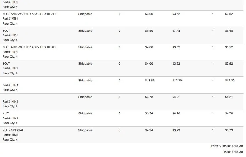

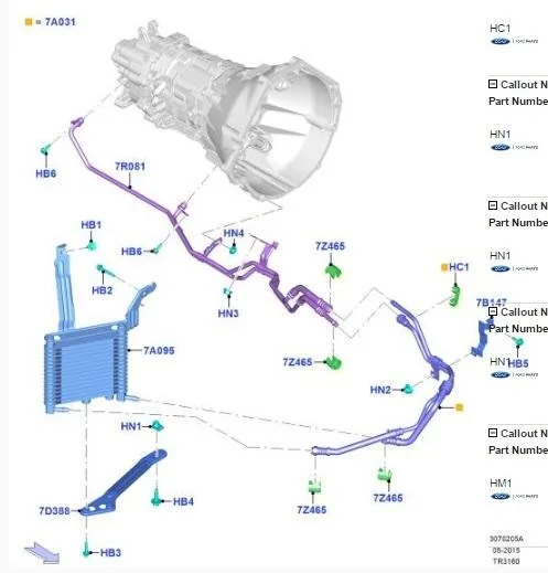

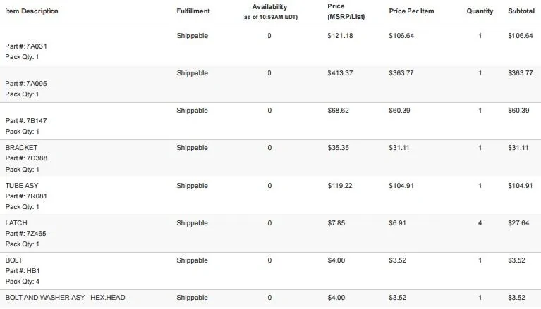

This from Fords website all the lines, clips nuts and bolts and cooler for an R model vin with anybody street price. Let me know who wants to order it and I will get firm pricing. The FP solution is a better deal but I do not find out until Monday if the cooler is even a good number yet or when it will ship. I have had pricing on the transmission for about a month.
