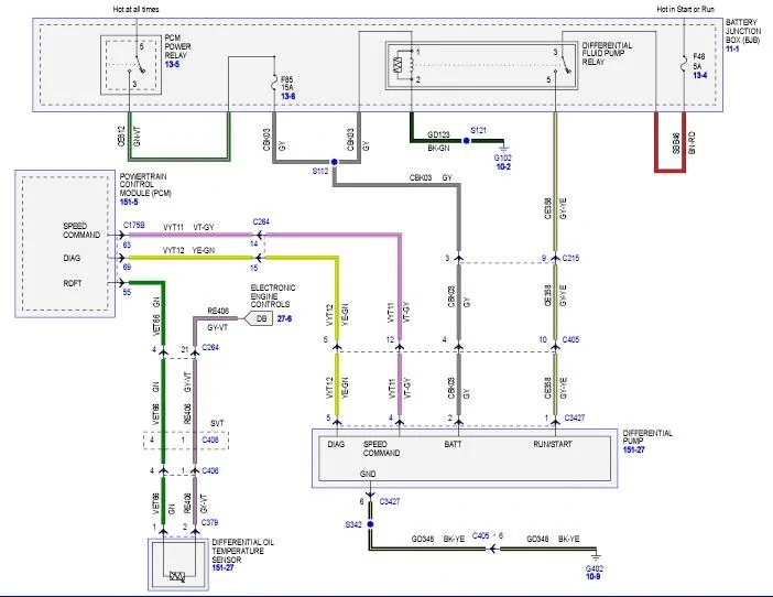

Actually it's the PCM only, I just had to look at my notes. You could buy the parts and make it work but to integrate it into the existing car (as I assume FP would be expected to) would be complicated. The wiring is not there, there is some question as to why the Tech Pack cars already have the relay for the diff pump yet have no wiring. I have not had my hands on one to see how the tech pack cars are built and verify the Ford wiring to understand fully the differences. You could just power the the pump with a power source.
Thanks again Tommy, if you were in New England, my Tech would be there this weekend:lol:
It might be helpful for a '17 or 16 Track pack to share anything they might have regarding the wiring.. Anyone interested??
I very much appreciate the diagram and your consideration of this problem :cheers:
