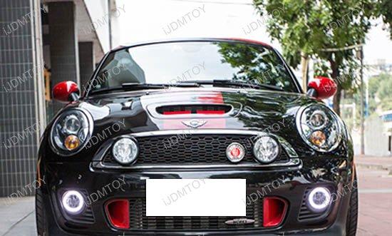

Without opening the lights, no chance to have them looking nice enough. Glued in front of the light will look weird and the wires will be really visible ...I am not sure about that... What they say on the product description is "The unique design of this fog light halo ring makes it water proof and it simply adheres to the lens of your existing fog light. You won't need to open the fog light assembly up to install this halo kit".
The (contradicting) info that you need to open up the fog light maybe a carry-over information that came from copying-pasting the description of the LED Headlight Halo Kit by Oracle (see link: http://store.newlevelmotorsports.com/or6.html).
I sent them an email about that and will let you know when they reply.

Those angel eyes fog lights that I found on Aliexpress for $86,7 seem a good alternative:
https://www.aliexpress.com/item/LED...2773321694.html?spm=2114.40010708.4.15.6Enkuq
