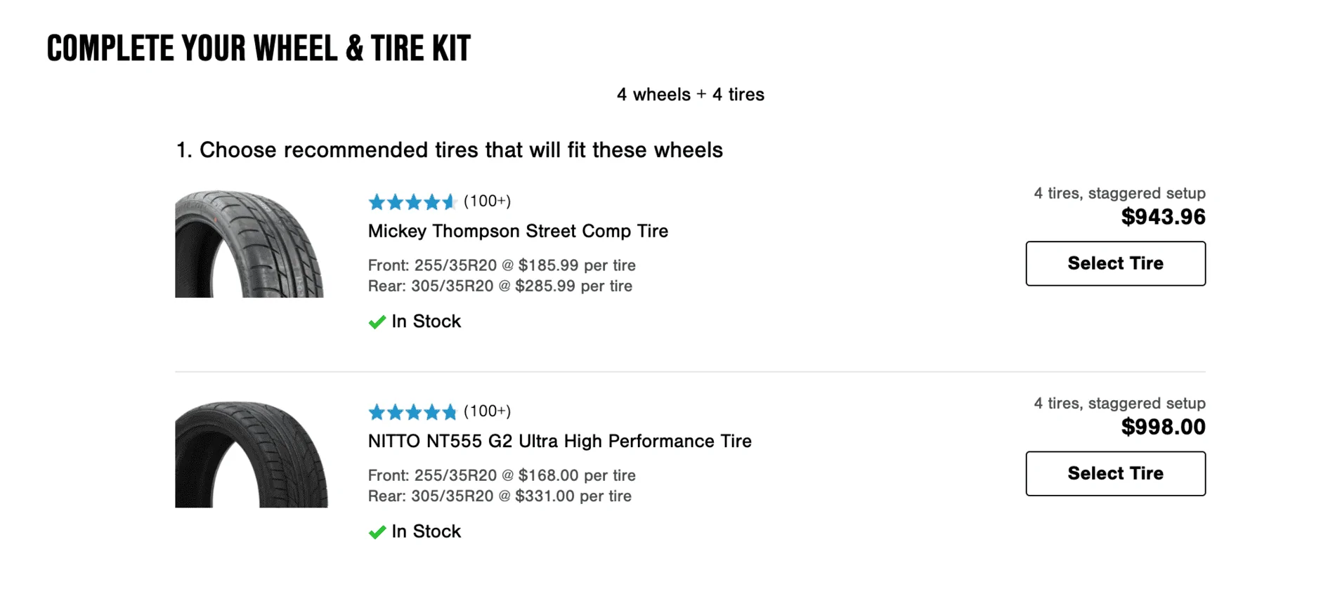

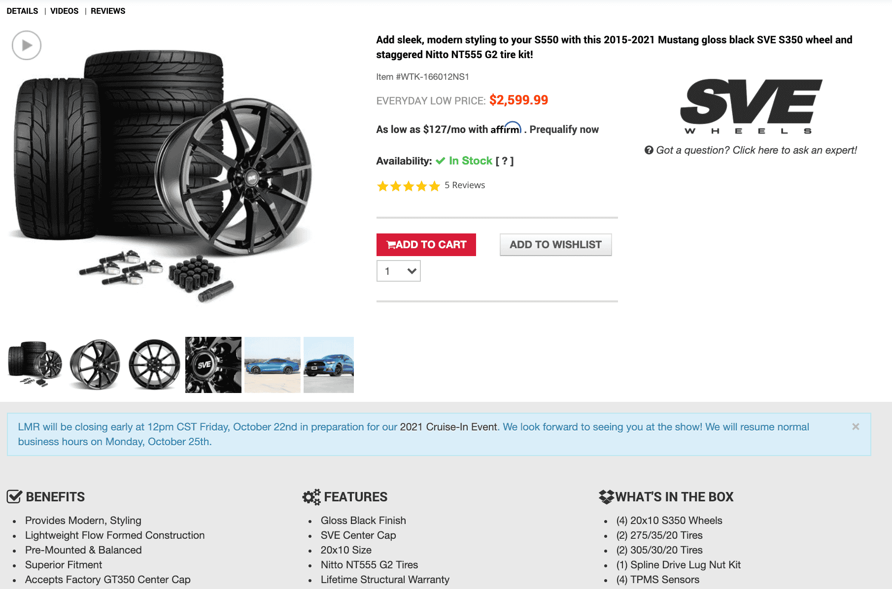

After talking to reps from both LMR and AM, they both advised to install 305/35r20 on 20x10" rears with either 255/40r19 on 19x8.5" front wheels or 275/35r19 on 10" front wheels. Here is a link to a video AM sent me and some screen shots of their recommendations. One forum member messaged me and let me know that most people here are very performance based, while most people that buy parts from AM or LMR are doing so mostly for looks. I can understand that... and I am definitely doing it for the looks. I just don't want it to be dangerous to drive.

Is there any potential problem with having rear tires 1.15" taller than factory and 1.4" taller than the front tires?
I'm surprised LMR didn't recommend 20x11 rears to go with 19x10 fronts. Why "stagger" the tire width but not the wheel width?
The big difference in diameter between rear and front will give you a raked look and fill wheel gap in back but not in front.

Thanks for the info. I had a look and it doesn’t look like MRR or Apex carry any wheels in 20” diameter. I’d really like to stick with 20” rears. The SVE S350 wheels don’t come any wider than 20x10” but they sell all their staggered wheel setups with 305s in the rear. Is running a 305 on 10” rear wheels acceptable? I’m wondering if the tire roll issue would still be a problem if I had 275s up front on 10” wheels?
285 fits a 10” well, 275 is fine too. Stretching the tire a little like a 275 on a 10” or 295 on an 11 isn’t a bad thing at all.
