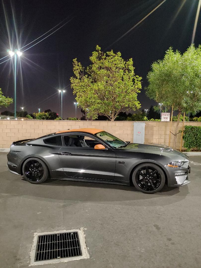

First off your car looks awesome. Love the orange roof and mirror caps.

Thanks man! Just had those wrapped 2 weeks ago. Im digging it.
